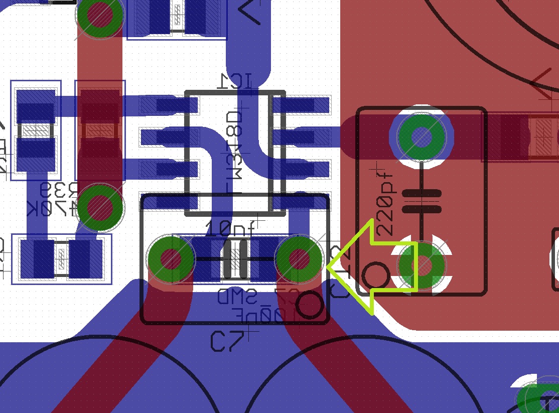

So after all the gyrations and hand-wringing and component pulling, the best solution is what most technical people recommend: a simple ceramic cap directly across the power pins. Who would expect that a ten cent part performs better than a one dollar (or, in ridiculous cases, a hundred dollar) part? I would, for one. Simply throwing gobs of money at a circuit is not always the best way to improve its performance. But sometimes it is (C13)!
Good job, as usual, Dario. Does that finally resolve this issue? Ceramic caps are very good at power supply bypass, with no need for exotic stuff. Try soldering them directly across the pins, if that's possible. I don't have the PCB in front of me, but I've done the same on lots of other chips and it's a very simple task if you're careful of heating time. I might try it on my amps.
What value did you use? Recommended is usually 100nF, just as shown on the original schematic.
Hi Tom,
It's nice to read you again. 🙂
My answer at the moment is: maybe.
If in the next days I won't find any fault that in this moment I'm overlooking it will be my definitive choice for C7.
BTW sometimes there's simply no better bypass than an otherwise awful ceramic, I've had the same experience with the MINI2496 DAC.
Thanks Tom 🙂
I really hope so... I'm bored to swap caps in C7... 😀
Sure it would be possible but in the FE layout they're already really close to the chip (see attachment).
It would be nice so you could confirm or not. 😉
I've used a 100nF X7R ceramic (probably is an AVX)

I wonder if the "toing and froing" with the rail to rail decoupling has been complicated by the omission of rail to power ground decoupling?
The rail to rail decoupling must be very short.
The rail to power ground decoupling must also be very short. The two caps must be connected together with the very shortest link. That junction becomes the Power Ground. The best caps for this decoupling are ceramics. and no they do not need to be C0G/NP0, XR & XY caps can do the job better due to slightly higher esr.
Hi Andrew,
I actually think the contrary since the presence of the rail to ground decoupling would have added those caps coloration to the equation.
The rail to rail decoupling must be very short. The two caps must be connected together with the very shortest link. That junction becomes the power Ground.
I'm missing something, Andrew... Which two caps?
In rail to rail there is just one cap...we're talking about C7, right?
I was just thinking to try also C0G/NP0 caps.
Thanks Andrew, a precious info. 🙂
Snake oil or just uniformed spouting?
None of the above...
From what I know (and I heard) in signal filtering applications a good film cap is usually more linear (and sound much better) than a X7R ceramic.
C0G/NP0s are much better for the linearity problem but sometimes can sound a bit harsh and less detailed.
I have edited my post.
Thanks, now it's more clear.
So, if I understood correctly you're saying that also the rail to ground caps should be ceramics?
Describing a ceramic as awful is wrong.
Just accept that for some uses thge ceramic cannot be bettered.
Just as other caps are the best choice for some duty/ies
The HF decoupling must be able to pass very high frequencies. The MF decoupling must be able to pass the lower frequencies below those handled by the HF decoupling.............. if I understood correctly you're saying that also the rail to ground caps should be ceramics?
The LF decoupling must pass the audio frequencies.
Each set of decoupling must have the caps chosen to suit the duty.
Who makes the caps or how much they charge for the caps or how many adverts one sees for the caps has no bearing on the duty that the cap suits. The specification rules, not the name on the label.
