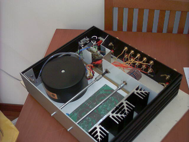

This is my Layout
Hello, this is my idea of a layout.
What do you think about?
Riccardo

Re: Re: This is my Layout
SmellOfPoo said:
What do you think about having the heatsink between transformer and pcb ? So the heatsink would be kinda shielding against the transformer.
Actually you get better shielding from the big caps than you do from the HS, unless its copper or ferrous. Maruo actually suggested pretty much as Riccardo has it laid out. 🙂 It is also the orientation I am using with very good success.
