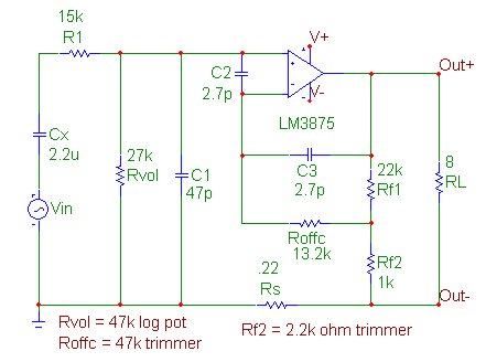

if with "Paulo" you was referring to me... :cannotbe: that's not what I was asking. 🙂
Let me try to explain better what and why... (sorry for the OT! 🙁 ).
As I have said in some other thread, I have already built a "toy" test chip amplifier, which is sort of NIGC (using LM3875) with (adjustable) current feedback net added. By means of a trimpot I can set its output impedance (see attached schematic).
This test amplifier have shown some quite interesting results when listening to it with different output impedance settings (I have already tried it with several different -and absolutely "normal"- multi-way loudspeakers, in different systems, rooms, etc).
Compared to a normal GC (or to itself with Zout set to the minimum), the most evident effect of a moderately high (8 ~ 16 ohm) Zout is a much improved sense of "dynamic", "velocity", "pace" and "rhythm"; in a word, the music seems to get more "life", if you can understand what I mean. 🙄
(other less pronounced effects are a feeling of better "smoothness" and a sense of "bigger" sound, including better imaging).
As far as I have tried up to now, each system (loudspeaker,cables,room,...) seems to show a (rather wide) "sweet spot", i.e. some Zout value which gives the best "musical" results (to date I have always found it to be in the range of about 4 to maybe 16 ohm or such, at least on speakers with a nominal impedance of 8 ohm).
Reducing Zout to increase the DF makes the sound "dull", "dead" :dead: (and usually also a bit "harsh" - same results as with a "true" GC), while further increasing the Zout does not bring further improvements to the sound quality. On the contrary (and quite obviously!), setting it too high usually results in screwing up the bass response (going to the maximum also make the sound a bit harsh again... but I guess that's because with my test amplifier this setting also imply a reduced amount of total NFB).
According to countless articles from various authors, you get the best sound quality when you achieve a nearly critical damping of the loudspeaker... of course, with today typical loudspeakers, varying the amplifier Zout you can easily achieve this result.
My easy guess is that, quite likely, the aforementioned perceived qualities (except probably for the harshness/smoothness) of the reproduced sound, or lack thereof, can be closely related to the total damping. 😎
BTW, even with the "best" possible setting, my toy amplifier is still far from approaching the quality of my current reference (which is my tube amplifier). Compared to the reference, the music message appears to be somewhat "simplified", poorer; the image is worse, and overall the sound appares somehow "mechanical", less "natural".
OK, now let' go back to the point... :smash:
Judging from both a "theoretical" point of view as well as from the comments I've heard from people who have tried your design, I guess (and hope!!) that your "my_ref" should be way MUCH better than a trivial GC... (again, I'm really very curious to try it myself and compare to my tube amplifier!) and it definitely should do a much better job than my current "toy" test amplifier.
Yet I would be very curious to see how this varying DF "trick" behave using a much better design to start with, to understand whether it is really a general effect or it is only a trick limited to some (flawed?) design...
got the point? suggestions?

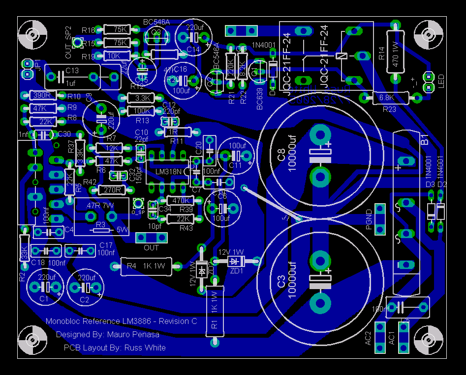

REV C monobloc PCB correction
I must apologize. The diagrams I had of the relay which I used to make the part in eagle were not marked as to which way they were drawn, from the top, or from the bottom. So I made the part as if it where drawn from the top. Well that bit me in the buns. It turns out now that I finally found a real datasheet that the diagram was actually drawn from the bottom, so I had the pins swapped.
I had to order the relay, I did not have any on hand so I could not check.
Now that I know it was wrong I have fixed it. Here is the corrected PCB.
If any of you etched the faulty version, it is simple to rig a fix, simply cut the OUT GND trace at the relay pin and run a jumper wire from the opposit pin to the faston pad for OUT GND.
Here is the fixed PCB. PDFs for copper and component to follow.

Hi all,
Other suggestions:
- The values of voltage and power of my BOM is always to consider as least values of departure. In any positions ( i.e. C4, C19 ) I have used a footprint more great to allow to use even cap with VL> 100V. They remember that in the cap a greater work voltage ( and a greater encumbrance ) is much often a guarantee of better quality.
- The cap that are connected to the output signal have to have a VL = or >100Vdc.
- R1, R4, R24, R27, R14 dissipate less of 1W but they heat much, for which be necessary use 2-3W, but does it main point is that are of great dimensions (+ dissipation) and they climb on as it says Brian ( lift from the card ).
- ZD1-ZD4 have it same problem: they have to be up by the card to heat of less.
R3 and R26 even. They remember that if fairies of the tests to full power, R3 and R26 are able arrive to temperatures superior to 100°C.
- The cap C9 , C24, C13, C29 have to be " audio grade ", but I seems that the select the Brian is good.
- The Output Relay is on the power GND for any reasons, but the principals are a layout more simple and a voltage swing (on the switches of the relay) the more reduced (-diaphony ) . from the point of view of the operation, not change much, given that the spks come "off" in any case ( no current, no sound ).
- LM318 is connected in "floating" because has not a direct reference to the GND. For this reason it reverses the input signal but the Zin is 100K. If inserts a Res among 2 and 6 pins, the operation changes and pin 2 becomes " virtual gnd ", and Zin = 3.3K// ( Res 2-6 ). Here an example of the difficulties of insertion of compensation nets; The floating connection is a lot of tender to the polarization nets...
Other precise statements: My_REF is a very "musical" circuit and for this has wanted share it with the forum. His performances have convinced me to not increase the complexity of the circuit, because not there are particular problems of operation. This circuit is not a " commercial-professional amp ", and I have not dimensioned the components to do from it an use "industrial". This circuit is not applicable to is second-hand as "Harmonizer" or in "continuos full power " as the amp from disco...
