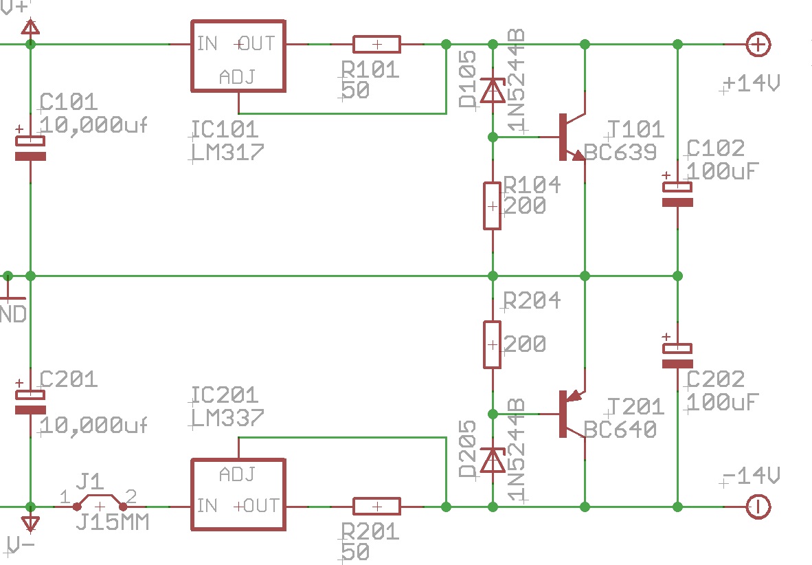

No, wrong schematic you should refer to this one:
attachment.php
Replace 1N5244B with 1N5242B (Mouser 1N5242B-TR).
For R101/R201 use a koa SPR1 (660-SPR1LT52R510J).
BC639 and 640 are better performing if the -16 version is selected (863-BC639-16ZL1G and 863-BC640-016G )

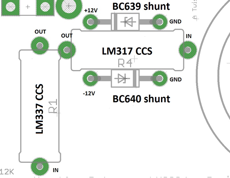

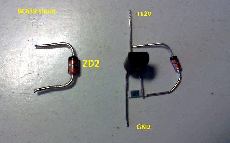

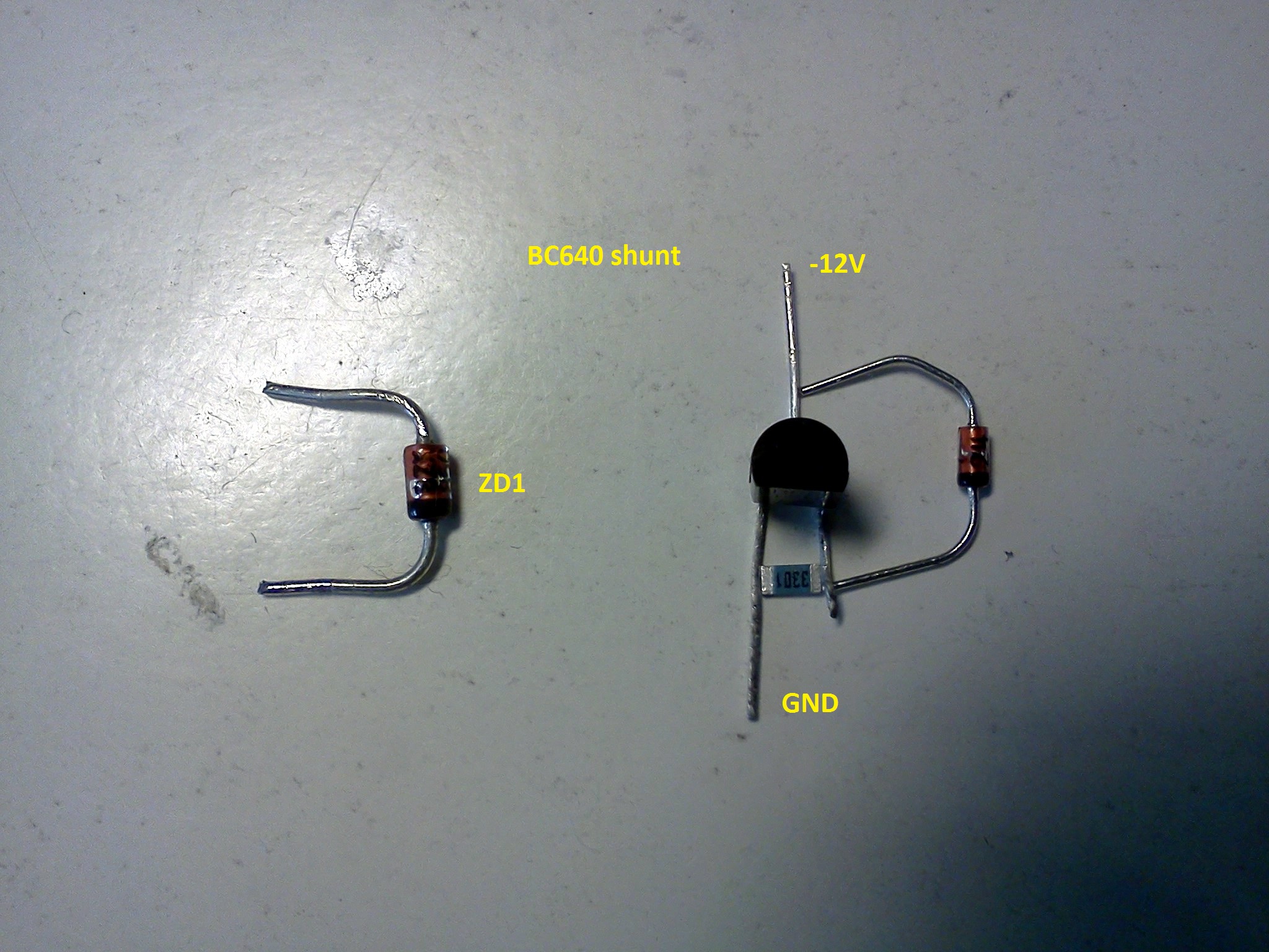

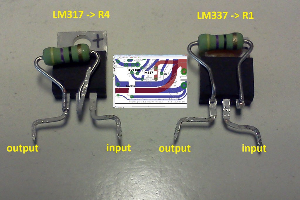

You can mount all on board, simply fit the CCSs (one reg and one resistor) in R1/R4 and transistor/zener/resistor in ZD1/ZD2.

I suggest you to start with CCSs and the actual zeners, if it works than proceed replacing zeners with shunts.
WARNING
I've did it on the fly, there may be errors, check before doing anything
The difference between the two schematics is just the divided and decoupled current source resistor, isn´t it?
What´s wrong with the extra decoupling?
Not that I´m an expert, but this mod is, for example, one of the "best of" mods for naim preamps naim 321 current source mod.
Is it personal preference? Apparently it also simulates better.
But again, I´m not an expert.
I think I will draw a little (30x30mm) PCB for diy-etching, that fits into the R1,R4 holes from above and incorporates the improved regulator.
It is and I think it's a bit risky (more later)

That mod (pi-filter) is very effective on resistors present on rails for ripple and noise but R101/R201 are not properly on rails... they're in the feedback loop of the LM3x7 used as a CCS...
I wouldn't put a shunt cap in that loop, it will interfere with CCS operation.
OK.
Not that I fully understand this, but I won´t use the shunt cap.

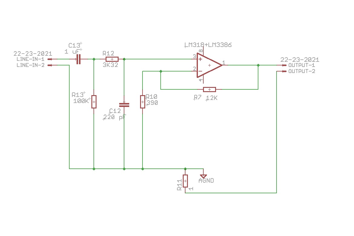

In fact, in My_Ref, LM318 and LM3386 (along with compensation networks) can be considered as a single power opamp:
attachment.php
So, by istinct, to me sounds wrong to have separate trasnformers (and grounds).
Which path will take current returns?
There will be ground loop problems?
I don't know...
Maybe AndrewT, who is more technical oriented, could help us understand.
