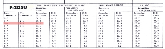

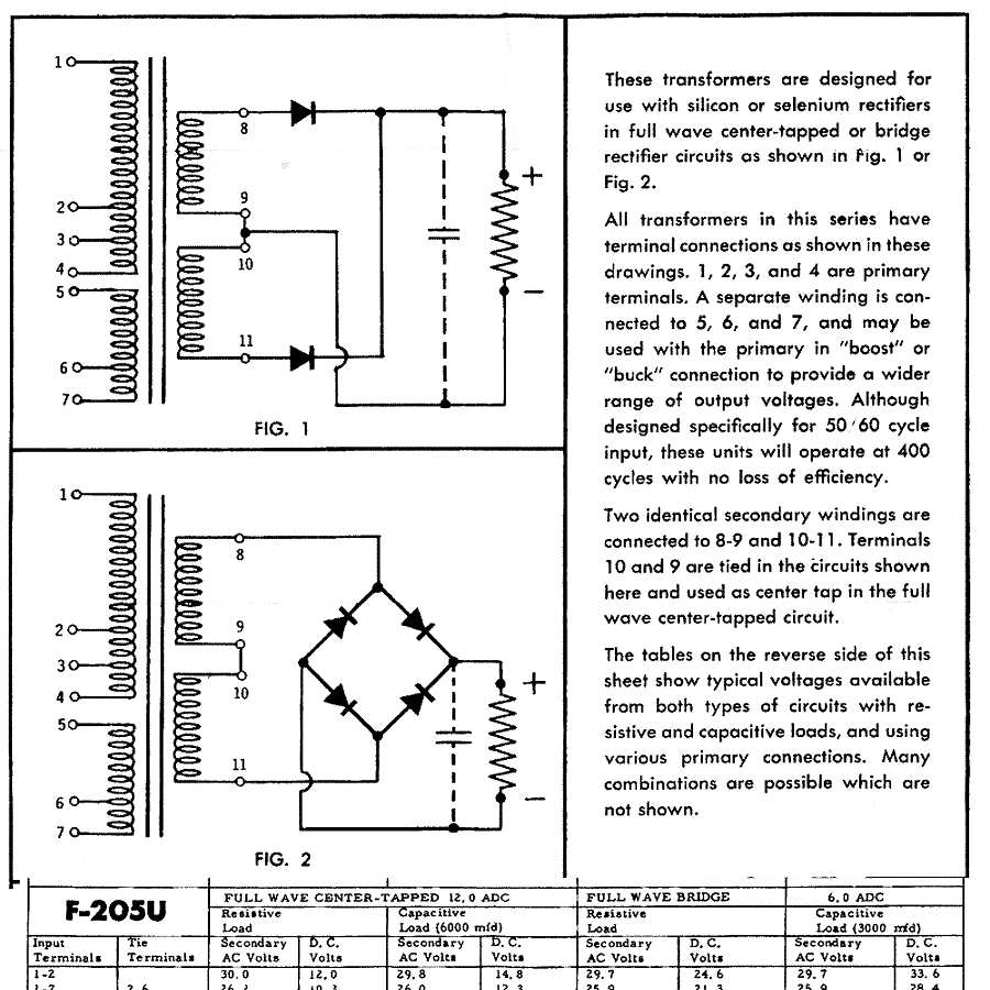

Well, I bought the 600VA 24V from Antek. I think it will serve me well for decades to come so the fact that it is overkill is not so bad. The inrush was something I had not considered so I bought some CL60 at 5amps. Hopefully this will do the trick. If not its another project. Cuz I dont have enough of those. DIY is sometimes a self inflicted wound that we peer at, pull the scab on and delight in the pain. Masochistic. But then again when it all works out its fantastic fun
So here is a pic of the pdf of the 240V trafo I have in the basement.
Uriah
Uriah
I thought the pic included that chart. It did in photoshop anyway.
I have to try these tonight, but right now I have the highlighted row configured on the trafo.
I tried a few others with a little jumper I made but I dont remember which ones they were, just that they came in as low voltages like 10-13VAC
I will try the jumper on a few more tonight.
Uriah

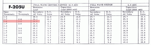

Uriah
Primaries across terminals 1 & 2 will give you your highest secondary voltage.
That is the highest output turns ratio..
Chart says it will do 30VDC but that is 15-0-15... Don't think the trafo will give you 30-0-30 unless your mains are 220VAC..
But you could make a hell of a multi-channel amp active system with that trafo.. +/- 15 for pre, active xo and LM3886/3875...
