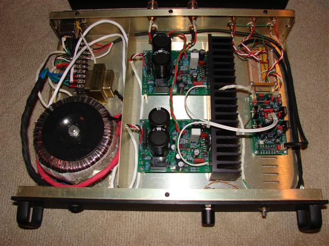

A pic of a finished unit.
Do you have a smallest photo ? 😀
Please, if you have a bigger photo, it will better to see something

Biggest I have on this PC. The originals are in storage on another PC.
And sorry I attached the first as a thumbnail not the actual photo.
It was the a relay input selector board, Kookaboro pre-amp, and Mauro "Rev-C" amp boards.
It worked REALLY well and I was sad to have to sell it. I hope to be able to replace it now.

Thank you but it was NOT finished. I still had some wire cleanup to do.
The white pwr wires were Silver plated Teflon insulated shielded triax cable, the signal wires from the Kook to the Rev-C were Silver plated Teflon insulated coax, and the input leads were just twisted pair Silver plated Teflon insulated.
Case was Par-metal Series 20.
Transformer was Anatec.. 400VA
Next time I will just make true compact mono-blocks. to be put next to the speakers.
