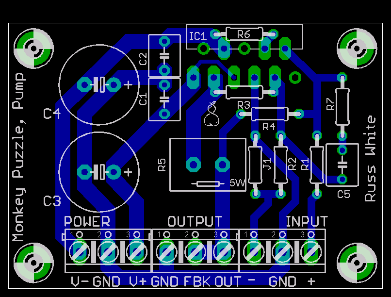

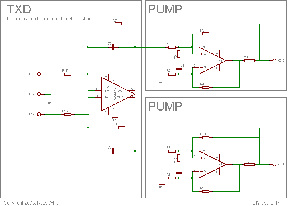

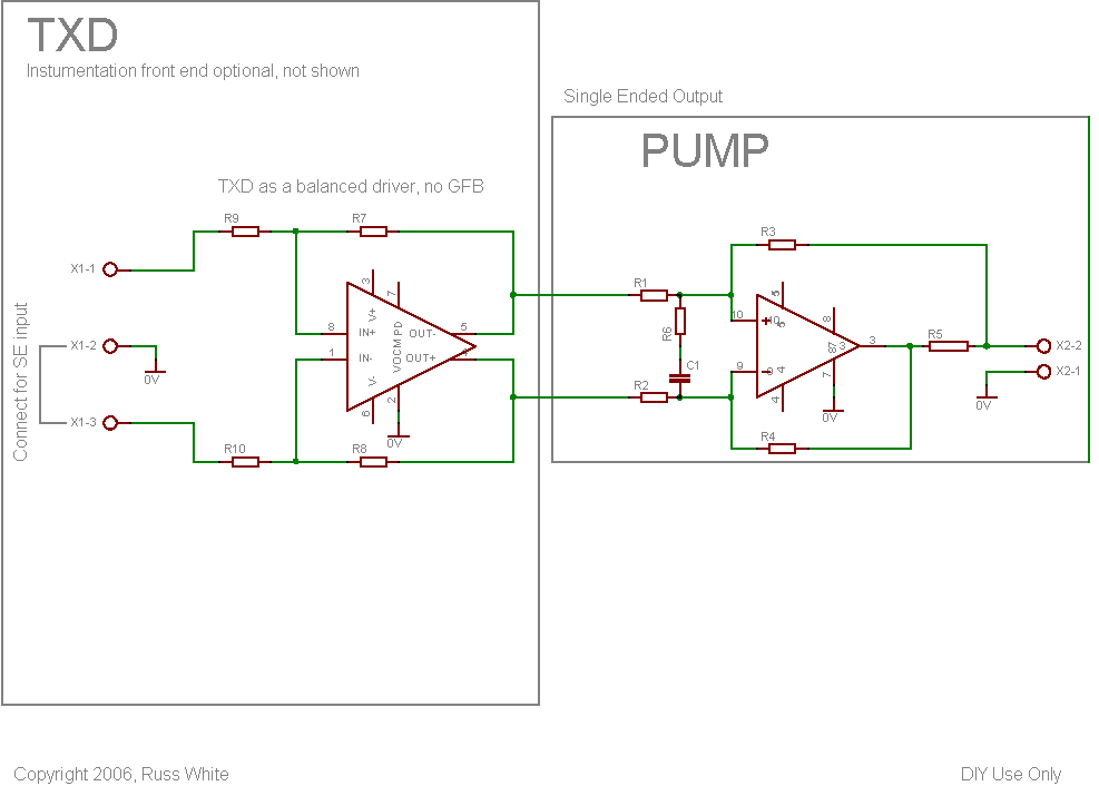

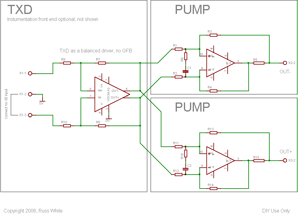

A new Twist on these ideas Mauro has suggested....
Today I have built a new amplifier based on the current pump (bridge) idea that Mauro has shown us.
This is a new design as far as I know, I have never seen anything like it except My_Ref which has the current pump in common.
The compensation of the circuit is much more like Rev A, but because of the speed of the THS4131 it is actually quite linear and phase coherence should be very good.
Anyway, it looks a bit like this, this is a partial schematic, but you should get the idea.
All of the pieces are modular, making it easy to build an amp of significant power capability. The way I have it should be capable of ~200W.
I am withholding the details for now, but if there is interest I will show them.
The amp is based on my "Twisted X Driver" front end and is fully symmetric. The current pumps operate in a bridged configuration and you can parallel as many of them as you like(within reason) My prototype has four pumps per channel, so there are 8 devices for the stereo pair.
I am still testing, but early results are very promising indeed. I have zero offset at the outputs, and offset from each device to GND is low enough not to worry me. I could easily add a servo to take care of it if I like.
I have at least temporarily named this amp "Monkey Puzzle" after the Tree. 😀

The THS4131 is fully symmetrical(super if you will), TI licensed the IP from Nelson Pass.
We gain effect of symmetry by placing the current pump in each of the loops. The performance of the entire circuit is dominated by the driver. This is the same principle Nelson himself used in the "GC SuperSymmetry" thread. The only difference is I utilize a fully differential opamp in place of a differential pair of discrete transistors. 🙂

I have an Evolution board, just waiting for a chance to build it.
This also looks very interesting. Any idea availability timeframe for the boards?
