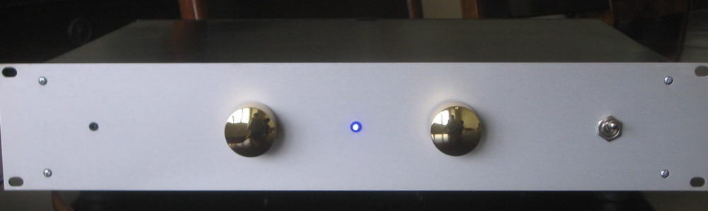

protos said:Some 230 euro (I guess technicians are expensive in Italy)later he has the rev_c back working and he is very happy.
Yikes!!!
For less than that I would have sent him a complete assembled and tested pair minus trafo!!! 🙂
Cheers!
RUss
Yeah, I know ,the whole integrated amp including a nice case,400VA trafo,integrated non-os DACw supereg power supply ,alps remote volume control,selector, connectors etc cost 450 Euro to make and thats what he paid ,excluding shipping.
A pretty good bargain I guess.I would like to have friends like me😉
protos said:This is it again
Very nice! Only thing I would change is the switch. 🙂
well yes, the switch could have been rotary so another gold plated knob to match.In fact as I had finished the amp I discovered -by chance-that for some strange reason the remote pot sounds worse when powered so I put in a double throw 3 pole main switch so that you can actually listen without the remote circuitry on for critical listening.I remember a similar impression from my Creek passive pre which is based on Alps remote.The difference is quite obvious but I cannot understand it since the motor attached to the pot is not on allthe time.
How´s that for being fussy?
