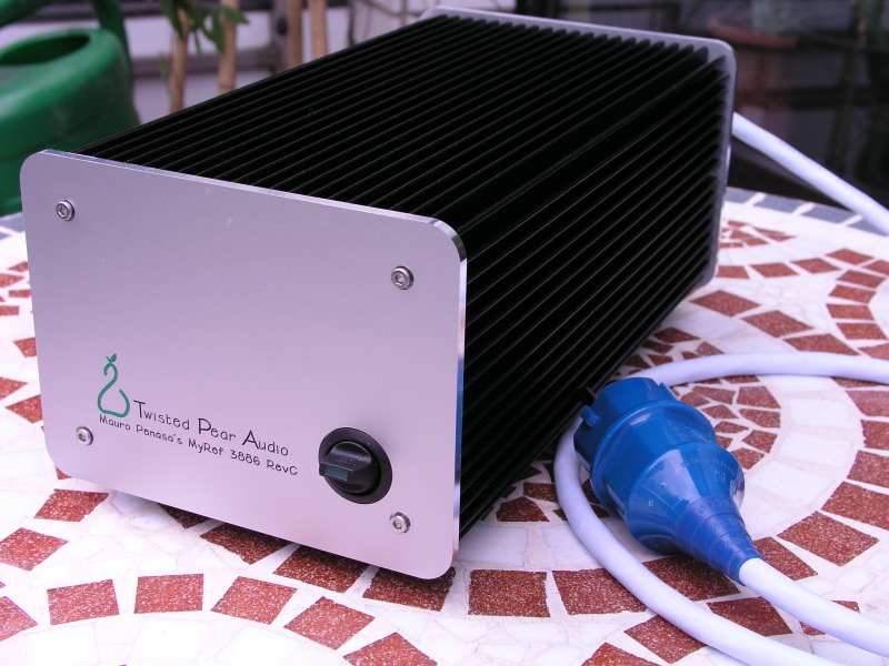

yesterday I have finished my RefC Mono-Amps. First of all I have to thank Mauro for his circuit and Russ+Brian for excellent PCB-design and the Ref-C kit.
It was late in the evening when I finshed the Mono-Amps, so had not time for long listening. First impression was a very soft sound, good soundstage and focus. I will do some more listening tests tomorrow.
I have used the TwistedPair Kit as a starting point and replaced some parts (e.g. Mica instead of foils, Vishay Dale resistors, Rubycon ZA, 0,47 Ohm Film Resistor, Black Gates, MKP-Bypasses). The transformer is a 200 VA type.
Arne

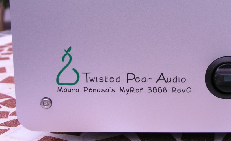

the trafos are 200 VA types. They are already custom-made products. Normal 200 VA transformer have diameter > 105 mm, which would not fit in the small cases.
The frontplates are from Schaeffer-Apparatebau (http://www.frontpanelexpress.com/ in US).
The heatsinks profiles are from http://www.fischerelektronik.de/.
Attached you will find a close up of the frontplate.
Arne

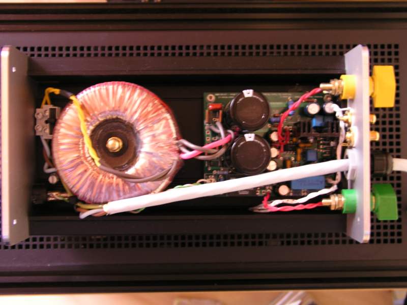

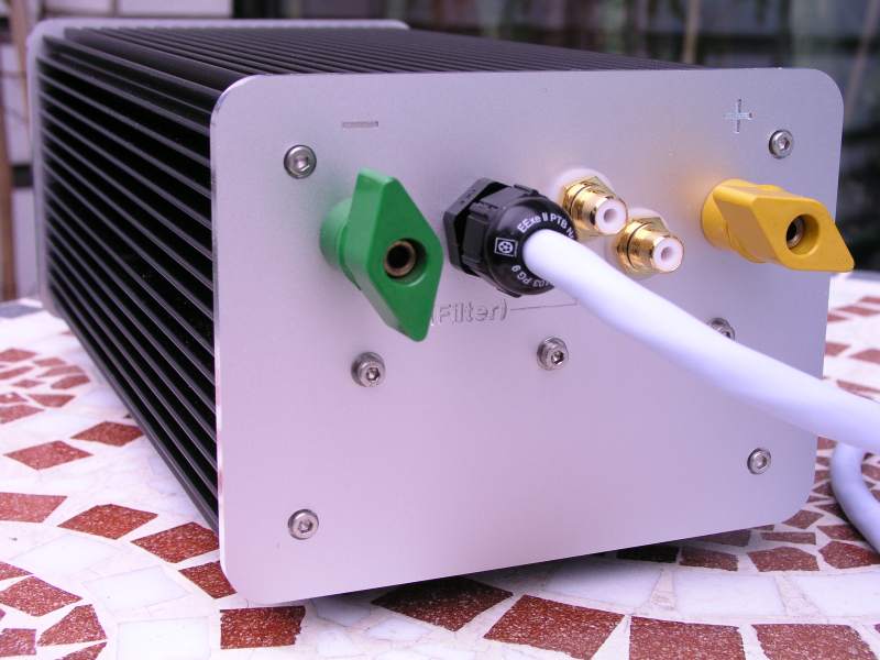

Very nice!
Excellent work, clean wiring and pretty units. Two hopefully constructives.
Why the two RCA input jacks?
Also, your input power cord is very close to the input section. This could give a little hum. With the high impedance of the input ithe hum level rejection can be an issue. If you get any hum it may come from this.
George
THX!
The second input jack is for later purposes. If I am fully satisfied with the sound of the RefC I will use them to activate my manger speakers. The crossover for the manger driver will be a 4,7nF capacitor (+100K input impedance) which will fit easy in the Amp-Case.
The power cord wire I am using is a shielded one. During listening tests yesterday I could not detect any hum or high-frequency noise. Because of little space for the connectors on the backplate I was not able to arrange them in a better way.
Arne

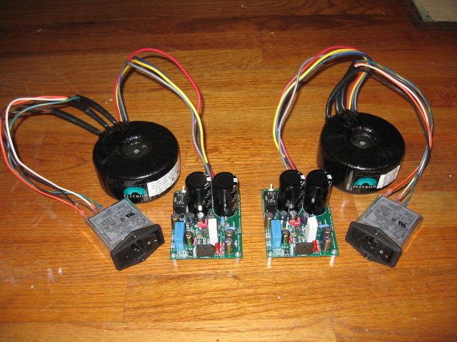

While not done with my RevC, I am much farther along that when I first discovered this thread a few months ago. So far, I have the RevC boards completed with the upgraded diodes, 300VA Plitron transformers, Qualtek power entry modules, and Vampire BFP posts. On order are a couple of Lansing B-type grey box enclosures (2u tall, half width, 8 inches deep). I still need to specify my RCA input connectors and the heatsinks. My plan is to mount the heatsinks outside the enclosures on the back. Perhaps 3 inches square--suggestions for heatsinks welcome. Thanks for viewing.
Enclosure
I think you said 2 inches tall for the box. The Rev C will require more clearance for the 10K filter caps. I think the caps are about 2 inches tall, with a little breathing room under the board it is tight in a 3" tall box.
My power demand is real low, so I have gotten by without a real heatsink. Used an aluminum plate inside and just the cast aluminum box to radiate heat. With an additional aluminum plate the total thickness is maybe 3/16" over 3 - 4 square inches. Several hours playing only gets it a little warm right over the chips.
Good luck in getting yours playing.
George
Thanks for the prompt feedback. I am encouraged to hear that the chips don't get too warm. The Lansing Grey Boxes are sold by unit height, so 2u=3.5inches tall (should be plenty of room). I'll post pictures of the empty enclosures when I get them, and probably ask for opinions on layout.
