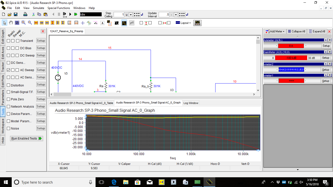

Hope your rebuild is going well, I thought I would post a picture of the SP-3 phono simulation using the original values in the feedback, it’s not very smooth, but if you check out Joe Curcio’s SP-3 mods, the Response curve is much flatter, their isn’t a sag in the upper bass, lower midrange you see in the picture.
I’ll post a pic of the simulation of the mods, when I get a chance.
http://www.curcioaudio.com/SP-3 Mod Documentation.pdf
