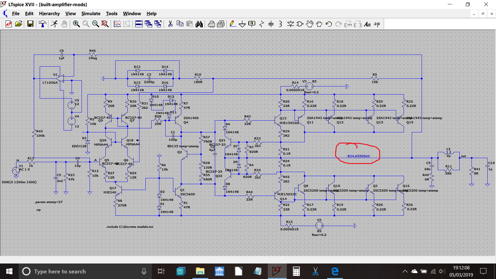

As it is, the amplifier can be used, but for an audiophile, this amplifier's noise output should be reduced. Since as it is, the amplifier is useable, I will not commit any physical changes unless I am certain such changes will improve the noise figure.
Please, be patient with me: my technical jargon may not be the standard jargon, and that means, misunderstanding of what I write has an increased probability.
Since there is a large, 2200uF, electrolytic capacitor in the feedback path, it is logical to ask whether this capacitor, that is usually used as a reservoir capacitor in power supplies, is the actual source of noise. I shorted this capacitor in LTSpice, but the DC offset was displaced down to -1.733V. Naturally, this is too high. Somewhere on this same thread, it was mentioned there are ways to add an additional constant DC signal to the input to move the DC offset to 0V. Since, this additional circuit seems to be standard, I do not want to create one myself but use, if necessary, an existing one. A slight positive voltage added to the non-inverting input should remedy the issue.

The updated circuit with a DC offset adjusting resistor network is attached. The servo is made of resistors R45, R46 and R47, R46 being a preset. The large electrolytic capacitor is shorted.

When I shorted the 2200uF capacitor that is in the signal path, the noise intensity decreased, but I used a 10R resistor in series with the speaker to protect it from the -2V DC offset. I know this sounds paranoid, but prevention was always better than cure.
After this step, I removed the capacitor. With the capacitor shorted, LTSpice predicted a DC offset of -1.7V, so simulations and reality seem to be moving together.
Listening to the slight remaining noise, I can hear some weak cracking. I am tempted to attribute this cracking to the electrolytic capacitor across the VBE multiplier.

As the crackling sound remained, I am concluding the large electrolytic capacitor is not the cause. This conclusion is in accordance with Mooly's belief, and I think, Mooly knows better than me.
Having concluded the above, I restored the circuit to its previous condition by putting back the large electrolytic capacitor together with its four signal diodes.

My comment was based on Mooly's servo circuit version which does not include the resistors R45-R47 which you added. In so doing you have altered the biasing of the input transistor.

Note the zener diode is part of this set up you created -and - both the base and collector of the input transistor have connections to this - so you are also introducing some noise from the zener into the base.
I am not excluding a dry joint since I have been handling the PCB repeatedly for a very long time. Some solder joints are too small, this means a broken soldering joint is quite possible. The power stages emitter resistors come to my mind. Their structure is like a tower and their soldering joints are small. I have no experience with amplifier repair, but I expect a dry joint at a power stage's power transistor may give rise to the crackling plus white noise which I am hearing.
I will power the amplifier and use an insulator stick to lightly touch components. If there is a dry joint, I should be able to hear the amplifier responding to this.
Regarding "best practice" I was always aware signal paths should contain no loops and should be as short as possible. Another thing, is keeping heat sensitive components away from hot components, although even at full power I should not get overly hot components.
This is a teething problem of the several to come until the amplifier is fine-tuned to how I want it. For instance, the unbalanced input is picking a very slight mains hum signal. For this, I will prepare the inputs wiring for balanced inputs, as that was what originally the amplifier had.
It seems I was right, testing is indicating it is a dry joint. The simple test consists of lightly touching the power stage's emitter wirewound resistors. The crackling vanished, only a very low white noise remained. I will resolder the joints.
