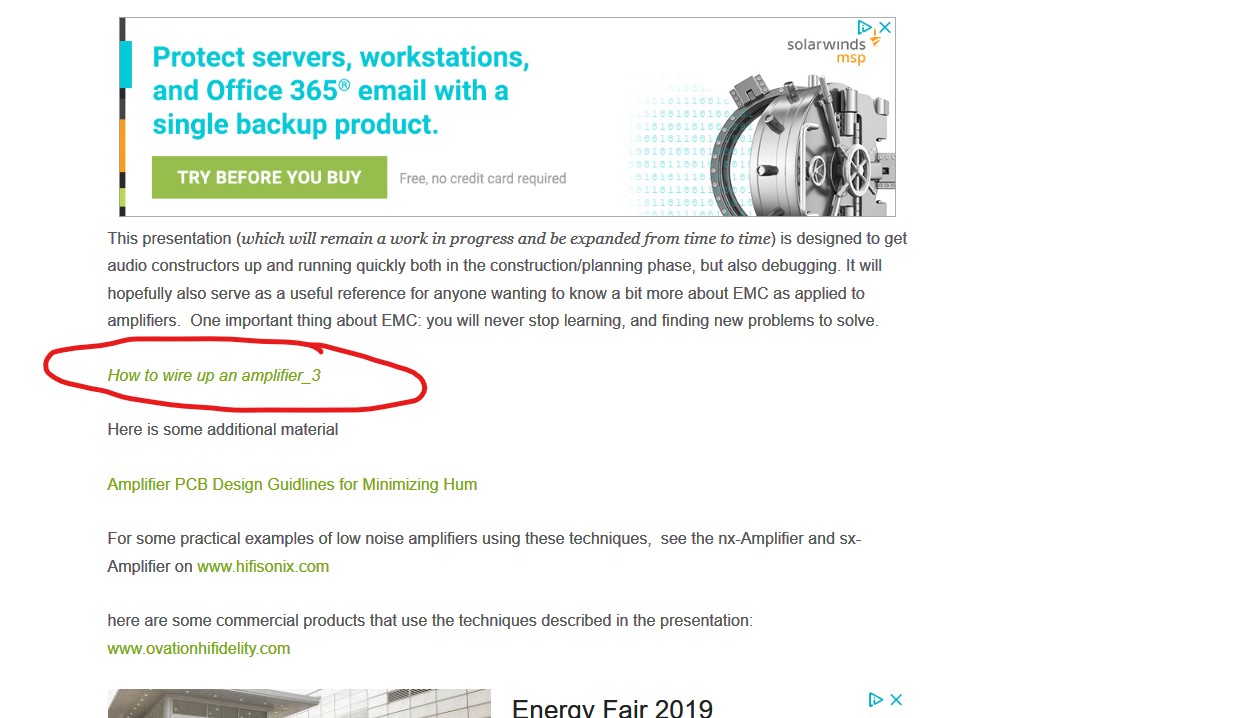

I expect by now having read the material associated with correct earthing - including the radiated effects of output stage switching.

So, to get a clean input interfacing one needs to cancel out all interfering signals that use the signal ground as their passage. Reading has again confirmed that the best input interface is one which has the ability to cancel out all interference signals, and this, without doubt, is the honourable balanced input. However, this amplifier I am now busy building and testing, does not have an input like that. The reading mercilessly further reiterates that unbalanced input interfaces suffer from all sorts of interference problems. It suggests using signal isolation transformers, a very costly solution if one is after high quality. It also suggests using coaxial signal cables that have purposefully heavy shielding to lower the shield resistance in the hope of also lowering the interfering signal voltages. Although, this latter proposal seems easy to achieve, it is still inferior to what is achieved using active interference cancellation as with an XLR input.
With a pair of dropper resistors, an opamp with adequate specifications, a few resistors and capacitors, this should be possible to implement.
Notwithstanding XLR being the best, I have seen and used home audio equipment from thirty years ago that has very high signal cleanliness. This means, there are definitely ways of avoiding the use of an XLR input.

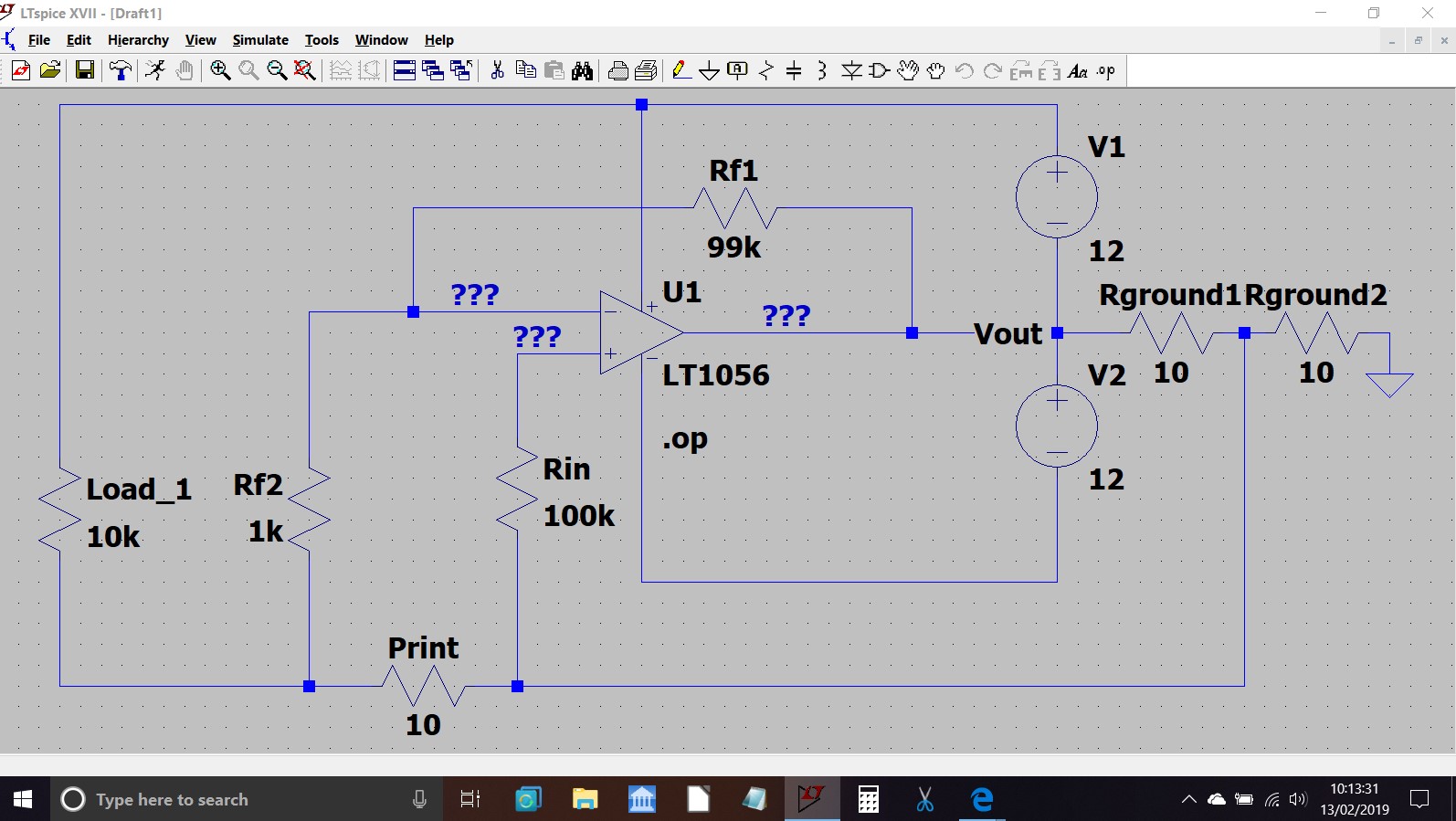

Grounding problems were something that my early amplifier designs always seemed to suffer from in some form or another. Using thicker cable in the hope of lowering resistance isn't the answer, the answer is to understand the current flows in the various PCB paths and wiring and try and come up with a scheme that makes the wiring 'disappear' electrically.
Its difficult to give real life examples as each case is unique but try this.
This is a DC sim but the load at the left could equally be a cap where the current in it varies due to either ripple on the rails or the rails being modulated by the audio.
The output of the amp should be 0.00 volts at all times. If you snip the load out of circuit you will get 0V output.
The 10 ohm resistors represent wiring and print resistance.
Now make a two channel version running off one power supply and ensure that where the two input grounds couple together at the audio source that there is also no interaction as one channel draws current and the other does not.
Try cutting the Rf2 ground and now link it back to the junction of V1 and V2. You will get a different result again.
So you have to ensure that your scheme is not influenced by currents flowing in conductors and print. In practice this means ensuring the speaker return comes back to the power supply and that signal grounds (that become a point of reference) are taken from past this high current return.
In the simulation you can also think where any load currents might be returned to such that they do not influence the output voltage. So add a load of say 1k and return it to different ground points and arrange it so that it has no effect. Set a DC input voltage to test this and compare no load vs with a load output voltages.
If you alter the supply voltages, the output voltage should of course be constant. If its not its because the DC currents flowing in the conductors is influencing the voltages seen by the opamp inputs.

The power stage and power supply smoothing electrolytic capacitors are on one PCB. This is the original amplifier PCB. The signal processing stages, SMD circuitry, was sawed off. The tracks connecting the output transistors to the supply rails are from the original PCB. These are very thick tracks similar to those found in switching power supplies.
The PCB I built that contains the input, VAS and output protection circuitry takes power from a point near the electrolytic capacitors. The current it draws is very small: 2.5mA for the input stage and 14.5mA for the VAS. This means, it only takes a current that is less than 20mA.
What you, Mooly, illustrated has been on my mind since I started this project. From an engineering point of view, it doesn't make sense to power a circuit from a point where its performance is compromised.
At this point, I am tempted to build a small PCB to host a differential input with equal gains for both the non-inverting and the inverting input. The aim is to have an XLR input. These days, there are audio cards that provide XLR outputs, therefore it makes sense to make an XLR input. The choice is either using a descrete circuit or an integrated circuit.
