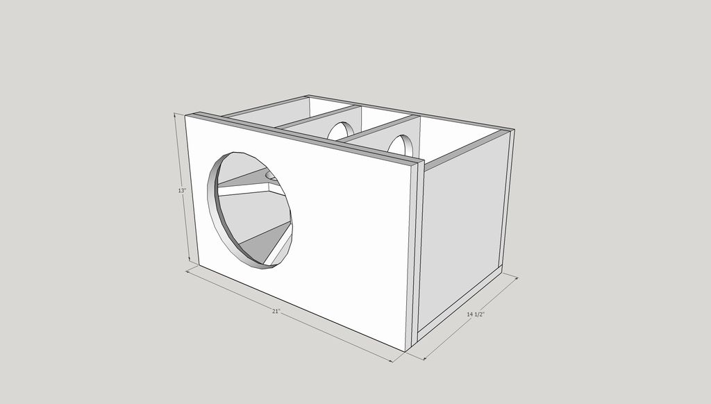

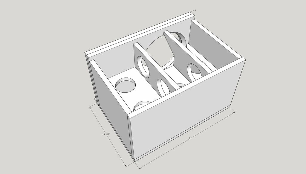

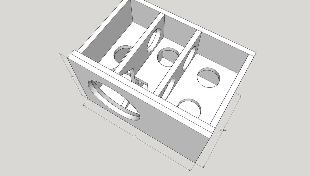

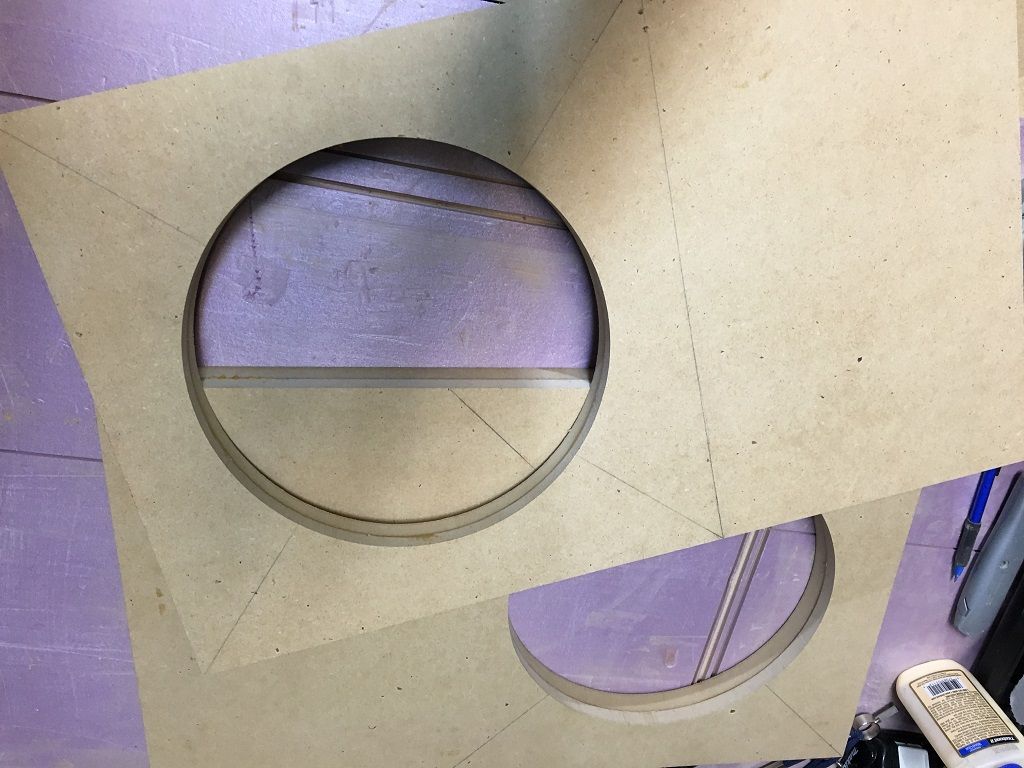

Here's the simple enclosure I designed for the woofers. Should be right about 1.4 cubic feet net, which is what Parts Express recommends. Pretty sure I'll end up throwing the enclosures away down the road but they should work well for learning, I think.

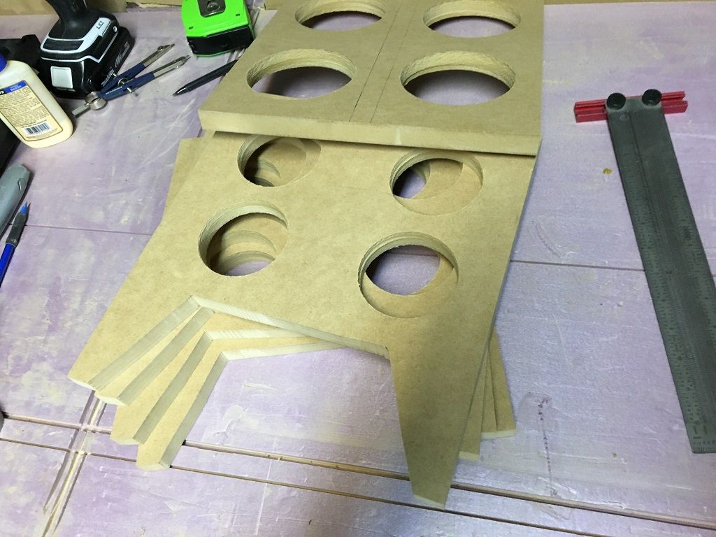

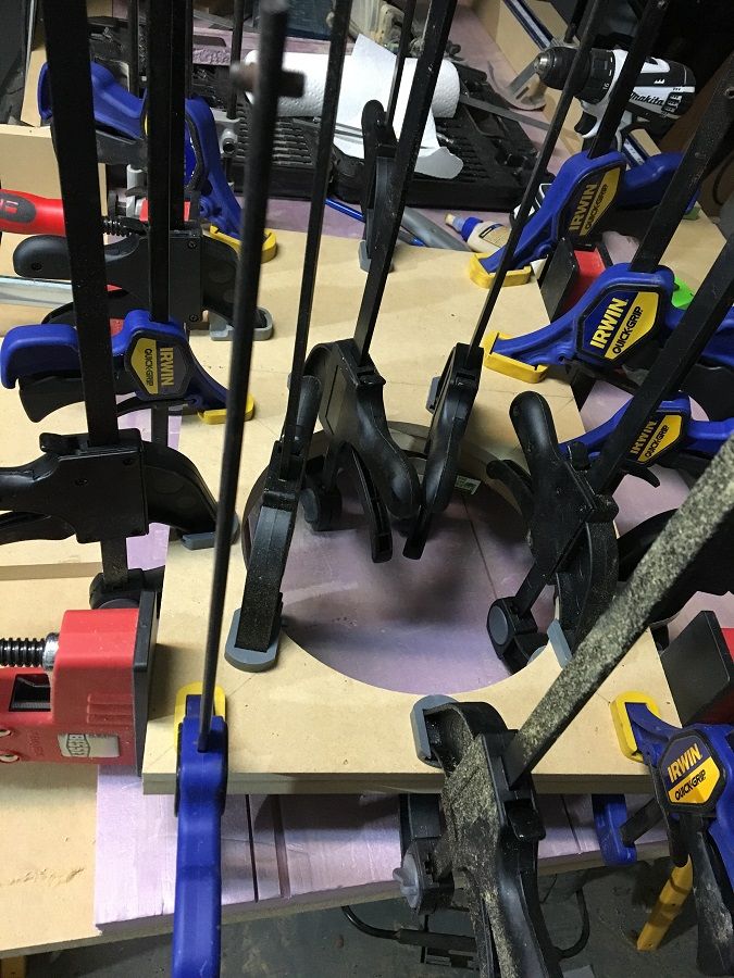

Making progress on my enclosures.
All the pieces were cut to size over the weekend. Got the baffles cut and laminated.
Most of the holes are rough cut into the internal braces, but the stupid chuck keeps slipping off the arbor of my cheap drill press when I try to use my 4" hole saw. I may have to use the jigsaw for the last few 4" holes.
Need to round-over and smooth the internal brace holes and bevel the back edge of the baffle cutouts then I'm ready for assembly.
Hoping to have them ready for listening by the end of this weekend.
-Chris

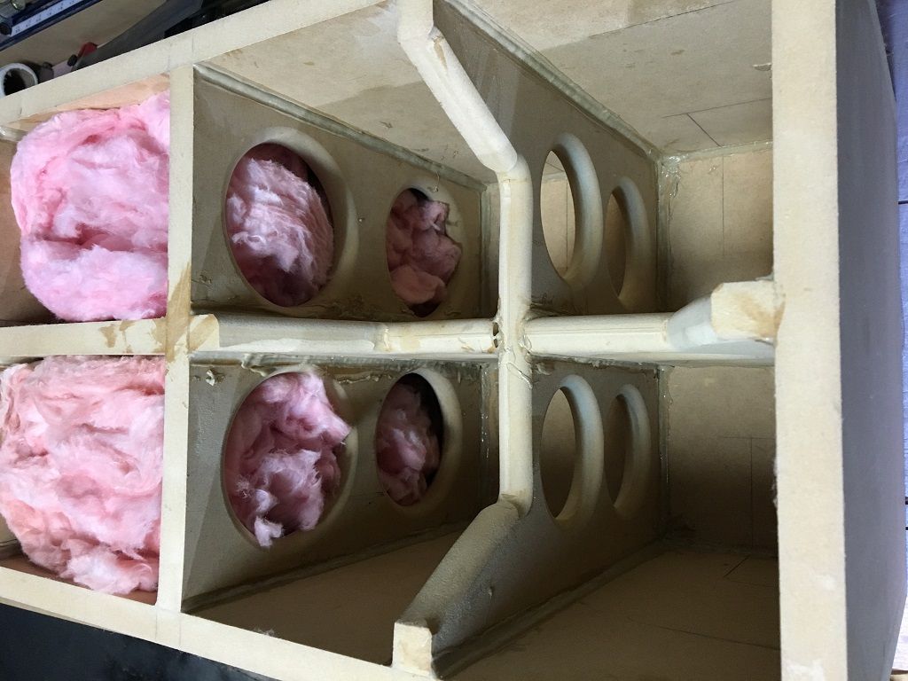

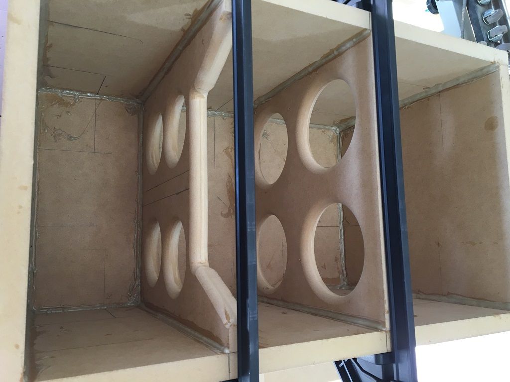

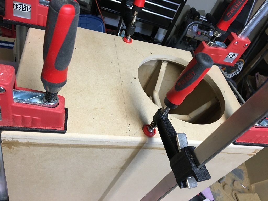

Didn't get as much done over the weekend as I hoped but I spent a little more time on these last night and tonight. Getting really close. Glued the baffle to one this evening.
I used regular wood glue for the outer shell and it was pretty air tight but I ran a bead of urethane construction adhesive around the inner joints to be double sure. Same stuff I used to glue in the braces and the baffle. Made a mess though.
-Chris
