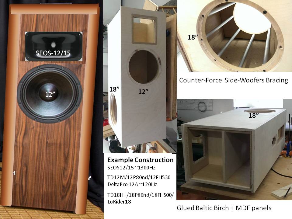

1) why a dedicated midbass like the TD12M is frequently used.
2) why a large midbass covering ~1300Hz tweeter crossover is typically crossed ~100Hz - 150Hz to avoid audible Doppler distortion, and to also improve clarity around the baffle step + room modes transistion.
3) why high-efficiency 3-way main speakers covering 25-18Khz have advantages over 2-way plus remote 80Hz woofers.
P.S. When DSP with time-delay alignment is used, the "improved" pattern control provided from the 5" deep SEOS-15 or 5.9" deep H290C horn from pi-speakers is sometimes favored over the 3.9" deep SEOS-12. Worth some study.
When a tweeter horn/waveguide is used, the polar directivity of the midbass at the crossover frequency should match the polar directivity of the horn/waveguide at that crossover frequency for a smooth, seamless transistion. A significant mismatch will garble the soundstage from the abrupt wide-narrow and narrow-wide directivity changes. The SEOS-12 or SEOS-15 waveguides require matching their 90H-polar directivity at a frequency where the midbass also produces 90-degree directivity. Study of common 12" -to- SEOS12 crossovers shows 1200-1400Hz is typically used by top designers for this match.
High-frequencies riding on low-frequencies can produce intermodulation distortion(IMD), often called Doppler distortion. Simulations and listening test confirm that a 12" midbass crossed at 1300Hz to the tweeter waveguide can generate audible IMD when used below 100Hz. Modeling shows a rapid increase in IMD even from 100Hz-> 80Hz. A smaller cone area midbass can be used from 1300Hz down to 80Hz(THX/Dolby spec) with acceptable IMD, but large cone area midbass require extra attention.
If a 12" midbass has a 100-150Hz low frequency crossover, physically adjacent woofers are required to avoid confusing the listener's brain from shifting sound-stage queues. Well studied in the literature, and why THX set 80Hz as the highest remote woofer frequency.
At audio wavelengths long enough to wrap around the 180-degree baffle and split-off some of their energy into the 360-degree room volume, your DSP room equalization will sum-in a roller-coaster of compensation power. Some designers report improved midrange clarity if the larger SD woofers are "wacked around" on this roller-coaster instead of the midbass trying for audio perfection up to 1300Hz. Many "acceptable width" cabinets in "small rooms" experience substantial baffle step and room-mode equalization around 150Hz, so a 100Hz-150Hz crossover gives the big beating to the big woofers.
Well crap. I see it now. I was looking at the SEOS-12 being able to cross over at 950Hz and thinking I would be in good shape with a mid bass running up to that point. But you are saying that crossing over high enough to take advantage of beaming prevents an abrupt change in directivity at the crossover point.
Remi actually touched on this but I didn't get it until now.
So how noticeable is the transition if the crossover point is down where the 12" woofer hasn't started any beaming? It seems like the rolloff from the crossover would help to smooth things in a similar way.
I'll do some reading on IMD this evening.
So, basically, if I want to use a SEOS waveguide, and take advantage of DIY community knowledge on integrating them, I need to throw away my current subs? That gets pretty hard to swallow when I haven't even heard mid range and treble through a SEOS.
I definitely see the logic behind the 18 and 12 in your examples though.
All of it seems to be a chain reaction from the desire to match radiation patterns between the mid bass and the SEOS. Which makes my question above even more important. How audible would it really be to cross my 12" woofer over at about 1000Hz rather than 1300? And why would it sound much different than the rolloff from a low pass filter?
