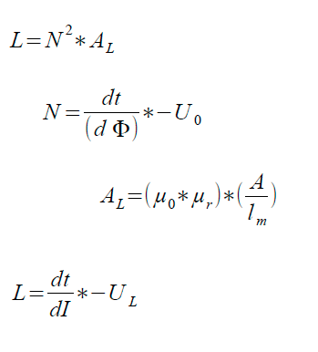

Let's take a look at the well-known law of induction, turn ...
and remember what the coefficient of self-induction called inductance actually expresses and what it is directly dependent on. I think that puts modeling and, above all, absolutism back in perspective. In short, the coefficient L(tc) cannot be constant (in sampling mode as transducer_coil or our electrical tests).
The challenge now is to represent this coil (an N wire winding on a soft magnetic iron core) as a lumped model in such a way that it can correctly model a wide load spectrum.

Wouldn't it even be advantageous if the parameters were determined with a constant current flow? If so, then the next question is the absolute value of this current flow.Yes, you need to measure with as small an excitation as you can; a cartridge has tiny coils and a core that is easily saturated. Fortunately, with constant voltage excitation, the impedance is enough to limit current.

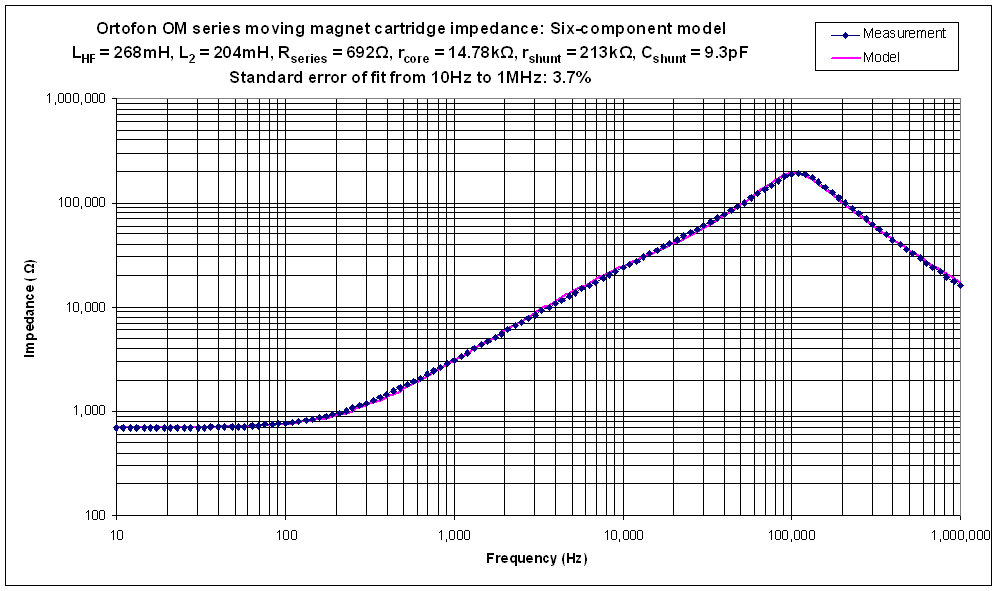

Yes, it is very good. It mentions short-circuit and open-circuit calibration. For my test set-up, I have short and open circuit sweeps. The short-circuit sweep reveals a little lead inductance and some skin effect and the measurement spreadsheet subtracts these series components whilst in A + jB form. The open-circuit sweep reveals a 0.005pF stray shunt capacitance, in parallel with 100G that is due to the analyser's noise floor, but (so far) I do not attempt to correct for these parallel components.
When the new analyser arrives, I will derive new corrections. Hopefully, the noise floor will be lower, revealed by a larger shunt resistance.
After a lot of stress, it finally arrived, three weeks late. I finished making a screened test jig for it yesterday. I have successfully driven the tester from computer and swept stuff from 4Hz to 8MHz. I can confirm that my original six-component model is correct; I fitted an Ortofon OM cartridge from 10Hz to 1MHz. (Didn't go to 8MHz because it just didn't seem necessary - 1MHz is good enough for audio!)

About your latest results:
immediately raises a plausibility question, because an ideal parallel capacitance, a global Cp, always leads to the resulting impedance decreasing with increasing frequency.
And it is precisely this behaviour that contradicts real physical procedures, i.e. nature.
Ultimately, this thread also revolves around the question of the usefulness of the known chained four-pole models of an LT-Spice user.
Would you like to post the determined impedance curve of the measuring system here, with the phase?

Indeed parallel capacitance leads to impedance falling with frequency, as shown. But that makes sense to me because I expect to see stray capacitance across the coils. I believe the impedance is determined purely by the electrical parameters of the coils and that the coupling from the mechanical system is so weak that its effect is not measurable. When I am happy that my test setup is as good as it can be, I will try comparing measurements with and without the stylus inserted. I've not bothered plotting phase because in a linear system, all the information can be gleaned from the more intuitive plot of Z.
