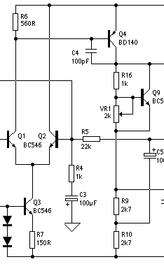

Okay, I see what you're saying... So then it would be more feasible to make a class ab using my other transistors, I do however need info on how to work with long tailed pairs and global feedback, since they seem so important... Even if someone could help with my diagrams and numbers...

Just like in an integrated opamp, you need global negative feedback coming back into your long tailed pair (diff. amp), or the circuit becomes a comparator. It would take all day to go into all the details, Geoff and I told you some of the the basics in your other thread. With that info, you can design simple amps. I think you can learn alot by studying that schematic and others, as long as you know what everything does, you can use ohm's law to see what's going on in the circuit and what values are practical. Slone's book does a much better job of explaining all this, it tells you about compensation, current mirrors, and all that fun stuff, but it's got over 400 7" by 9" pages. It's worth the read though.
Okay, well, I've decided to do complimentary, since I myself have a better understanding of the topic and I don't know much about quasi comp circuitry. I know I could get a good lot of power out of the japanese transistors so I'll use them... I see what you mean bi big comparator, I've had that problem before but couldn't figure it out. Only thing is, I need to know how to implement a longtailed pair, I do understand that it's a diff amplifier and what it's doing on a basic level. But I have troubles with the math of that part. Also, I'm not sure how to work with bias for direct coupling of a push pull pair... I was thinking the usual two diodes forward biased between the bases of the O/T pair, but I guess that's not a very good idea is it?

There's not a lot of values to calculate in diff amps themselves, just the tail current, half of which goes through each transistor. This can be determined by a simple resistor, or a constant current source of some sort. There is much controversy over which is better, but a resistor is sure simpler. You can also use two diff amps and two VA stages, called a mirror topology.
In this constant current source, the voltage drop of the diodes - the Vbe drop of Q3 = the total voltage drop across R7. The voltage drop across them would be about 1.34V. 1.34 - Q3's voltage drop of about 0.67 = 0.67V across R7. A simple ohms law calculation, 0.67/150 = 4.4mA. Half this is the quiescent current of Q1 or Q2.
The current that you would want here is based on how fast you can charge the dominant pole cap, C4. There's a formula for figuring out how much current you need.
I = 6.28 x f x C4(farrads) x peak VA output voltage.
So for example, at 50kHz, with C4 as 100pF, or 1e-10F, 6.28 x 1e-10 x 50,000 = 0.0000314.
If you have a 65V supply, you might expect maybe 60V peak from the VA, so 0.0000314 x 60 = 0.001884.
So you need about 1.9mA through the each leg, about 3.8mA tail current.
Sorry about that, I forgot to post the image. Then I was trying to get back ASAP and my computer had to go and freeze up on me, and it's like 1:21 in the morning too. It's sooooo frustrating!!!!
Anyway, you've all been doing some posting as I type, so I might be a bit behind. I hope this helps.
P.S. Maybe someone should check me on this stuff, just in case.
