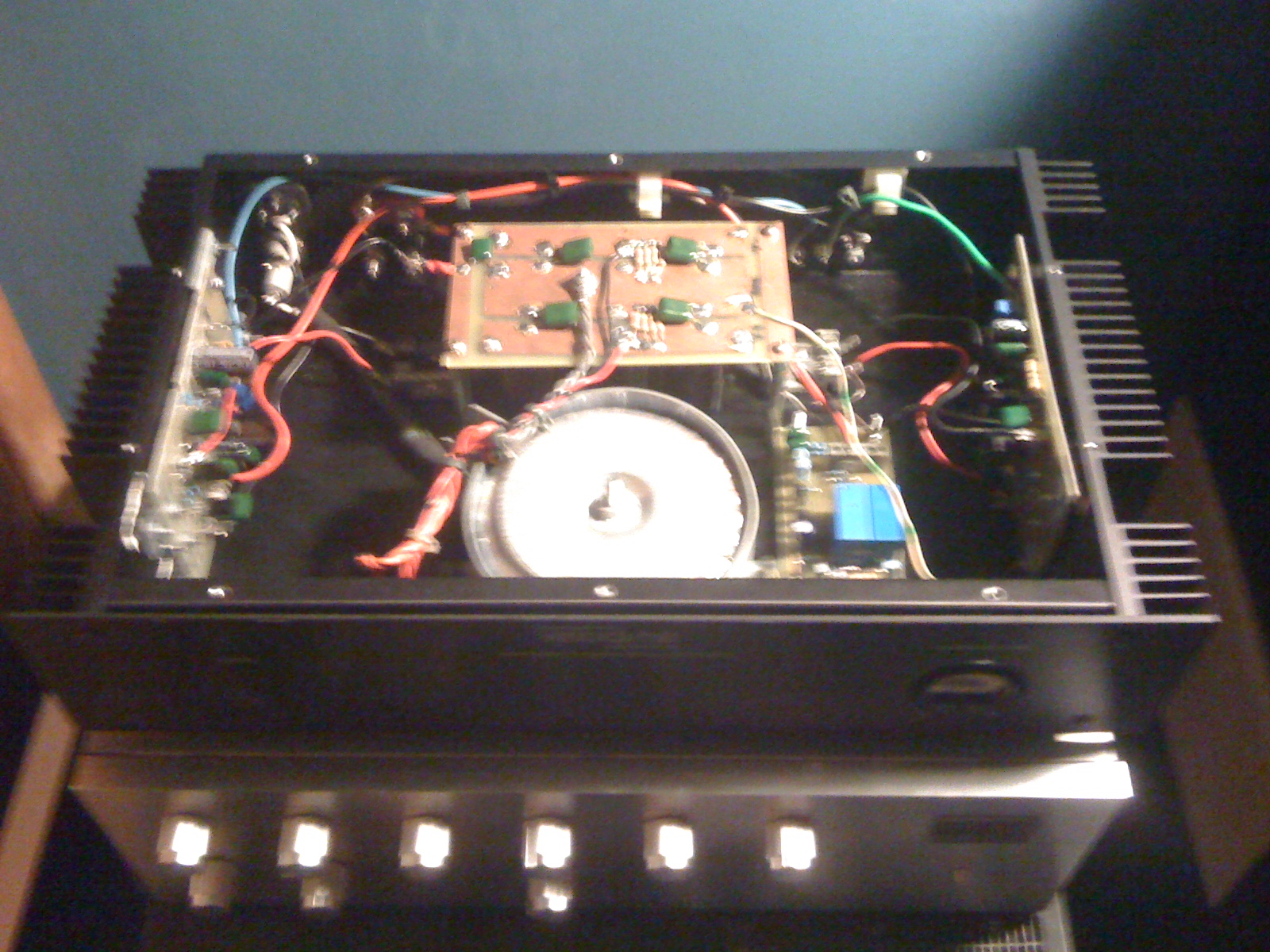

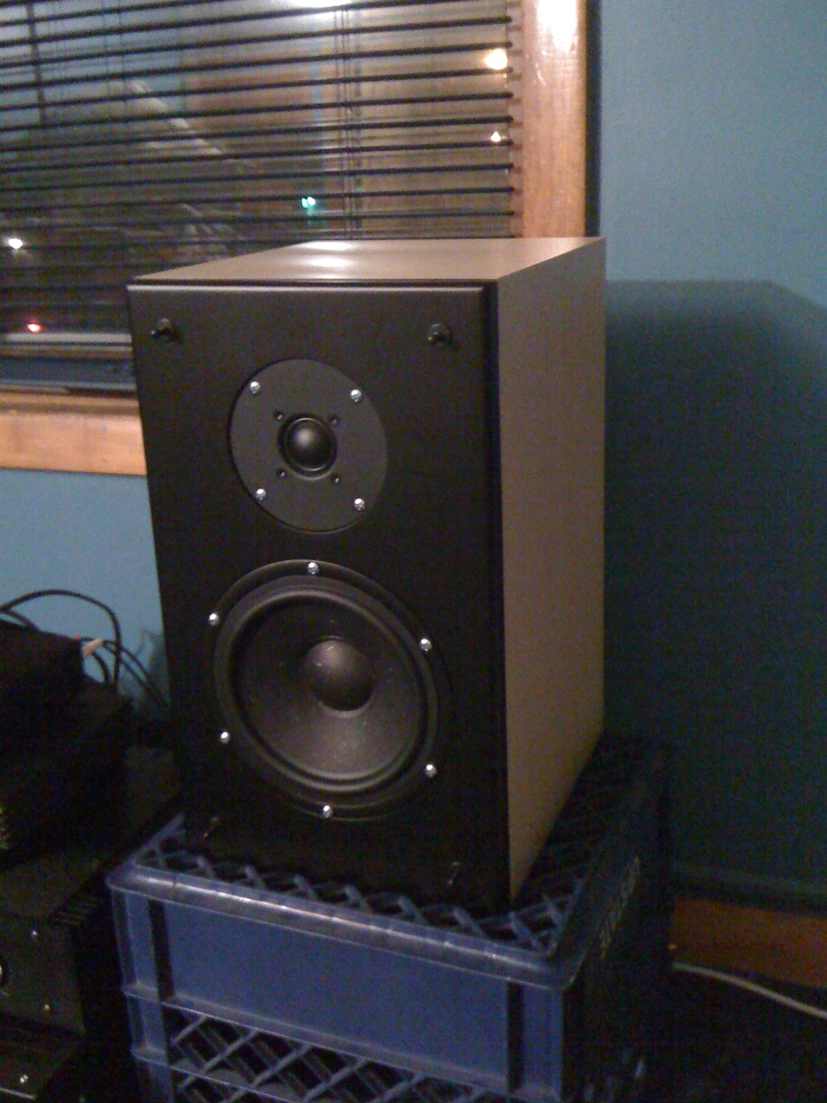

My amp is clipping with new speakers
I have a ClarityCap on the RCA jack inputs and the NFB capacitor is 10uF to limit the bass to my speakers. I don't think that the decoupling capacitors have anything to do with it, the amp is not oscillating. I did have a problem with the amp oscillating at first until I changed the VAS transistor from BD13916 (HFe 100-250) to KSC3503D (HFe 60-120), do you think that the HFE classes of the transistors makes a difference.
The voltages at A is 35.4V, B is 34.1V, C is 12V, D is -35.4V, E is 34.2V

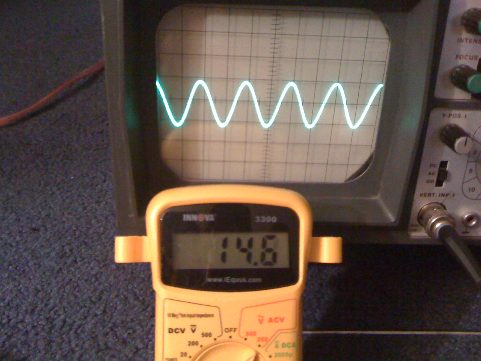

I connected the amp to a function generator and sent a 1KHz sine wave into it.
I connected an AC meter and oscilloscope to the amp output with NO LOAD and the max volts the amp will make before clipping is 14.9VAC on the meter with 700mv into it.
This is about 27Wrms into 8 ohms and 54W into 4 ohms, and is about 21Vpk which seems rather low given the supply rail.

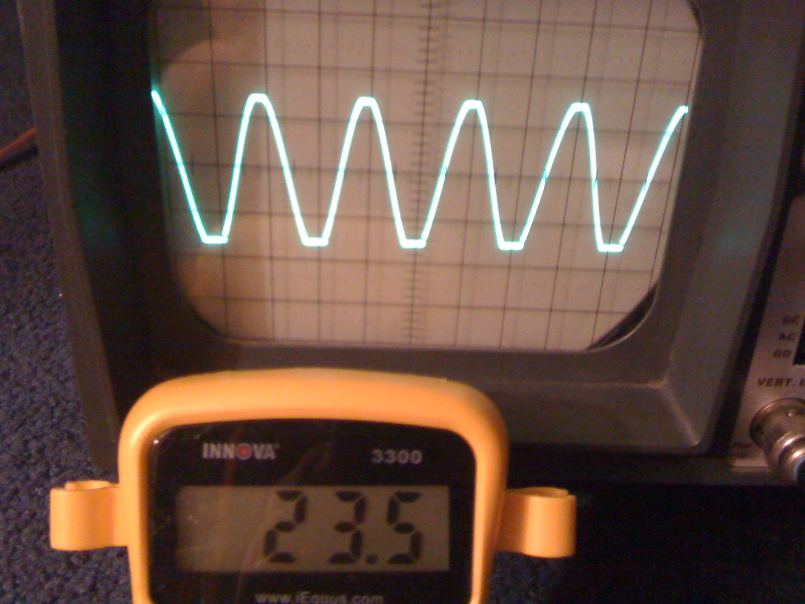

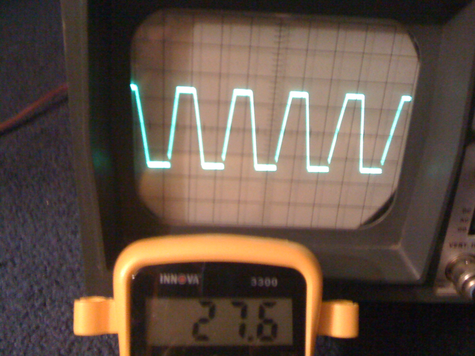

Do we really have a problem here? The multimeter will be reading in RMS, the first figure shows we've got 14.6Vrms which would = 40v p-p, or two divisions on the scope with the gain set to 20v per div. Which is what we see here.
Increasing up to 23.5Vrms, gives us ~66V p-p or 33v per rail, which is just a couple of volts below the maximum rail voltage. This looks like you're getting clipping because you're hitting the ceiling that the rails can provide.
Can you double check to make sure that the readings are accurate? If so, switch down to around 60hz on the signal generator as the multimeter should be fairly accurate at this frequency.

The scope is set to 20 v/div...
OK, so the amp's clipping at about +-30V as it should. No problem there. Dunno what's up with the meter, though. I suppose you could check your mains voltage with it and see if it gets that right.

On an unrelated note, is the trace on your scope always that thick? If not, a thick furry trace like that can be a symptom of high frequency oscillation in the amp.
