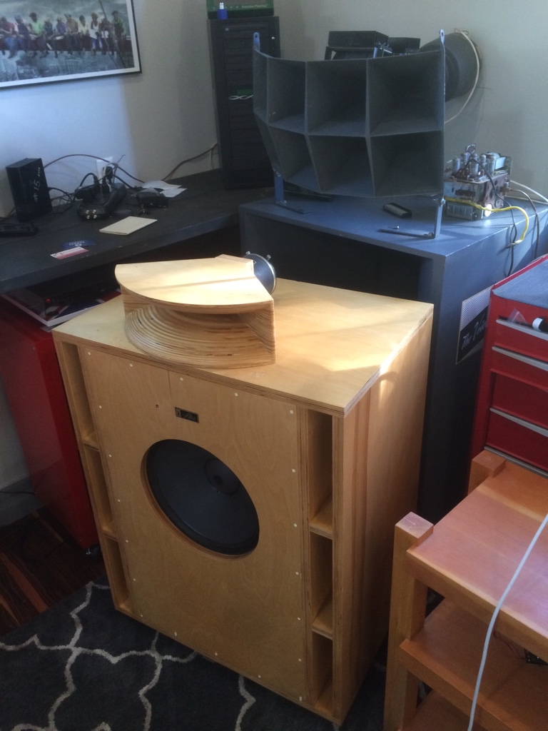

Thanks for the input guys, sounds like I'm giving the 805's a second chance at 1-4khz

Mostly around 14 feet away. I prefer radials like JBL 2350 over the multicells everytime - never had the iwata but that curve interests me. The tractrix (round or otherwise) is even better than radial if crossed over higher. Since going to front loaded dual concentric I have lost the desire to integrate large multi way horns in my room. If I could listen at 20-30 feet maybe I would be staying there.
To OP I would only recommend using the Multicell up to around 1200 cycles based on the size room you have. That would make them a NO for me because there are better solutions from 1200 down to the low mid (250 hz)
I agree. I'm begining to question the use of a CD for anything low. I've been listening to some 6" vintage Philips fullranges xover at 3khz, and I think they would be better than trying to make a 288/805b work. A cone wideband fits perfectly from 200-400hz where the 515 starts to beam all the way up to 3-4khz. If I was listening 20' away, then ya, a horn makes sense. Was also thinking a fostex fe108ez mounted just above the 515 onken would blend the horn on top seamlessly too. Seen others do similar:

Thanks art. I've tried the 805b multicell in my larger room/garage, and limited the extension to around 5k. From 500-5k is sounds very good. Defraction horn has the benefit if being easier to build as well. Whats your preference, cone or compression driver? (500-5k)
I like the idea of using a small cone driver like a Fostex Fe108 sigma. I think it could sound better down low than the 288-8g which sounds kinda lean.
I've heard a Lowther cone in a large midrange horn and thought it was wonderful. Didn't have any of the Lowther nasties. Quite surprising! Why not a Fostex?

A good horn or a midrange cone can both easily cover a decade, so in the 500 to 5 kHz range my preference on cone or compression driver would depend on the application.Thanks art. I've tried the 805b multicell in my larger room/garage, and limited the extension to around 5k. From 500-5k is sounds very good. Defraction horn has the benefit if being easier to build as well. Whats your preference, cone or compression driver? (500-5k)
For a three way system where extended frequency response, efficiency and tight pattern control are desired, my preference would be something like this:
http://www.diyaudio.com/forums/mult...ual-single-point-source-horn.html#post4114406
which crosses in the 80-100 Hz and 800-1000 Hz range.
Crossing in the 80 to 100 Hz range to the woofer relaxes the position requirement for the woofers considerably, as they no longer need to be co-located with the midrange as a 500 Hz crossover requires for decent imaging. When position is no longer a concern, the woofers can be built in to places that don't use up a lot of floor space.
Raising the mid crossover from 500 to 1000 reduces excursion to the point where a decent 3" diaphragm driver on the right horn can sound clean higher than I can hear (16 kHz).
