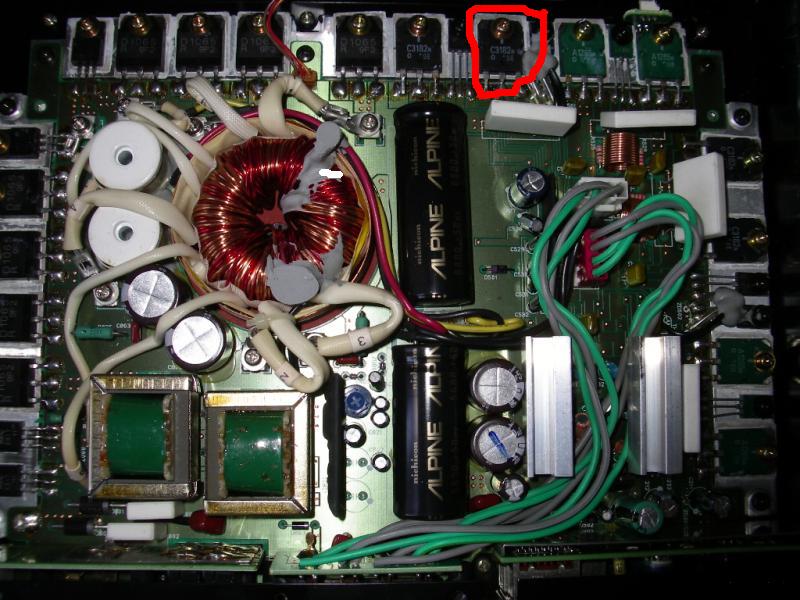

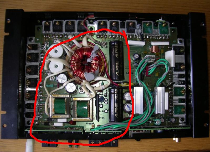

It only went to .020v in the channel with the new transistors
with the bias pots set to there lowest the channel with the old transistors fluctuates between .001v and .003v the channel with the new transistors fluctuates between .004v and .005v
and i noticed that one of the surface mounted resistors on the back side of the board looks a bit bit dodgy it has 330 printed on it dose this mean its 33 ohm?
would the burnt resistor be allowing more current to flow to the channel that's running hot?
You can measure the 33 ohm in the board to determine if it's out of tolerance.
I don't have the schematic for that amp so I don't know the function of that resistor.
When the voltage across the emitter resistor went to 0.020v, how much current was the amp drawing from the power supply.
