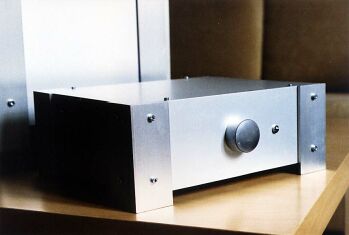

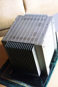

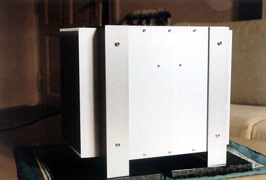

ok. next pics :
and i forgot to say : Thanks ! to Mark Finnis - i used his pcb layout for aleph 4 in my aleph 5. i`ve done only few little "modifications" - i used irfp240`s , ZTX450 + 10nF , "Pi-filter"
in power supply (30000uF+1,8mH+30000uF on "+"and "-" rail)
,8x1ohm 4W MOX resistors (instead of 4x0,47) .......
i`ll try to make pictures of inside of this creatures in this week ....
