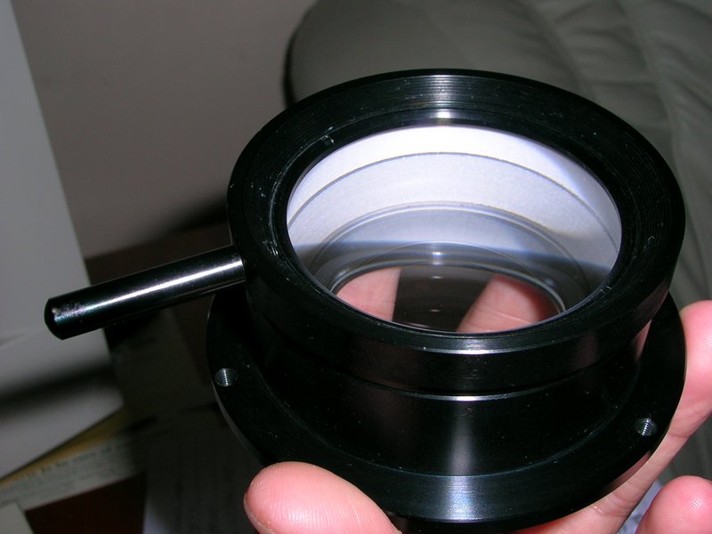

My 8" projector
and heres the lens from the back (50mm in diameter)

I think the only way to determine the current focal length would be to shine a flashlight through it on both settings at a constant distance. If the image is bigger, then I believe it is the lower FL and if the image gets smaller, it should be the higher FL. Do you know the FL of the first objective in the lens? Because that is the distance you would want away from the 2nd fresenel (I think, i still haven't finished my proj yet...damn school and work). The best way to determine you distances is to fire up everything and use a piece of paper (guy_grotke went over this once i think) and determine your distances that way. You will see where the light lands on the paper, try to get all the light to focus as close as possible to the center of the paper (where your lens is going to be mounted). Hopefully I helped, but you shouldn't just take my word for it, im still a no0b too 😀 reiterating what i've read
Oh didn't notice you said you have 305mm FL 2nd fresenel. for that lens you want a 330mm so you get everything good (same fl from fresnel to lens makes it a good pair for some reason) I am going to have an extra 317mm fl 2nd fresnel if your intersted. the dimensions are 12 9/16" (319mm) x 9 15/16" (252.4mm) x 2mm. The lens was used once when I held it up to test out the distances but I've decided to go the 15.4" route and this lens is too small. It has a few fingerprints on it, but in great shape.

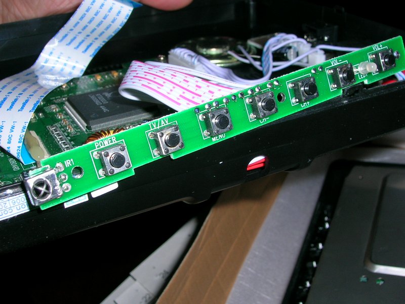

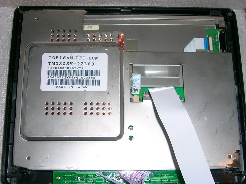

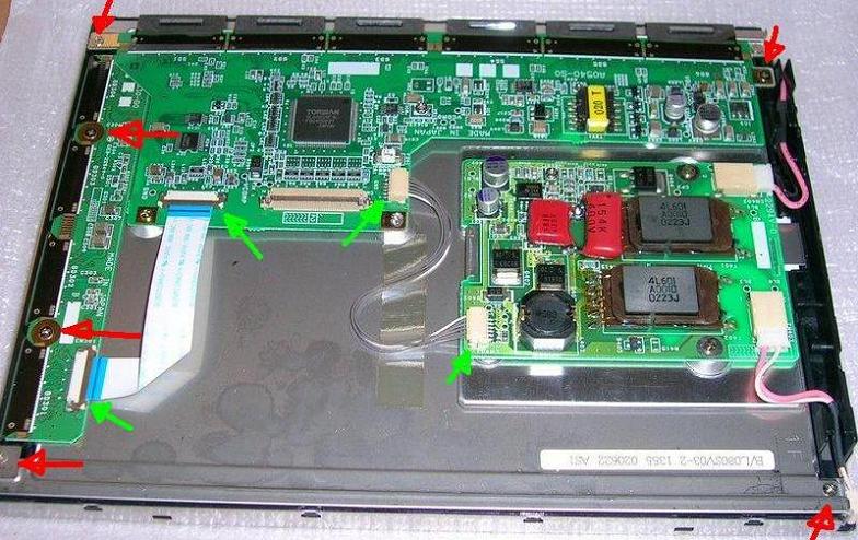

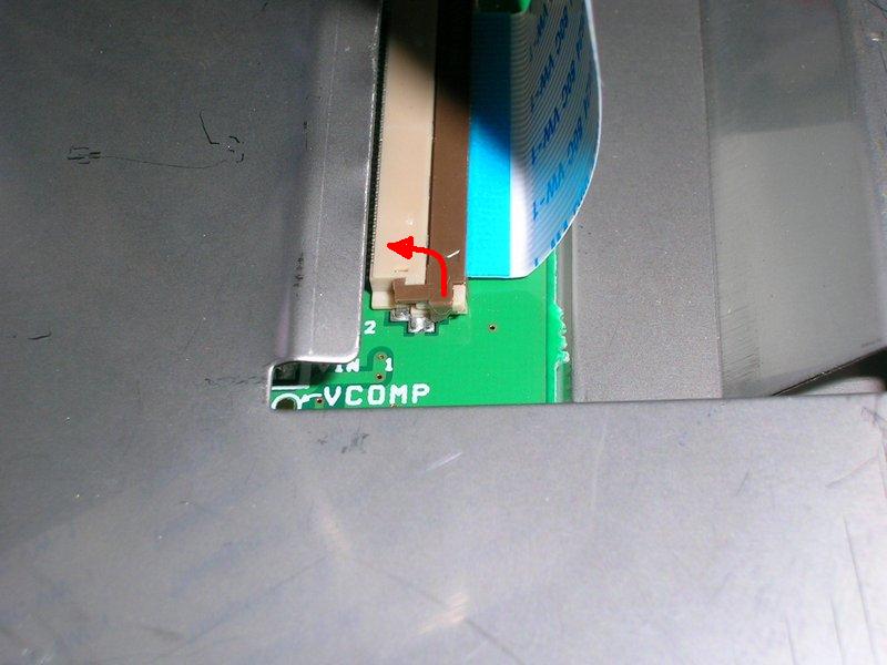

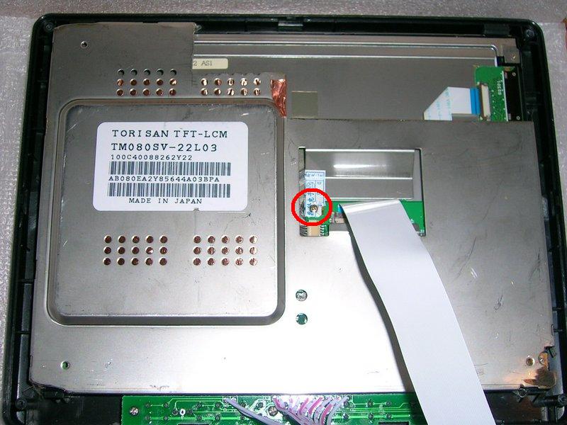

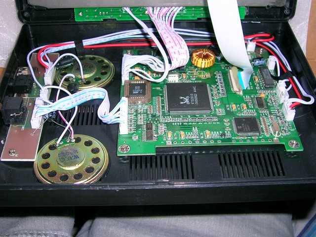

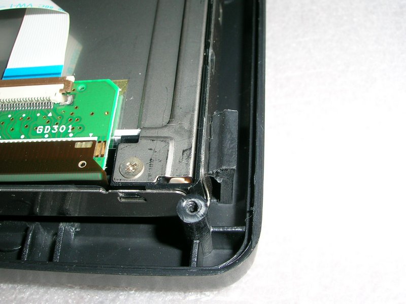

dismantled the Hami yesterday to get some accurate measurements. to anyone thinking of getting one of these its not too hard to do. only problem was some of the screws were really tight (broke one of my new screwdrivers and had to drill it out). might post some pictures later

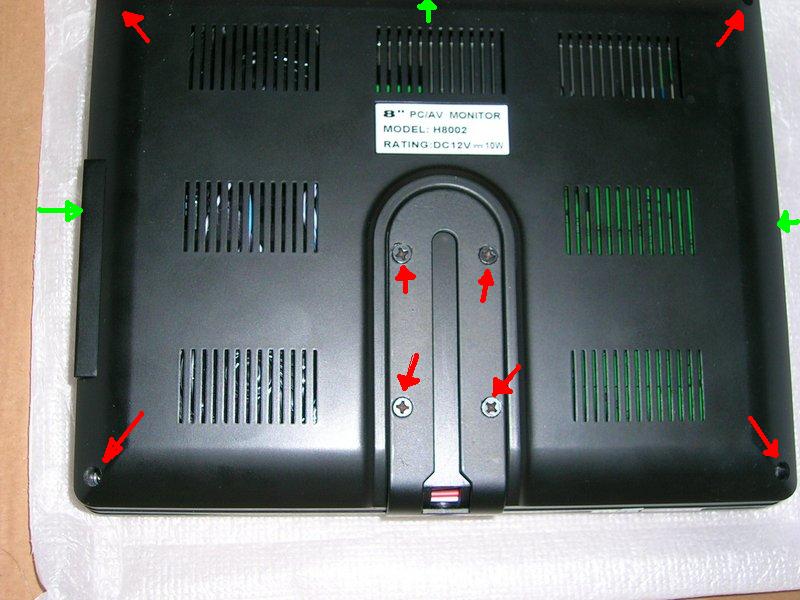

here's some photo's of the Hami being disassembled. Hope it comes in useful to people thinking of getting one
take off 8 screws (red) then part the front and back of the case. Pushing in the middle of join (green) at four sides helps.
