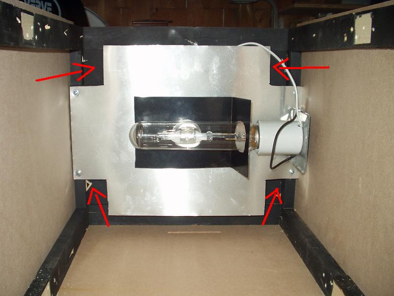

just a small question
exclusiv online gives the following distances
Reflector + 1mm to HQI + 23.85mm to condensor + 136.15mm to fresnel + 285 to 330mm to objective
as i understand it the 1st fresnel (fl=160mm) should be 160mm from the center of the light source. from the avove distances does that mean the condenser should be 23.85mm from the center of the light?
>about the distance from the second fresnel to the projection lens i've decided to do is make the projection lens 330mm away then shorten everything if i need to.. better that way round than trying to enlarge the box.
if by condenser you mean pre-condenser not the fresnel but a glass lens, then you want it only a few mm away from the outer envelope of the light source, depending on the FL of the pre-condenser. Mine has a FL of 305mm and is about .5 inch away from the light and it covers the entire condenser fresnel+ so I can move it a little bit. But you really do not want to put an acrylic fresnel 23mm away from the light source (it could melt/warp). My condenser fresnel (the 1st fresnel in the setup) is going to be about 19-21cm away from the pre-condenser lens.

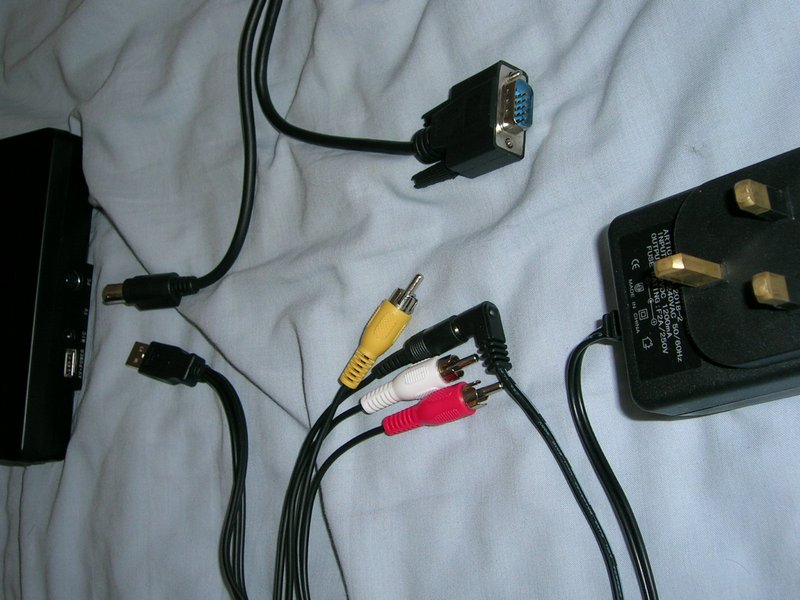

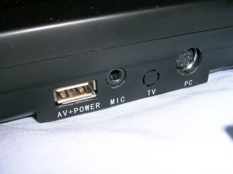

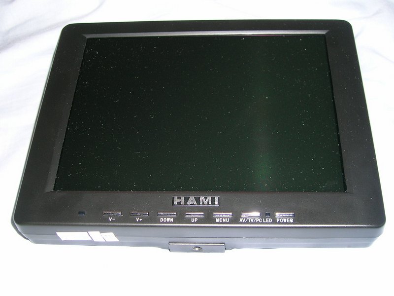

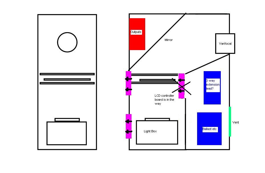

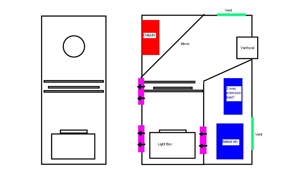

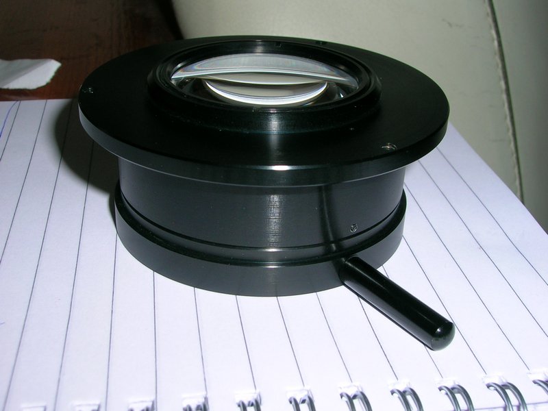

dismantled the Hami yesterday to get some accurate measurements. to anyone thinking of getting one of these its not too hard to do. only problem was some of the screws were really tight (broke one of my new screwdrivers and had to drill it out). might post some pictures later

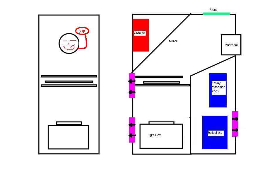

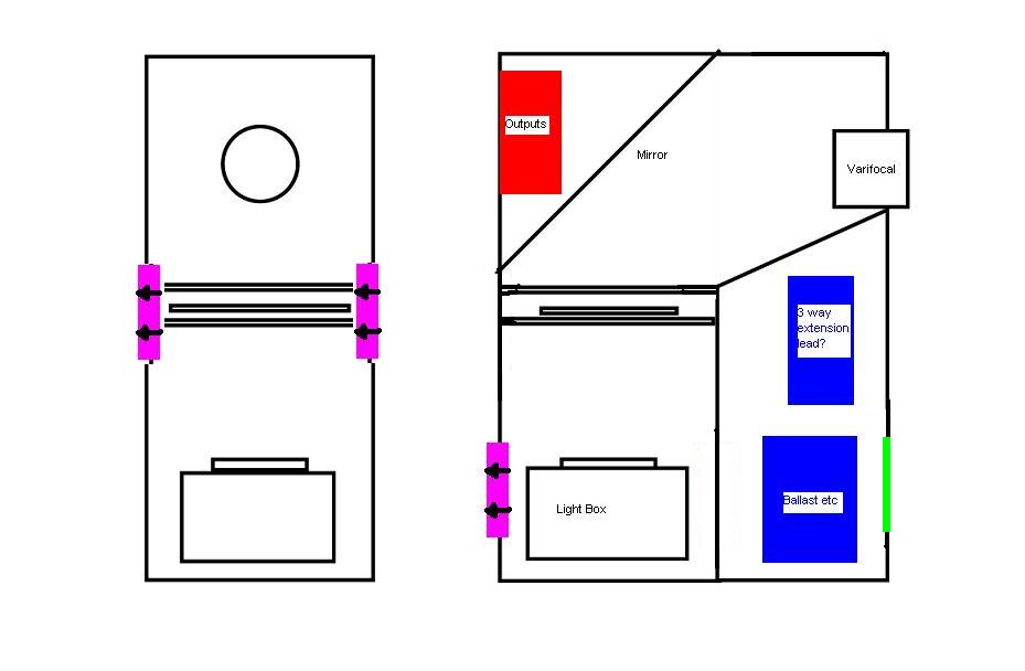

argh...my lighting and mirror plans have fallen through..
anyone know of any places i can get a 250w metal halide set up here in the UK for a reasonable amount?
a front surface mirror would be useful too but if i dont get one i'll change the design.
