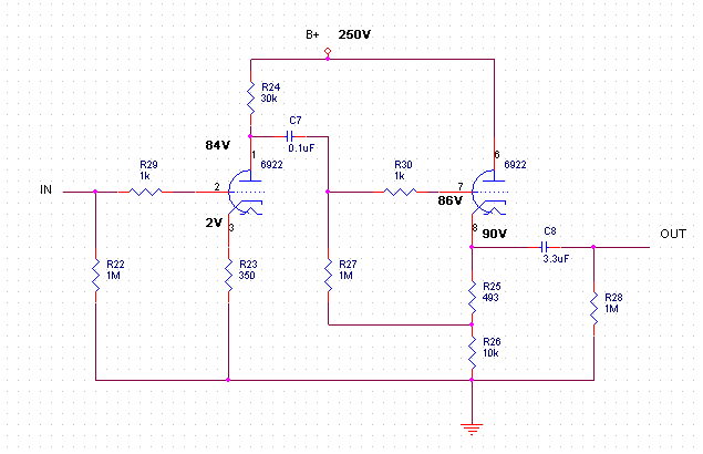

A very nice and clean project indeed!
I have one question though, why AC coupling? You can just replace C7 and R25 a with a wire and remove R27.
BR,
Anders
BR,
Anders
Finally someone who noticed the totally weired and unnecessary components that will only degrade performance.
I like this one.
If I will make me one 250 Volt DC supply I try this!

I attach your schematic, if you do not mind.
I got it from your website:
http://shine7.com/audio/6922_pre.htm
regards 🙂 lineup
