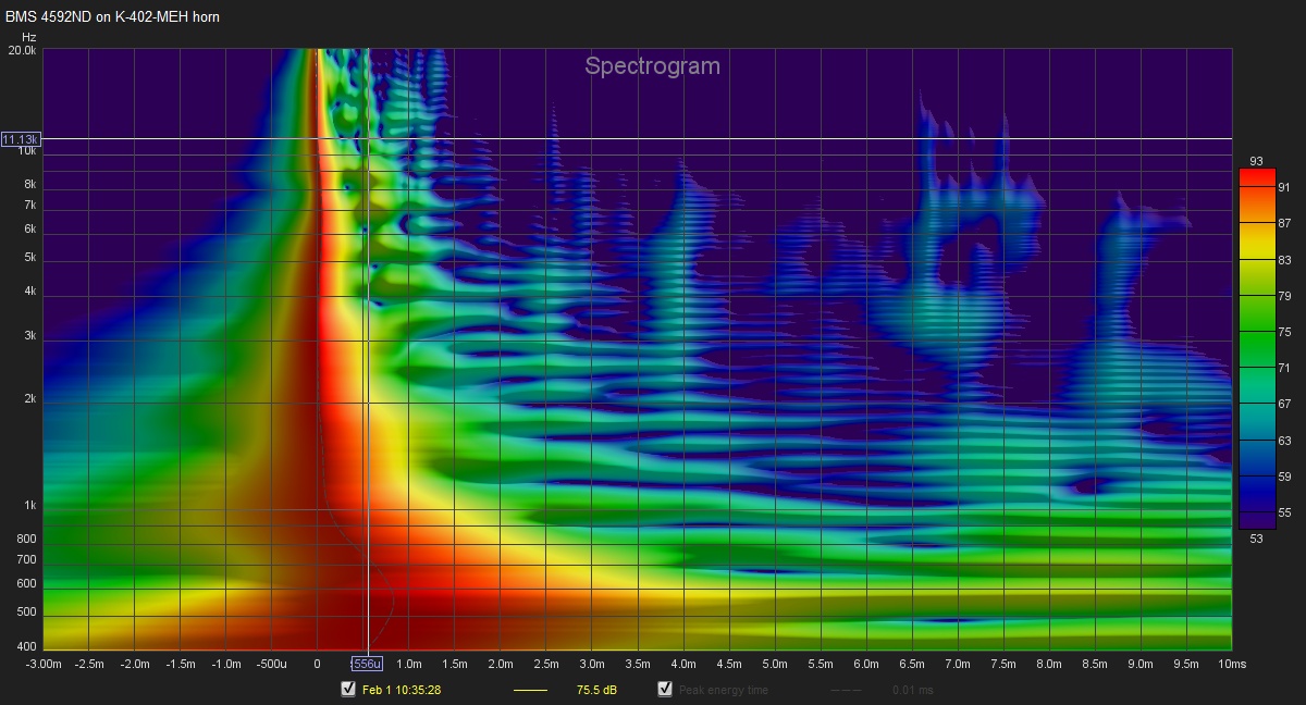

What resonance at 3K?
I think that you've probably got horn issues or dialing-in issues instead. Same thing on your "narrow dispersion >6k".
I'd be careful about giving such comments without some sort of evidence to back it up.
In case you might want to know my experience (and I'm not hopeful on this point), the BMS 4592ND can subjectively perform almost identically to a TAD TD-4002 (the TADs of which I've owned for over 10 years now). I was flabbergasted how well it performed...but only after it was dialed in well.
Chris

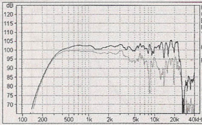

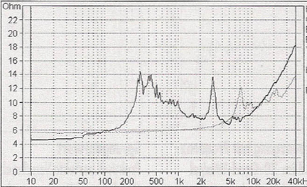

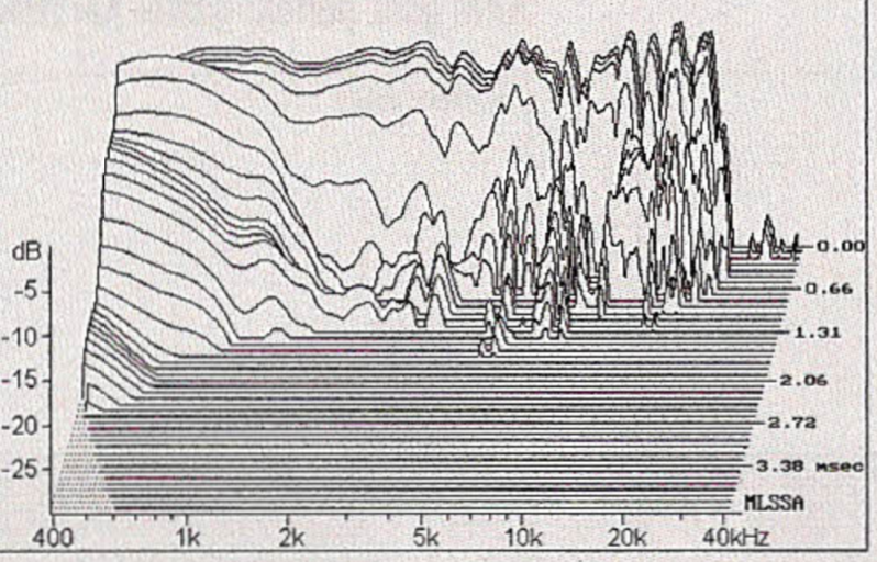

Hi Chris
Sure I made a lot and very intense experiences with the BMS.
Attached measures of standardized environment, all professional anchoic MLSSA etc. You see in the response the 3k bump may not look so threatening yet, rather like a "forward" tendency (though 3k is a sensitive area).
However, as we experienced - it was still being FIR equalized to absolute flat ! - the harshness was more audible. The impedance peak as you see unveils the cavity resonance. After we notched that out, it got actually very nice, I admit.
The problem with notching is that when the temperature or moisture changes, resonance change. And even though I can use FIR, I still prefer clean drivers.
The tweeter as you see (and those measures are smoothened already) is anyway rugged all over. The off axis too (its 30° here).
I dont say the BMS is not an excellent performing hi-end driver. But on the top notch level it doesnt compeed. I have the TD 4002 as well and would say its much better resolving - IF (IMPORTANT) used with separate tweeter 🙂 I would never run the 4002 till 20k. Its not good highs. Better take 2001.
However, the Radians are excellent too, and with separate tweeter Andrew made a good choice.
cheers
Josh

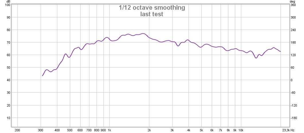

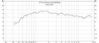

I measured radian 950 in k402, it has slowly decreasing frequency response and can’t play over 10khz without EQ, directivity over 10khz is also not acceptable.
Andrew, have you run polar measurements of the Radian 950PB on the K-402? I'd like to see your data if you have. My checking measurements showed good performance of greater than 30 degrees off-axis at the -6 dB point using that driver, IIRC.
The single driver/horn aperture completely avoids the larger issue of lobing due to vertical separation of having two horn mouths at such high frequencies (6+ kHz) along with the phase growth and audible group delay that accompany that large vertical separation distance, i.e., 6-7 wavelengths at the crossover point. A little upstream EQ--which you must use anyway if using controlled directivity horns--easily corrects the 10+kHz SPL. Ref. KPT-942 configuration with either a passive or active crossover (the active version being commercial cinema THX certified).
Have you thought about adding a second 15" woofer to reduce AM and FM distortion further relative to the capability that you have on top, i.e., the K-402? There is a fairly large mismatch in capability there.
Chris
Sorry but I don’t have much experience with measurements Here’s measurement of radian 950 in k402 Measurement is made on axis, from 1m in avarage 20square meters room SE tube amp was used, so it may be not correct I’ll try with classic stone amp later I was considering about adding second pair of woofers, but i see some issues there... Radian is 8 ohm, 15pr400 is 8ohm. If i use woofers in series I would get 16ohm load but lower efficiency If i use them in paralel I would get lower impedance which is not good for tube amp But for now i need to solve issues with my 15pr400 Tried them with 10watt tube amp without enclosure and they sound absolutely bad😱 Seems like I should bought maxonic l401a which is rated as 60watts max and with resonance frequency 25hz

Thanks for the reply. I understand about the dual woofer impedance issue using tube amplifiers that don't like really low impedance loads.
I'm not sure that you got anything that you wanted from your questions, but I did want to present the KPT-942 two-way configuration for your consideration in a way that was understandable and believable. The logic to doing it that way isn't commonly understood among the DIY crowd...but I didn't learn how to do it that way from DIY people. I instead learned it from the lead Klipsch engineer--from Roy Delgado himself over a long-term low level tutelage.
Also the bad press on the BMS 4592ND is just that--fake news in my experience. However, if you're not going to use a DSP crossover, perhaps the way that you're going with your separate tweeter will be almost as seamless. Be careful of the phase shifts of passive crossovers plus the time delay of the mid driver on the K-402 vs. the FaitalPRO horn/driver. The K-402 horn is so resolving, you will hear timbre shift issues if you don't correct the time delays by some means. The best that you can probably hope for is "phase alignment" instead of time alignment i.e., the K-402/Radian combination is one or more multiples of wavelengths behind your tweeter/horn at the center crossover frequency--just like Klipsch does it in their Heritage series of loudspeakers.
