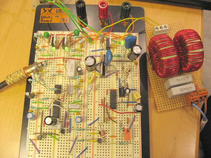

stereo diy
finally a stereo ... still looking for identical gapped ferrite cores for coils as output filter/s...
after puting it inside a casing, I will experiment on bridging them...😎

Hi RX5
That's really a nice job 🙂 Congratulations 😎
What is the switching freq? (you probably already told us somewhere in the post).
Are you using LM7812 for high side supply?
Looking forward to hering the first feedback on the sound from the stereo pair 😉

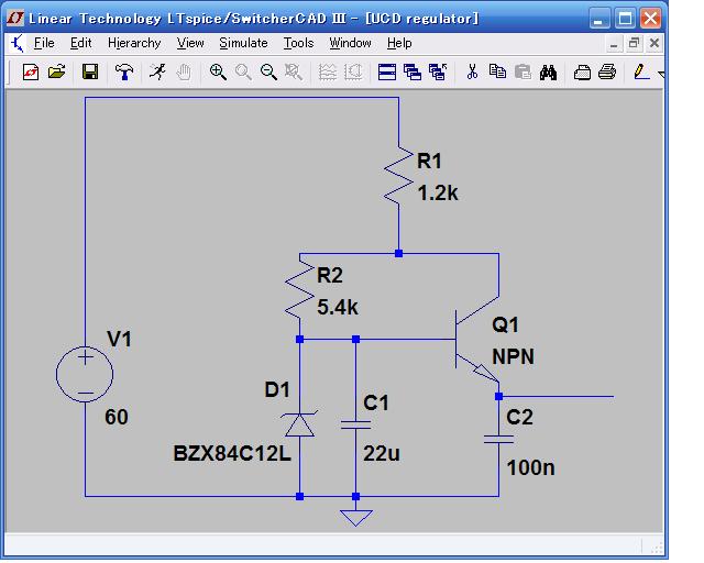

I'm trying out an LM317 for this job, and it seems that it heats up quite a lot more than the LM7812 types that I have used in a similar circuit 😕
I have also used LM317/LM337 for the oscilator circuit and these heats up even more??
The osc i based on a LM319 using 2k2 collector resistors driving +-12V at 250 kHz.
The input voltage is only +-30V ..... any one have some similar observations? Maybe these regulators are more "unstable" or something .... but I guess thaese are used in many other switching applications .... 😕
Have tryed decoupling with small caps, large caps, and placed colose to the regulator and further from etc. ... no change.
I'm considering making the regulations with descrete components instead .... might do a better job ..... or even making a pre-regulator .... but then it seems a bit too complex and a bit too much!

Hello Baldin,
nice to hear your doing the UCD diy way...
using 7812 and other 3 pin IC regulators ... never tried... max input is only 35V(i think) check datasheet...
anyways, UCD uses discrete regulator to power the op-amp buffers/start-up delay.... 🙂
ghemink has posted the circuit somewhere in this forum... its a series pass transistor regulator.. using darlington type/s....
ok here it is....
im using TIP102/TIP107 for the regulators... kinda overkill 100V/8A 😀
Hi RX5
Yes the LM78xx are quite limited with regards to input voltage, but the LM3x7 cna handle e difference of 40V between Vin and Vout.
I thought the integrated regulators would work better especially for the input stage due to the much higher ripple rejection compared to a simple discrete circuit.
But now I'm not so sure 🙁
Think I'll try a discrete regulator. Think it's a good idea to use a darlington as it will provide a much better ripple rejection without using more components.
It's actually not for a UCD. It's using a bit different topology, but I will try to take some feedback after the filter.
hi,
the regulator will have quite high difference for Vin and Vout. Hence you must consider, let say for 1A from 35V to 12 V will dissipate (35-12)W. That's why the regulator is getting hot. Using chip or discrete are same since chip also do the same way to drop the voltage.

Kartino: After a bit more thinking, you calculation is also only valid for DC I think. Here we're talking about relatively high frequencies at moderate currents.
To get the higher ripple rejection the chips uses higher feedback, and it might not be entirely stable . Or it might a bit too well at higher frequencies, not limiting the current well enough. Driving square waves could produce very high peek currents in the regulator, if the bandwith is too high and the current limit is not adequate. This could very well heat it up quite good.
A discrete circuit will not deliver as high ripple rejection and might not work that well at very high frequencies, but it might do the job better not heating nearly as much.

Baldin said:Kartino: After a bit more thinking, you calculation is also only valid for DC I think. Here we're talking about relatively high frequencies at moderate currents.
A discrete circuit will not deliver as high ripple rejection and might not work that well at very high frequencies, but it might do the job better not heating nearly as much. [/B]
Are we talking about regulator for gate driver for the diy ucd? If yes IMHO the regulator is nothing to do with switching frequency since the output connected to quite big caps, for higher and low gate. you can simulate that the load of regulator is almost flat at DC.
What kind of chip did mentioned, linear or switching. If you find simple switching chip, it will be better. There are some step down purpose ic for high dropping regulator.
