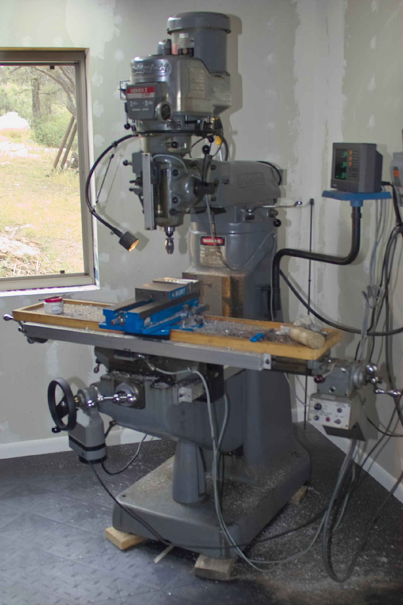

1) My Bridgeport milling machine with which I made most of the parts.

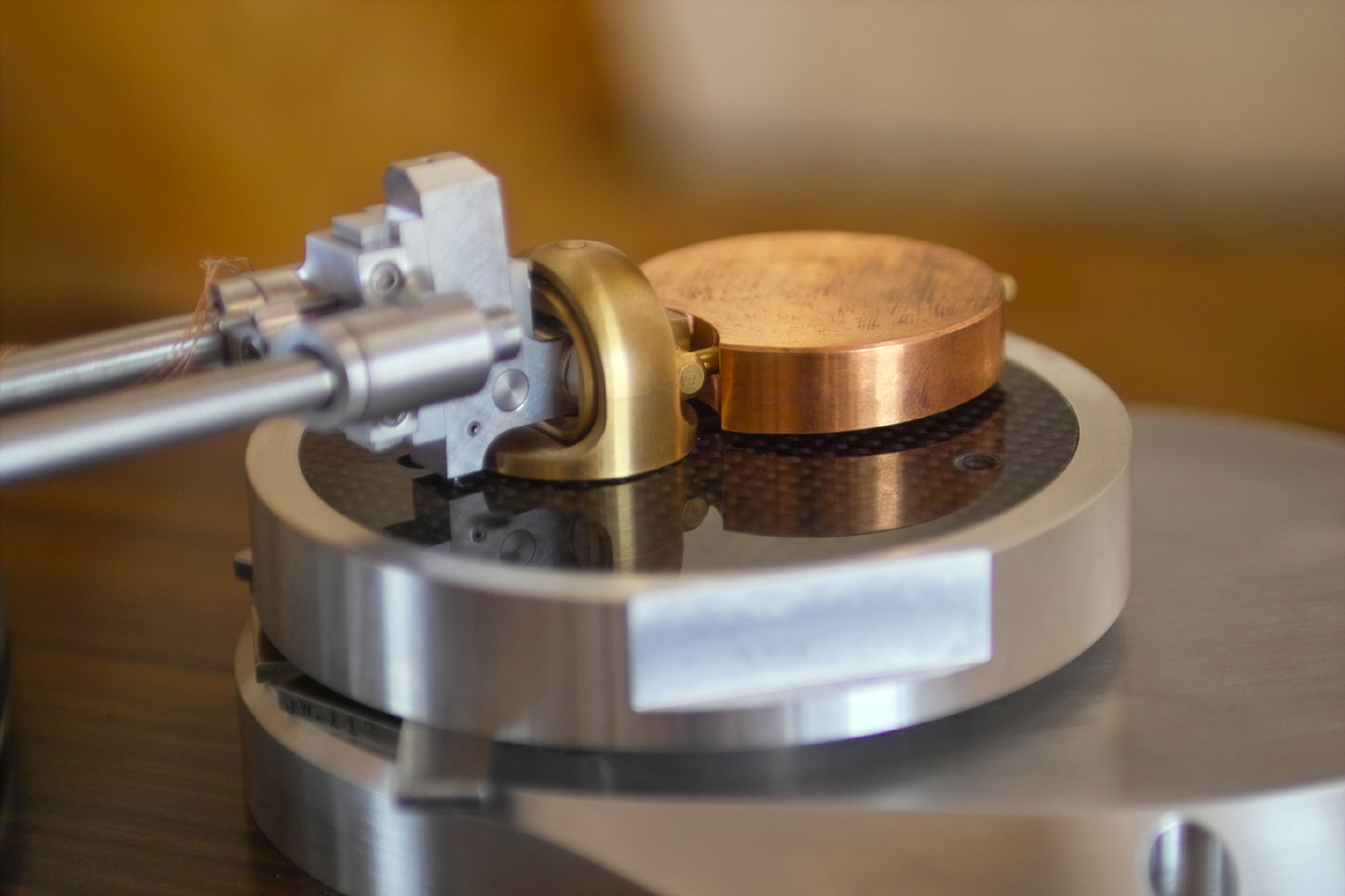

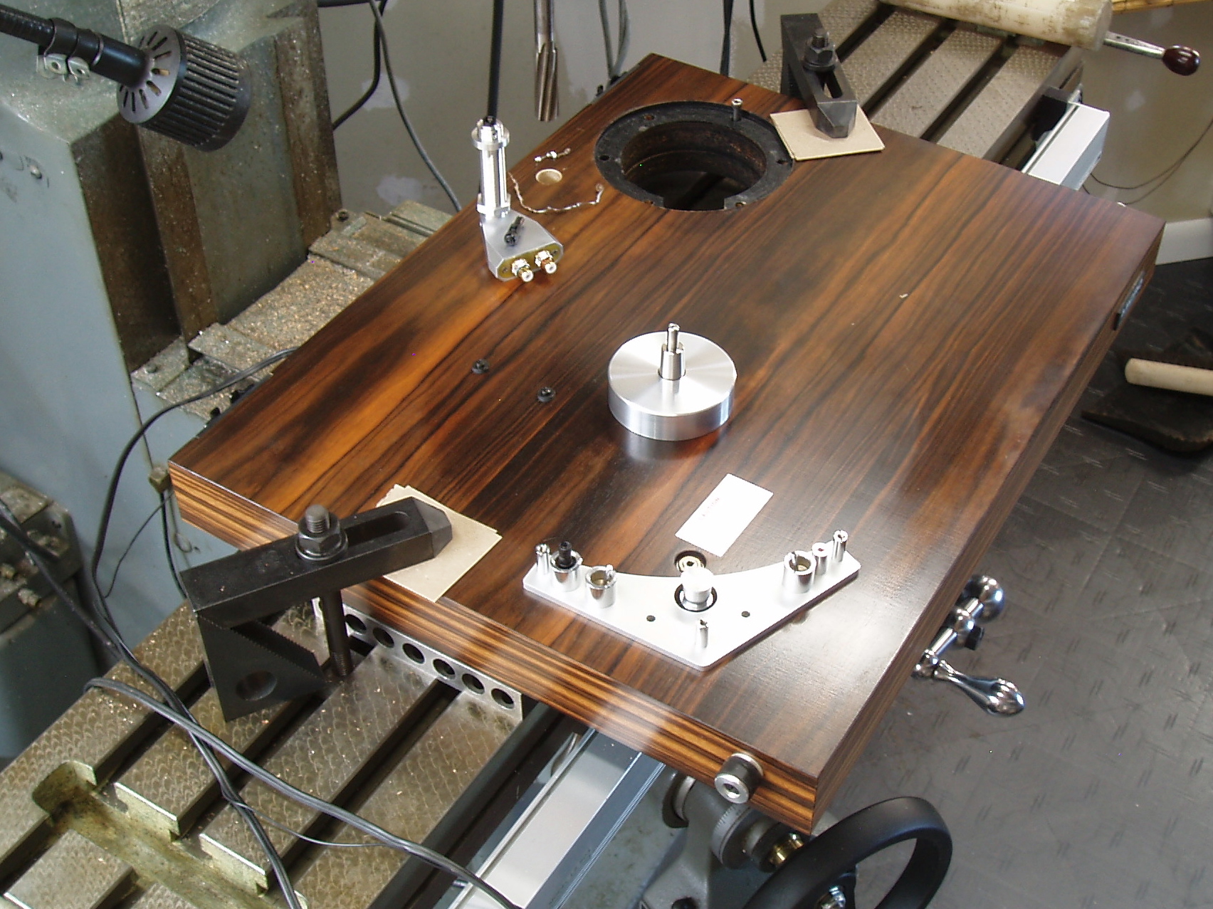

2) My Micro Seiki turn table being machined to accept the tone arm’s DIN connector.
3) A close-up of the above. Note the lead chip from the layer of sheet lead in the base.

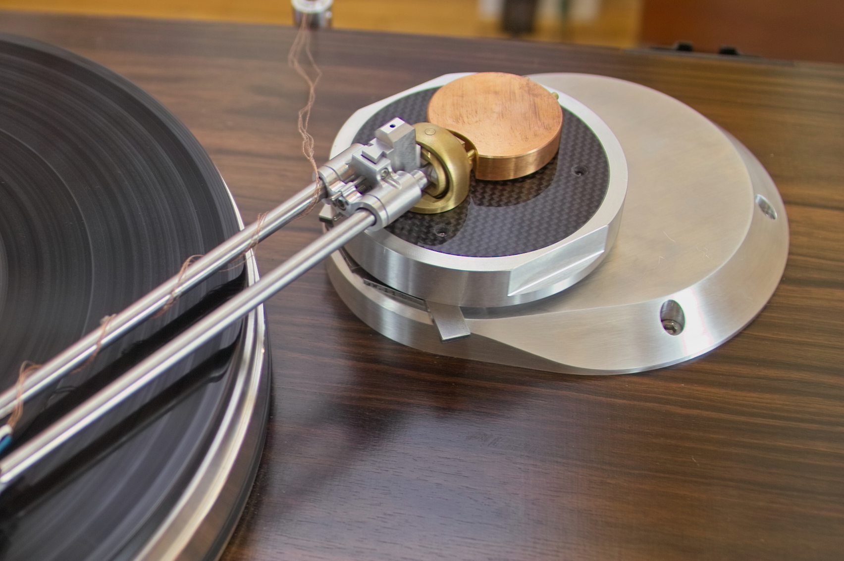

4) The tone arm overall. (minus head shell)

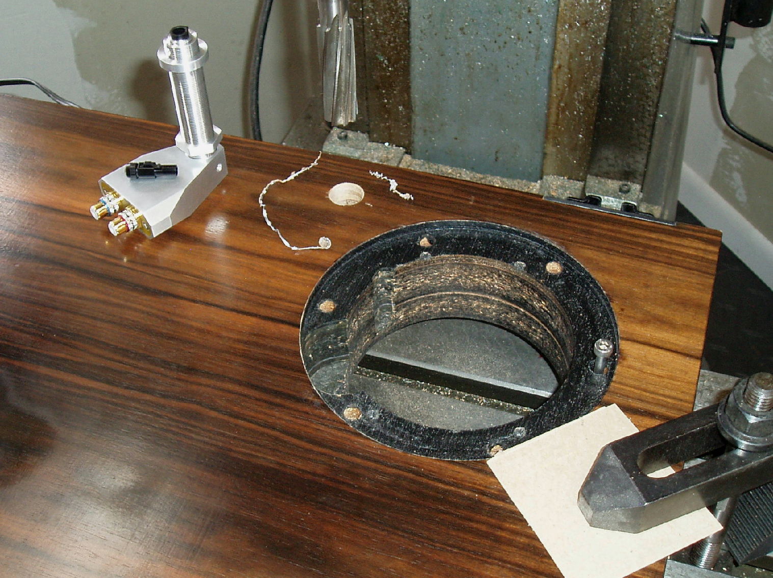

5) The tone arm base and carriage.

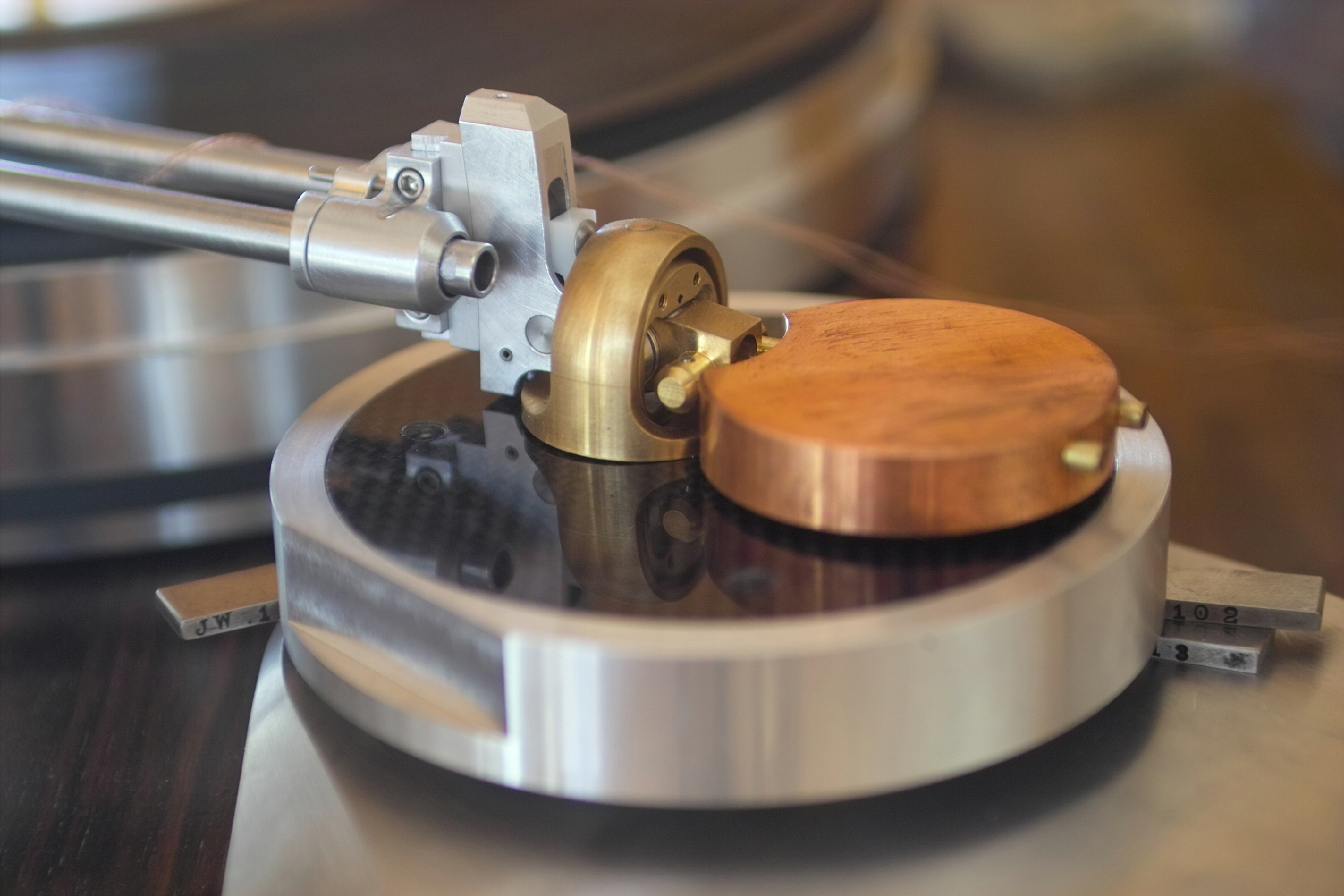

6) As above.
