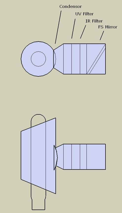

I'll try and make a google sketchup of my lightbox, but basically the light hits an FS mirror before it reaches the fresnel. In that path I have my UV and IR plate glass filters and a couple fans in what I'm hoping will be a kickass reflector! (I used some of that "solar lighting" ductwork to make it) Doing it this way I could keep my filters quite small and hopefully pump out almost all the heat from the light.

By the way, a while back I mentioned I'd put a sketchup of what I've gotten completed so far. 😛 I fiddled around with it today and produced something almost legible. :cannotbe:
I'm not sure exactly how well it'll work in the end, it looks pretty nice sitting on my shelf though. 😀 There are fans covering both filters and the bulb itself, so hopefully I can keep the whole thing cool enough not to crack the condesor or the filters. The material is made from one of those ceiling mount solar light fixtures and is an almost perfect mirrorred surface, I just hope it stands up to the heat of the bulb. Also, I have yet to see just how much heat the whole thing will remove from the light. The dimensions in the picture aren't to scale of course.
Anyhow, lemme know what yall think. Hope ya'll don't mind me sticking this in this thread, figured since it was brief and we've been talking about such things it was better than starting a whole new one.

Hmmm, in your diagram is that 11 3/4" from the arc to the lcd panel? Would that adequately cover your collumating fresnel? Using google to convert 330mm to inches gives me back 12.99" in distance. Where are the more experienced when you need them eh? 😀
Did you have any plans for UV and IR filters?
Thanks for pointing that out Dovienya, I do realize that 330mm = 12.99 Inch.
However, I am sorta sure, sorta unsure of how I am going to place the bulb and the cooling deviecs yet. I will see how much difference it makes with an Inch or since my wood is already cut to 20x40 😉
As far as the cooling goes, I got the Pro Reflector from LL so that should hopefully take care of that 😉 I will only find out the reality by testing it so I'll tweek it as necssary.
