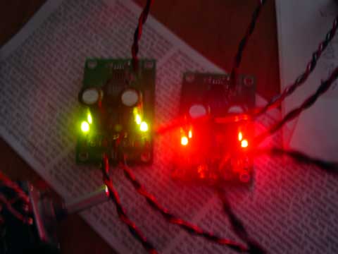

How's this? I ran out of blue so I had to use red and green on my test modules. The green ones need more current to be at a similar level of brightness. I still prefer the red or blue LEDs, even though the blue ones are a lot more expensive. Blue is a more soothing color and is generally associated with cool things (temperature wise). Since the chip runs so cool it only seems appropriate 🙂
