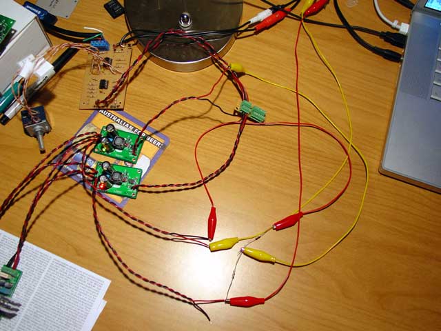

Would it be possible to bridge two modules? If its possible, would you recommend against it for any reason?

Hi anonymous1. It probably is possible to bridge two modules but I haven't tried that yet. I will when I get the my two testers built up.

In other news, I have successfully bridged two D10.1 modules! That's right, they're capable of being bridged and it's actually very simple to do so. All you need is a couple of resistors (and some alligator clips leads if you want to jerry rig it like I did).
There is definitely more power available as one would expect from a bridged configuration. I couldn't turn up the volume the whole way to see where the waveform clipped because it was too loud being within a few feet of my 90db 1W/1m speakers 🙂 I'll hook up my power resistors, find another scope probe, and see what kind of votlage swing the bridged modules are capable of.
They still sound very good, although there is a more noise... but most of that could be due to the feedback resistors right on top of the output wires, the alligator clip connections, and a ground loop
