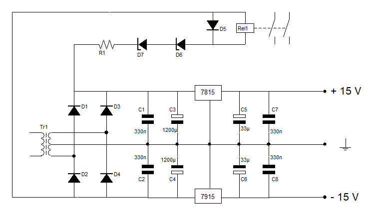

I also think that te circuit to drive the relay can be made cheaper , in circuit below select the relay an the zener diode so that pick-up voltage will be above minimum input vottage of regulators, so relay will pick up only if regulators are working..... This will not give any delay but should be tested.
Yes that's a great idea but place it after the regulators then both rails have to be definitely present for the relay to operate. Adding delay could be done with cap and diode added to the relay arm of the circuit.
No I would keep it as is and calibrate for 15 + 15 + 3 +3 = 36 volts so relay will pick up only after both regulators are working.

But that doesn't check that the regulators are actually working. Only sensing the voltage after the regulators can tell if one or both have gone into thermal shutdown or short-circuit protection, or just fallen off the board(!)
