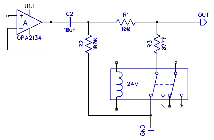

Muting opamp outputs
A resistor of at least 100R is compulsory at the output of any opamp driving a cable. It does not need to be added just for current limiting.
Depends on the opamp - check the datasheet (its not always quoted though). 100 ohms works with many, but some can drive down as low as 0.2 ohms into highly capacitive loads (THS4281) - useful for generating precision low-impedance voltage references, 0.2 ohms straight into filtercap into an ADC reference pin, very low impedance reference from DC to daylight.
Almost all opamps have internal indefinite current limiting. Can't think why, they'd sell so many more if not (!)
I made something similar in my '' basic preamp '' it work and I dont expect any problem, The circuit short to ground the output via a 100 ohms resistor, most of the time the preamplifier is set to give at the output a voltage below 1 volt to have a usefull sound level so current is limited to a few mA for only a second or so . See ''basic peamp circuit '' thread.
I have OPA134 application note and in '' absolute rating '' it is written : Output short circuit to ground..... one amplifier per package ...... continuous.

No I would keep it as is and calibrate for 15 + 15 + 3 +3 = 36 volts so relay will pick up only after both regulators are working.
At shutdown OP-amp makes problem when voltage is very low and polarisation is about to give-up and you get oscillations.....
