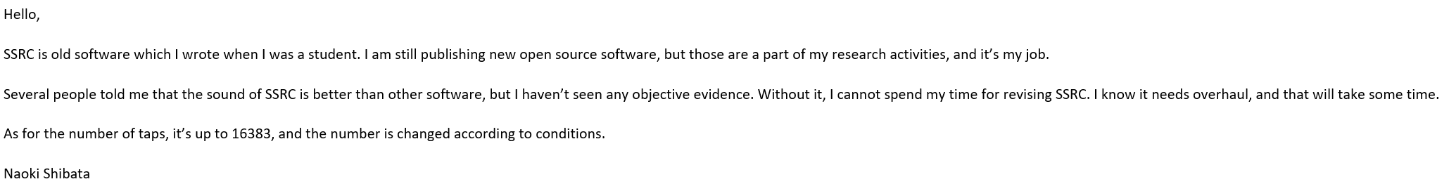

And how many taps did it calculate on?
16383.
I replied with questions about possibility in increasing filter length and whether it might theoretically improve performance.
