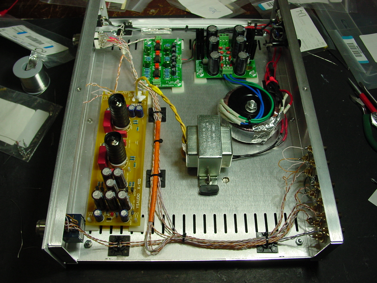

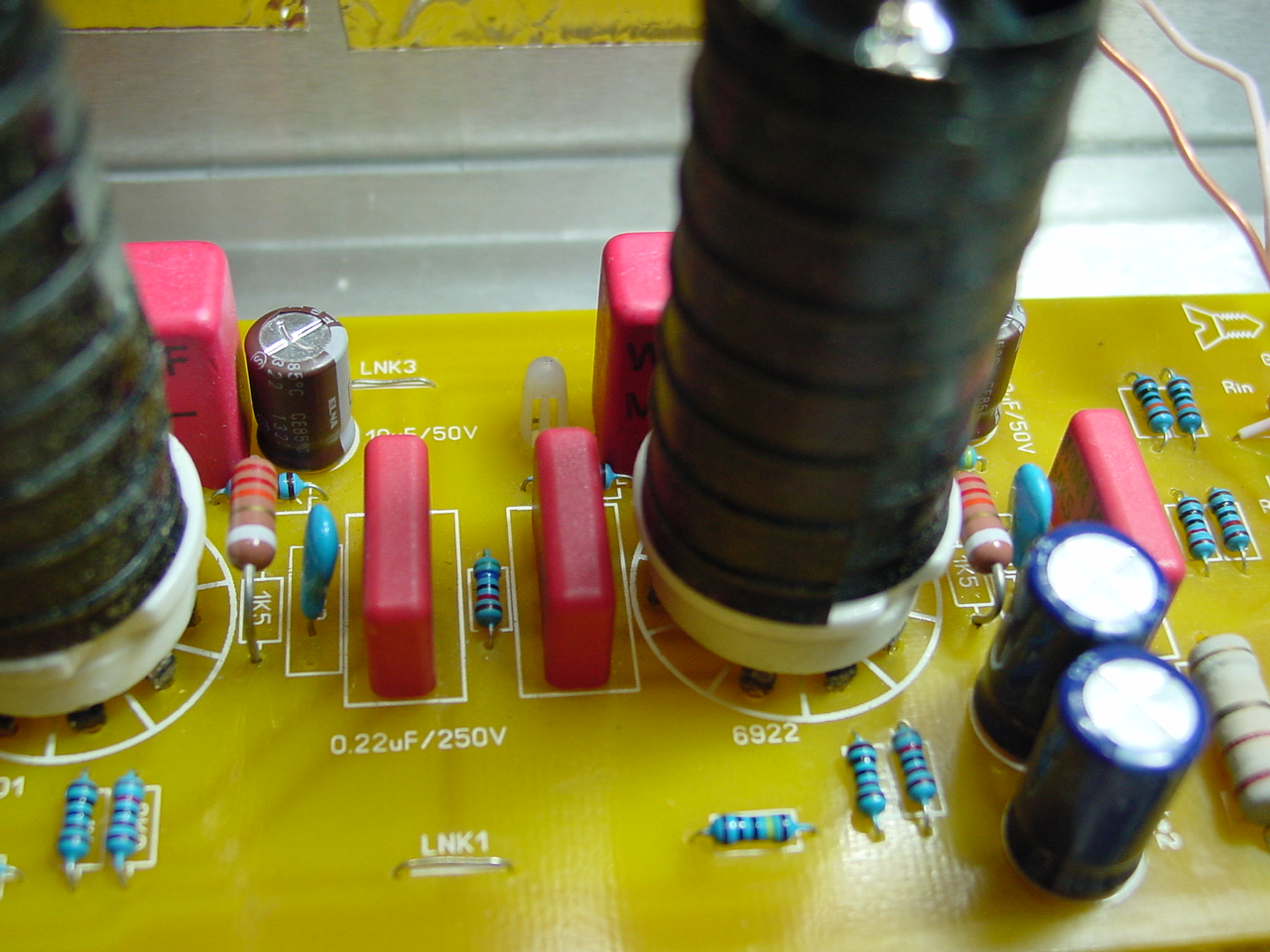

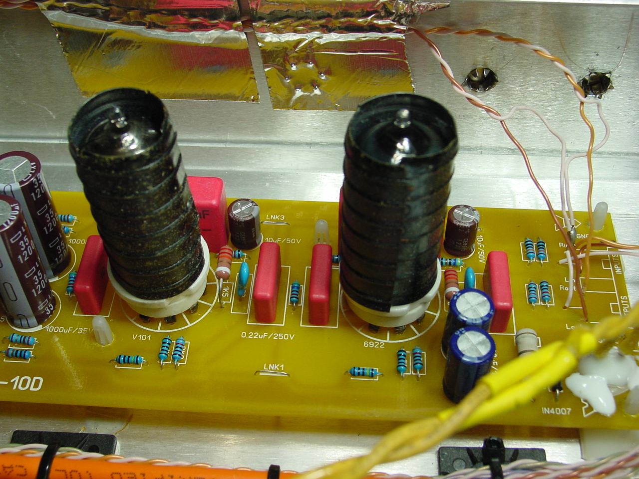

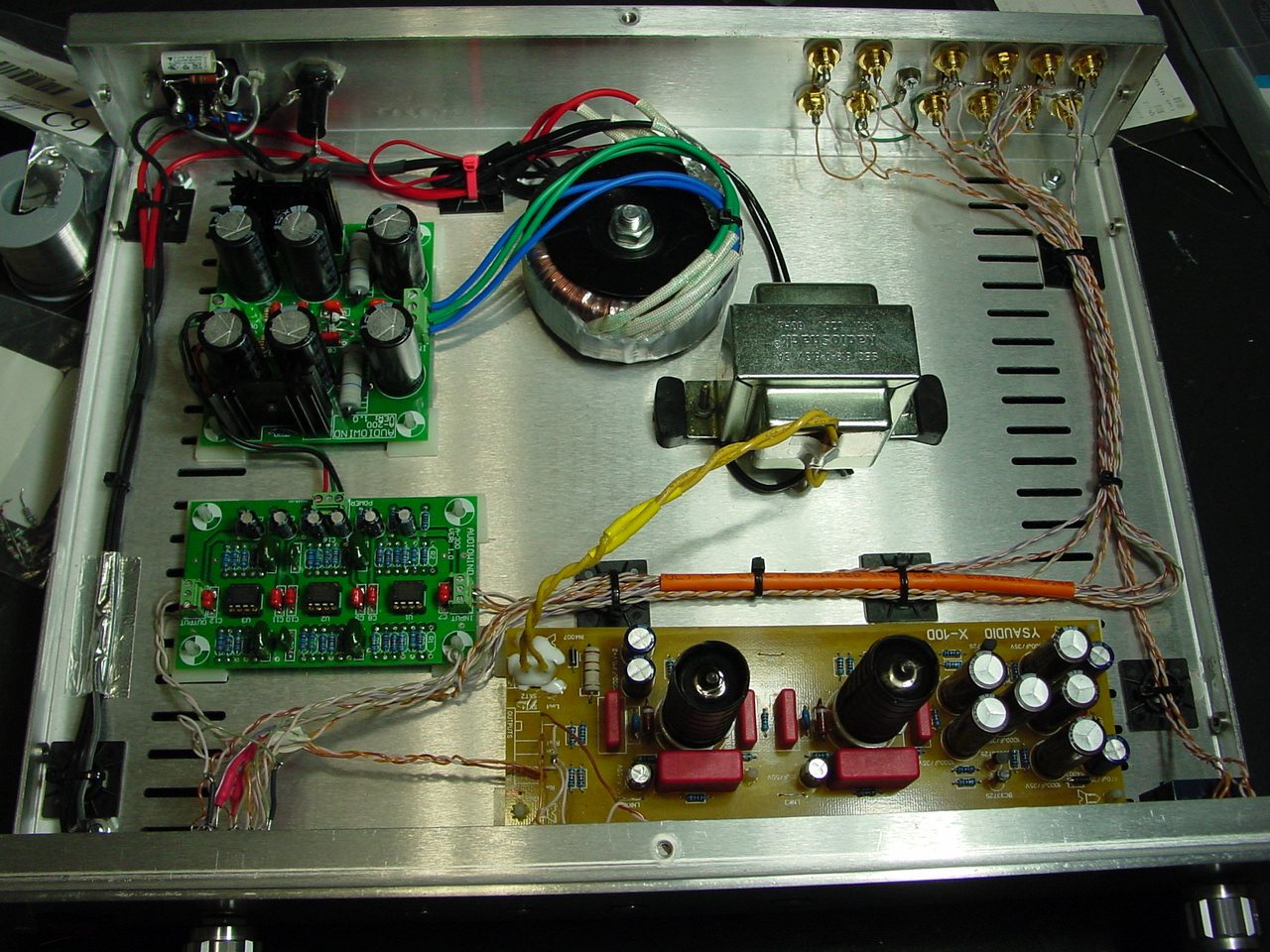

I have a X-10D copy that I wanted to use as a preamp, so .98 gain was not an option. The 1.5K ohm resistors got replaced with 22K for the almost 6X (5.68) gain in your formula. Works very well! I tried replacing with 47K ohm resistors first, but there was a bit of distortion--too much gain...not enough feedback.
Some pics follow, I only had bigger 22K resistors as you see pictured. Also, there are British Mullards under the shields. Very nice performance.
Would advise anyone using this buffer in this form with a volume control, consider replacing these feedback resistors.
Also replaced the 10 uF / 50 V electrolytic caps with ELNA Silmic II. Someone said earlier that is was an improvement to do this.
Thanks for the tip.

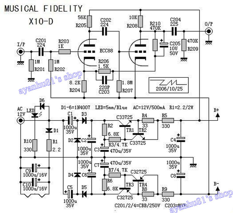

Referring to post #7 by coolmaster which contains circuit diagram.
I recognise the circuit in lower half as diode pump (walton cockroft full bridge rectifier) to generate higher +/- dc voltage supply, but what is the purpose of the two transistor circuit in each supply rail?
I've used the circuits posted earlier and traced through a Chinese clone of this as well as looked at boards (on ebay, some of which have errors!) but here is what I believe to the definitive circuit for the power supply i.e. the lower half;

You'll notice that also the starved plate voltage of only 5V (compared to 23V for 6n3p), the idea is to achieve very high gain, but also need to be driven (even into positive region) by low impedance source. There is about 30 db NFB so distortion is reduced to reasonable level. Sonic wise it may sound very good. For 6N3p you may need to starve plate voltage some more by increasing the plate load resistor, if it does not sound as good as ec88, I think.

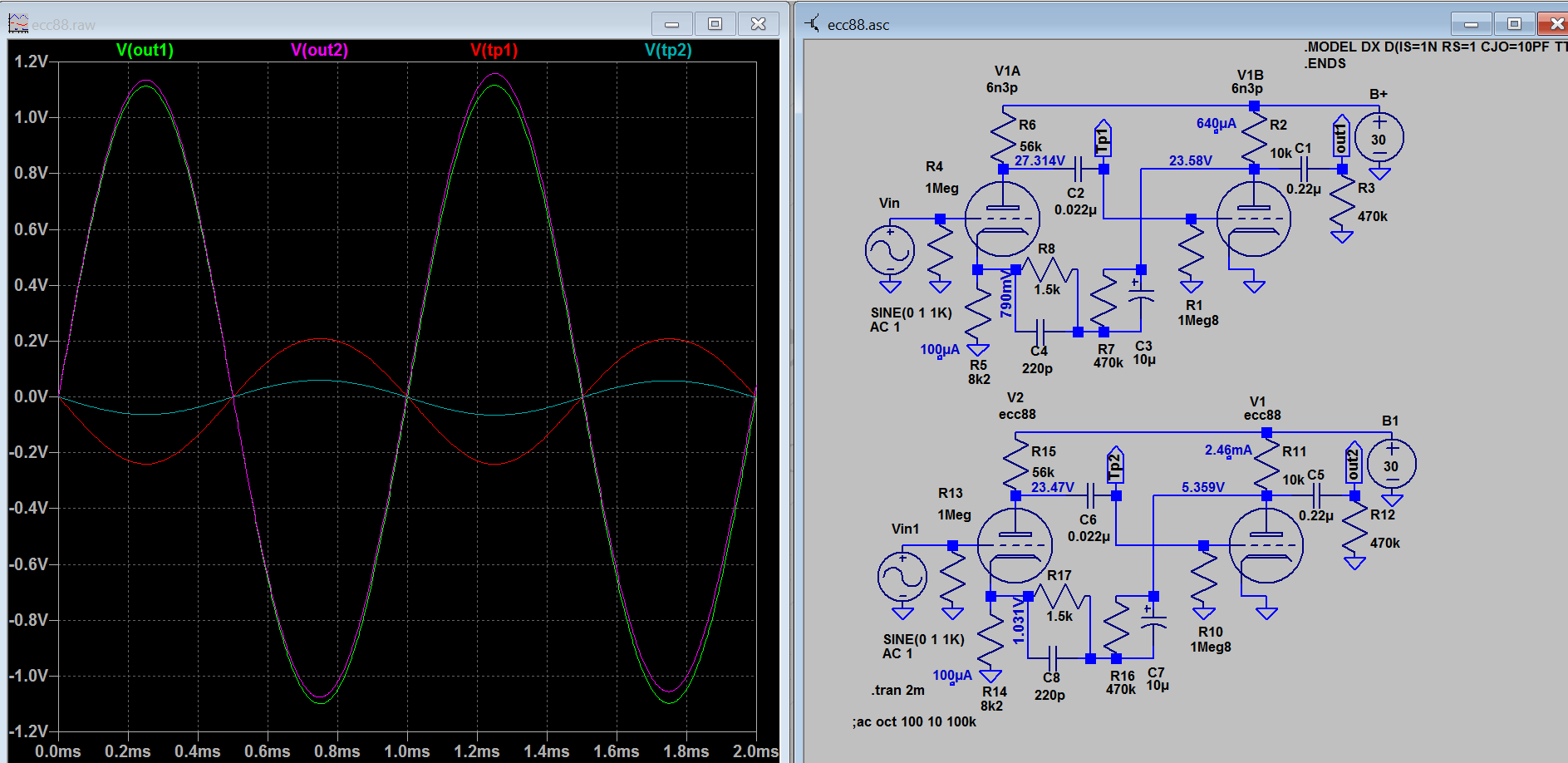

Hi Koonw,
I was not intending to go so low on the plate voltage. I would appreciate if you can review my simulation with split supplies. The cathode currents are around: 246 uA and 1.16 mA respectively.
Total Harmonic Distortion: 0.011166%(0.023670%)

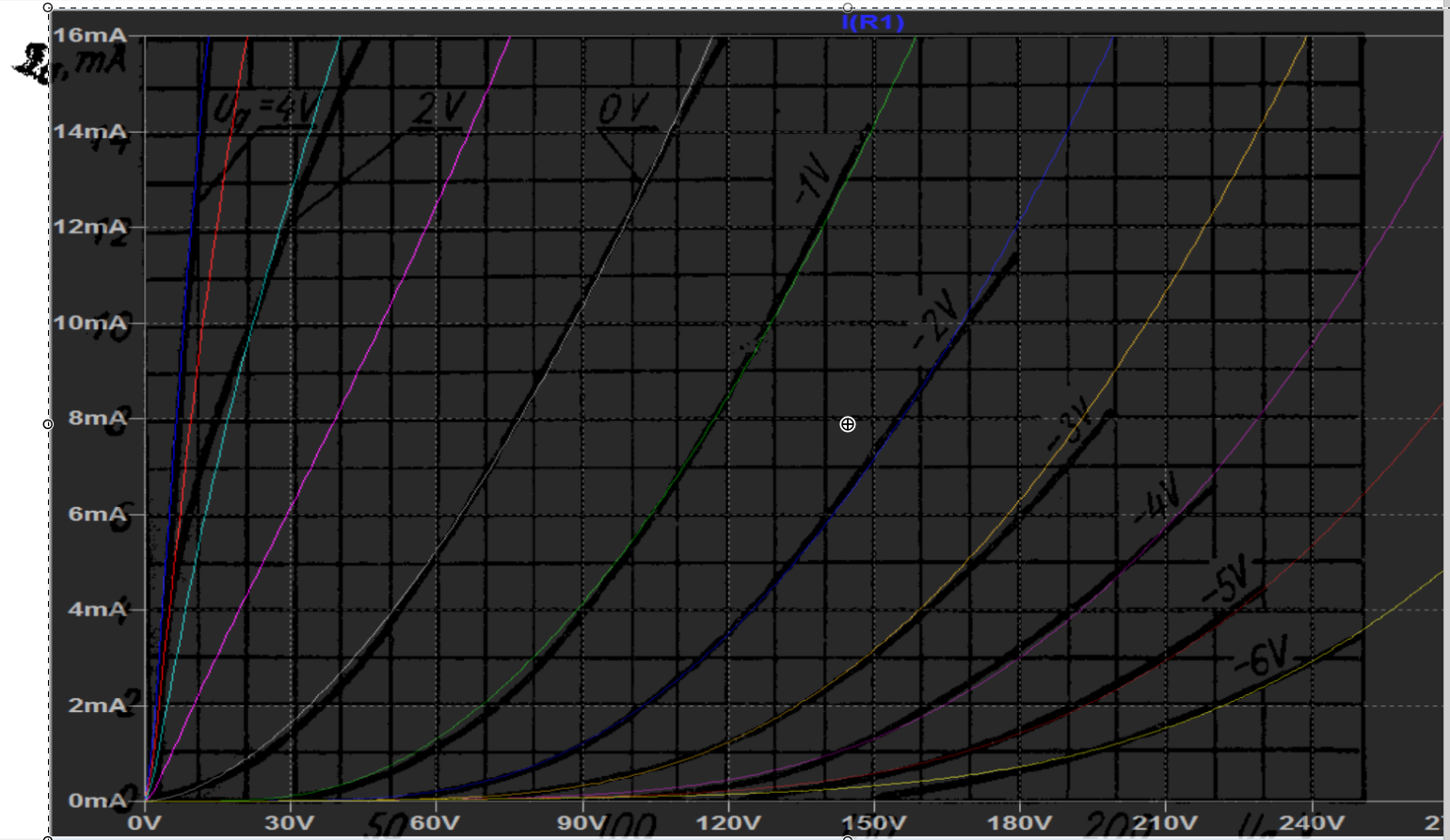

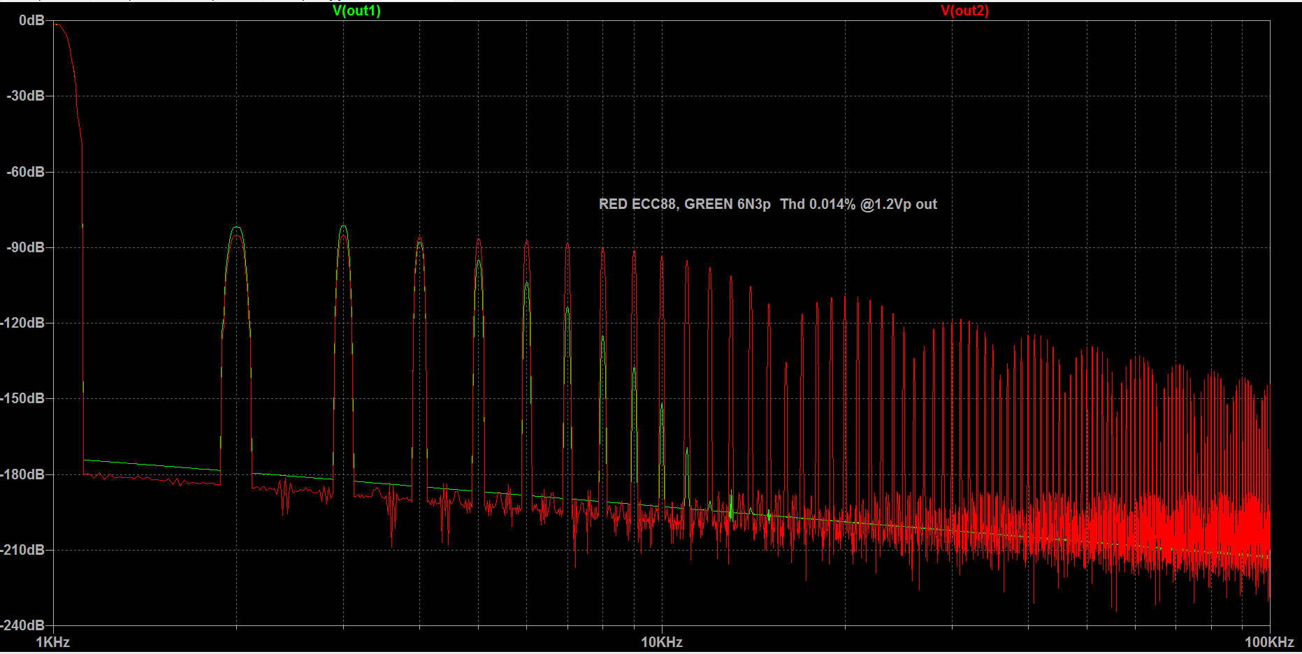

Using your sch, I step the value of cathode resistor and found least distortion at 40R for 6n3p. If you use 680R, you can bypass the cathode for more NF and damping. The distortion for 6n2p is lower at 0R, as compared to ecc88. Hence the harmonic pattern are also quite different, it maybe that this distortion pattern gives X10 the good sound, so I would suggest you use a tube adapter so you can hear both tube sound. You can attach here the 6n3p model you use for comparison if you like.
Using your model I got +8V also on the plate, the actual voltage across the tube (between plate and cathode) is about 40V.
It is 12.35V on the plate, 44v across the tube using the model I have here, so just 4V higher. Can verify with the original datasheet.
