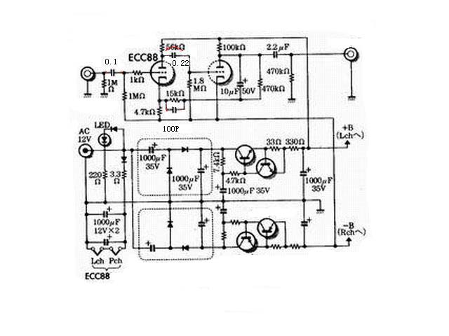

It looks to me like X10-D is not an optimal tube buffer. It is highly constrained to work on an input power source providing 12VAC for simplicity and safety purposes. To be even reasonable it has to use an on-chassis double voltage doubler, giving an ultimate 48V DC from pseudo-ground to B+. That isn't enough for 6DJ8 or many others tubes to really shine, is it? .
I'm sorry, but I think you are wrong !
The voltage B+ is not 48v, but symmetrical +- 34v , that's what I've measured on mine

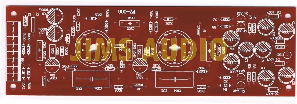

Hi guys, just finished assembling mine bought on ebay as printed circuit board with schematic and part list. While testing and measuring found with 12VAC as power supply the heaters on my EI ECC88 to be only 4.6V! I had the sound, but the heating volts were bothering me, so i raised the AC voltage to get the required 6.3V and ended up with 19.2VAC of power supply. The sound is nice and "wide" with voices and mids-to-hights up-front and noticeably less lows (connected to output of laptop and driving headphones - i've read somewhere that ecc88 has enough power to drive headphones and so i tried....worx nice - so i know i might get a different sound when connected to a power amp, but at the moment, in the middle of an ocean, this is the best i can do). I'm using Elna power caps, Solen coupling caps, Orange drop silver mica and UF4007 diodes.
Reading this forum i just found out that there should be +-30VDC supplied, and when i measure mine i read about 41 to 43VDC (due to increased PS volts). The tubes feel fine with that. But i honestly think that a better power supply for the heating should be done putting tube heaters in parallel and not in series due to a voltage drop on one valve (the difference is about 0.2 - 0.3V. And i think i'm going to do that. For the rest, for now i'm satisfied.
One more thing regarding the original design: the R1 (2.2ohm 2W) is producing A LOT of heat (practically slowly burning), either with 12VAC or 19.1VAC. This is one more reason why to design a better heating circuit - any ideas would be appreciated.
Hello !
I remember to have had a similar problem about voltage heating.
I've changed 2 x 1000uf capacitors to 2 x 2200uf
I also have changed the R1, to someting near 1.2 (not sure !)
The transformer must be about 30va .

Hi Ciu,
What do you mean by "The output caps 2.2uf are also "wrong" ? On all schematics i've seen there's 2.2uF...
Regarding the 2 resistors R1 and R10, you mean they both should be 2.2ohm?
I'm gonna try the 2200uF modification...did you change the PSU caps as well to say 2200uF 50V (or 63V)?

Sorry, my mystake
the firts time I saw your schematic, I read it "upside/down"
My post is correct now
The caps I use are 2200uf/25v, don't need to be 50v, the board is small, the caps are filtering half-wave from 12vac.

Of course the C9 and C10 are enough to be 25V, but i was asking for C6, C7, C8 (specially the latter because it's very close to the + - 30V supply voltage).
Did you get about 2V difference when measuring the L and R channel PS voltage as well?
So you reckon i should try with R1 = 1200 Ohm?

On my boards, R1 is about 1.2 Ohms.
About 1000uF caps, I've changed some of them ,It would be better to wait next week, because I don't have boards on my hands, I've mixed some "basic" caps 1000uf, with Panasonic FM 470uf, 50v .
The PSU are +-34v , totally symmetric.

B=+/-45V for baffer X10D
Hi guys!
What changes are needed to the schematics for the tube buffer X10-D if you increase the anode power supply B = +/-45V (or B=+/-65V)?😕🙄
See schematics:
Thanks for your help!
Hi guys!
See schematics:
