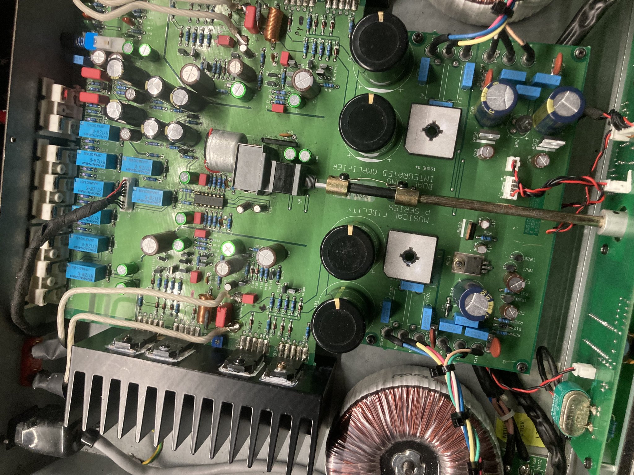

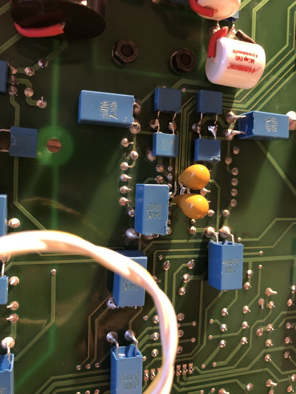

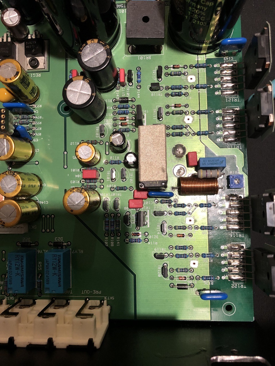

Thanks to everyone who opined to this post. I did install Wima MKS in C3 & 103 positions, and am pleasantly surprised by how good these inexpensive caps sound over the stock NP electrolytics. Indeed that high DAC out impedance imparted a very noticeable bass boost if just inserted into the preamp out RCA jacks. As was also mentioned, that combination of DAC and preamp did induce a low pass filter which rolled off the highs a bit, and the overall presentation was just too veiled and dark for my ears. So I installed jumper pins on the PC board by lifting one leg of R59 & 159, this separated per-out and amp in to resolve these issues. Severing the peamp section did the trick to flatten out the frequency response and restore lost dynamics. Why the manufacturer did not install preout/main in jumpers on the back panel as so many others do I have no clue.

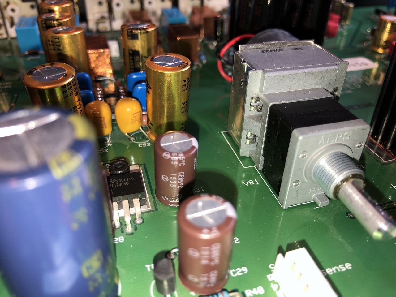

If you are going to look at alternatives, cut to the chase and obtain a pair of Sonic Imagery Labs Model 994Enh-Ticha Dual discrete op-amps. With suitable decoupling - I'd highly recommend replacing C52 & C53 with KEMET T350M107J020AT solid tantalum 100uF 20v bypassed with both EPCOS B32529C1104J 0.1uF & EPCOS B32529C6103J 0.01uF fitted under the PCB:
together with either T350K476K020AS 47uF 20v or T350L686K025AT 68uF 25v direct between supply pins and ground:
the results are simply outstanding in terms of clarity, detail, soundstage and dynamics.
I also think that overall the sound doesn't stray too far from MF original, rather shows what the amp could have been.

Given that you are not using the pre-amp stage, I have a recommendation for the output stages.

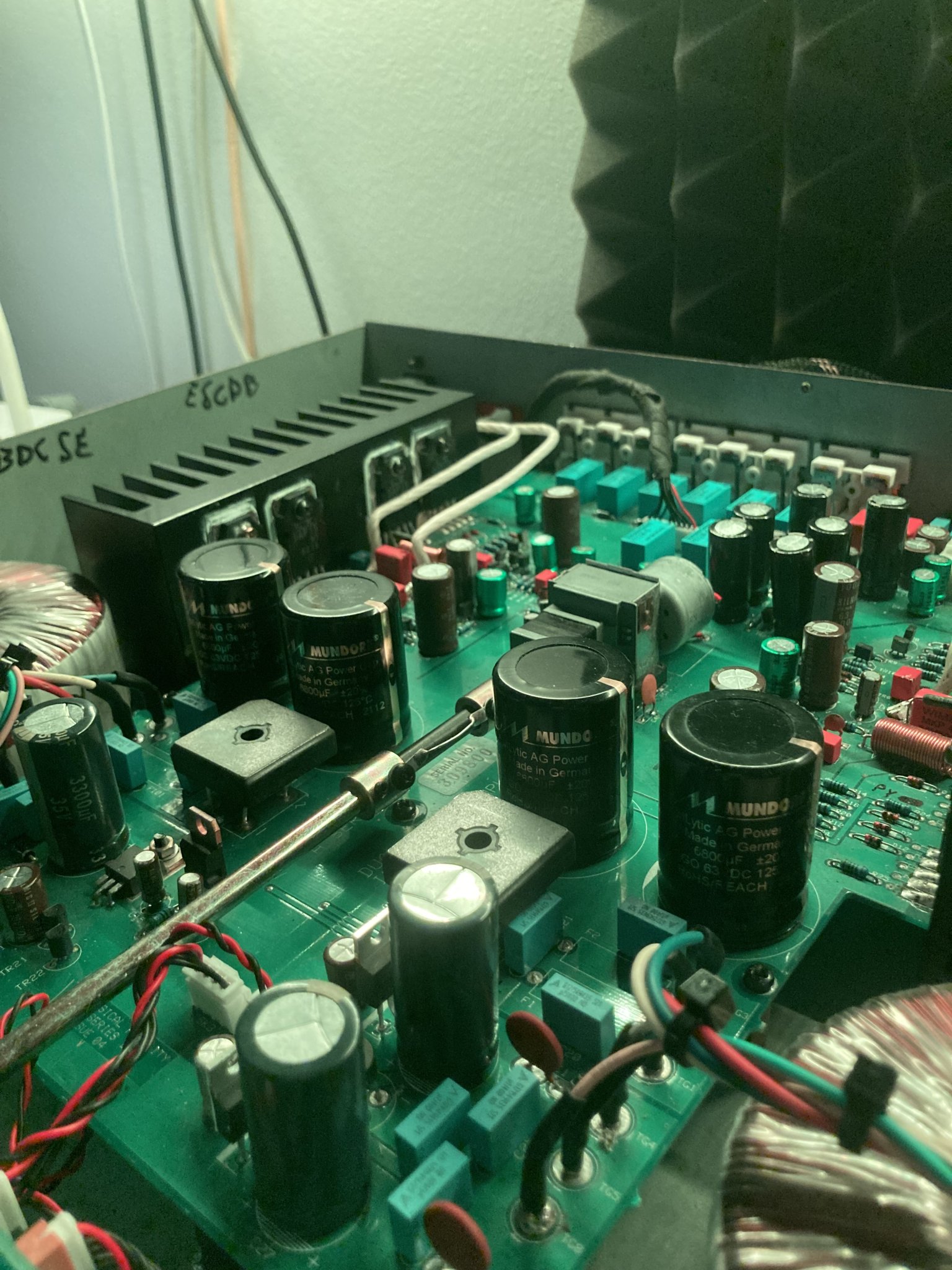

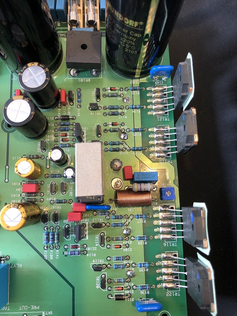

I adopted another modification recommended for Naim amplifiers and added additional power supply capacitors (Nichicon UFW 2200uF 63v) directly to the collector of each output transistor.
ground lands above and below:
Nichicons installed on underside of PCB with double sided tape for additional support/insulation:
As per the original linked article, the result is incredible control and punch together with further improved depth and height of soundstage - I'd definitely recommend considering it.
The interior of A3 and A300 looks the same, except for a pair of SAP15. Is it possible to add 1 pair of SAP15 and this MF A3 will become MF A300?
Yes. You can do it!The interior of A3 and A300 looks the same, except for a pair of SAP15. Is it possible to add 1 pair of SAP15 and this MF A3 will become MF A300?
