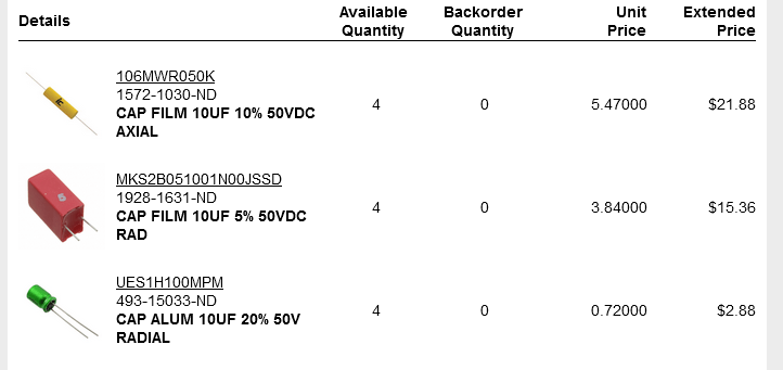

Thanks to everyone who opined to this post. I did install Wima MKS in C3 & 103 positions, and am pleasantly surprised by how good these inexpensive caps sound over the stock NP electrolytics. Indeed that high DAC out impedance imparted a very noticeable bass boost if just inserted into the preamp out RCA jacks. As was also mentioned, that combination of DAC and preamp did induce a low pass filter which rolled off the highs a bit, and the overall presentation was just too veiled and dark for my ears. So I installed jumper pins on the PC board by lifting one leg of R59 & 159, this separated per-out and amp in to resolve these issues. Severing the peamp section did the trick to flatten out the frequency response and restore lost dynamics. Why the manufacturer did not install preout/main in jumpers on the back panel as so many others do I have no clue.
Please keep this in mind and be surprised how many state that MKS is bad, Wima is bad etc. Even in this thread it was said.
It is plain nonsense, it is added useless noise: they are better than electrolytic caps and datasheets and measurements are clear on this. Using matchbox sized polypropylene caps with flying lead wires will generally not give better results (certainly not in class D amplifiers).
Those Wima MKS are better than the average electrolytic cap and you don't need to replace them in the future. ...
