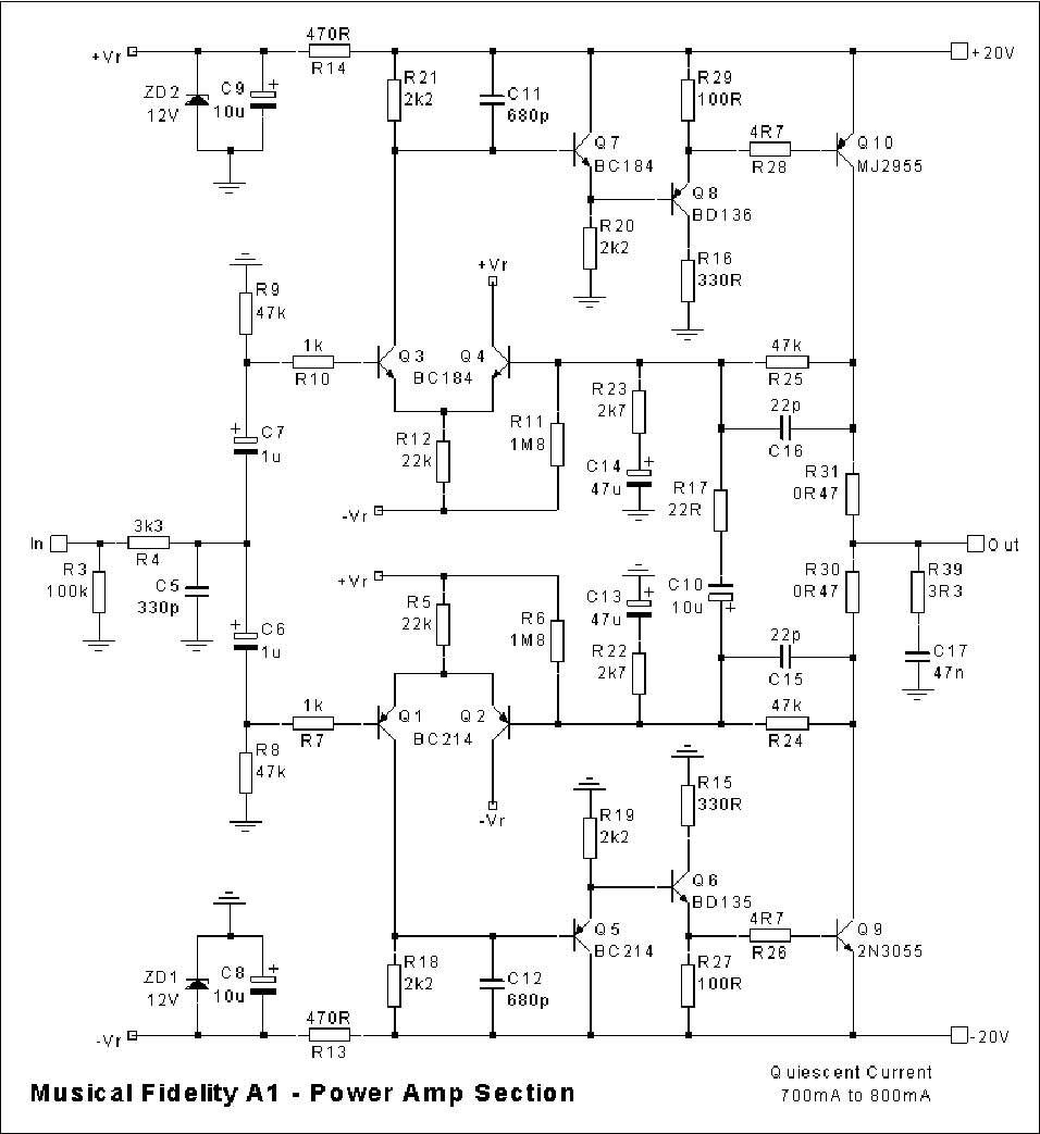

I just did a recap of Musical fidelity A1, my one is the very early version of A1 I think.
Here is a list of components changed in the pdf attached below. Hope it helps anyone want to do something similar.

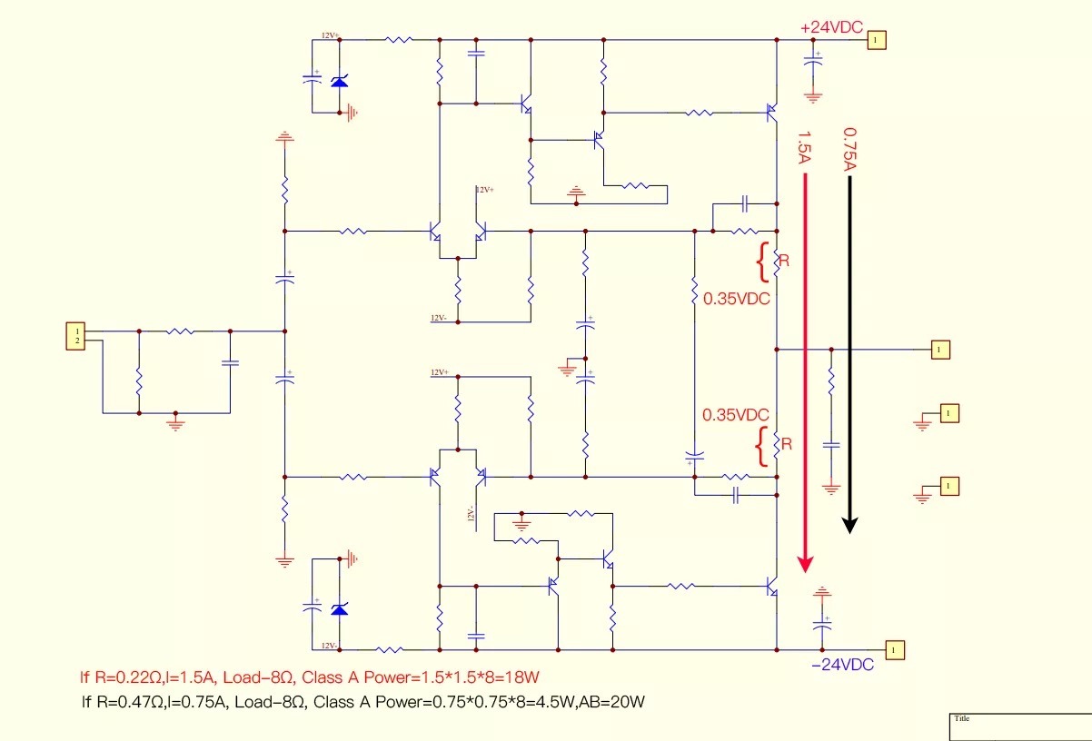

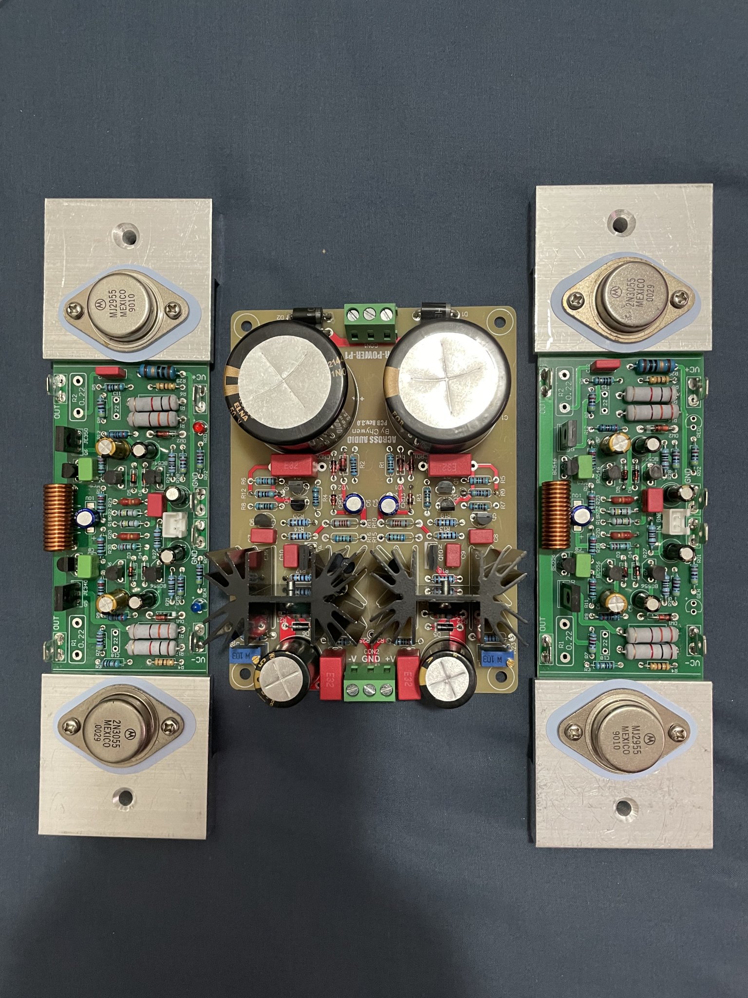

Hi @snowjx Thank u your sharing component part A1 very very interesting,
I just build A1 Clone with my existing transistor •2 Set BC550/560B, 1set BC550/560C, driver BD140/139 And TR output Mj2955/2N3055 with PSU base Mark Levinson.
•Xformer 18-0-18 5A
Not yet testing!

It's good to refurb an old amp with new consumables like electrolytics but I assume you're about to swap everything in sight for new and different actives as well as passive parts. Unless you are experienced with servicing these early MF products, that's likely asking for trouble with no guarantee you will get your money's worth.
The total of your bill of materials is well over £100 by my quick estimate. That's still less than many way over-valued used A1 prices which are simply ridiculous. However, I can't see any value in replacing the small-signal semis, resistors, film caps etc. but if you want to be replace everything just for the sake of completeness, replace the old and likely over-baked PCB first, then fit new components.
