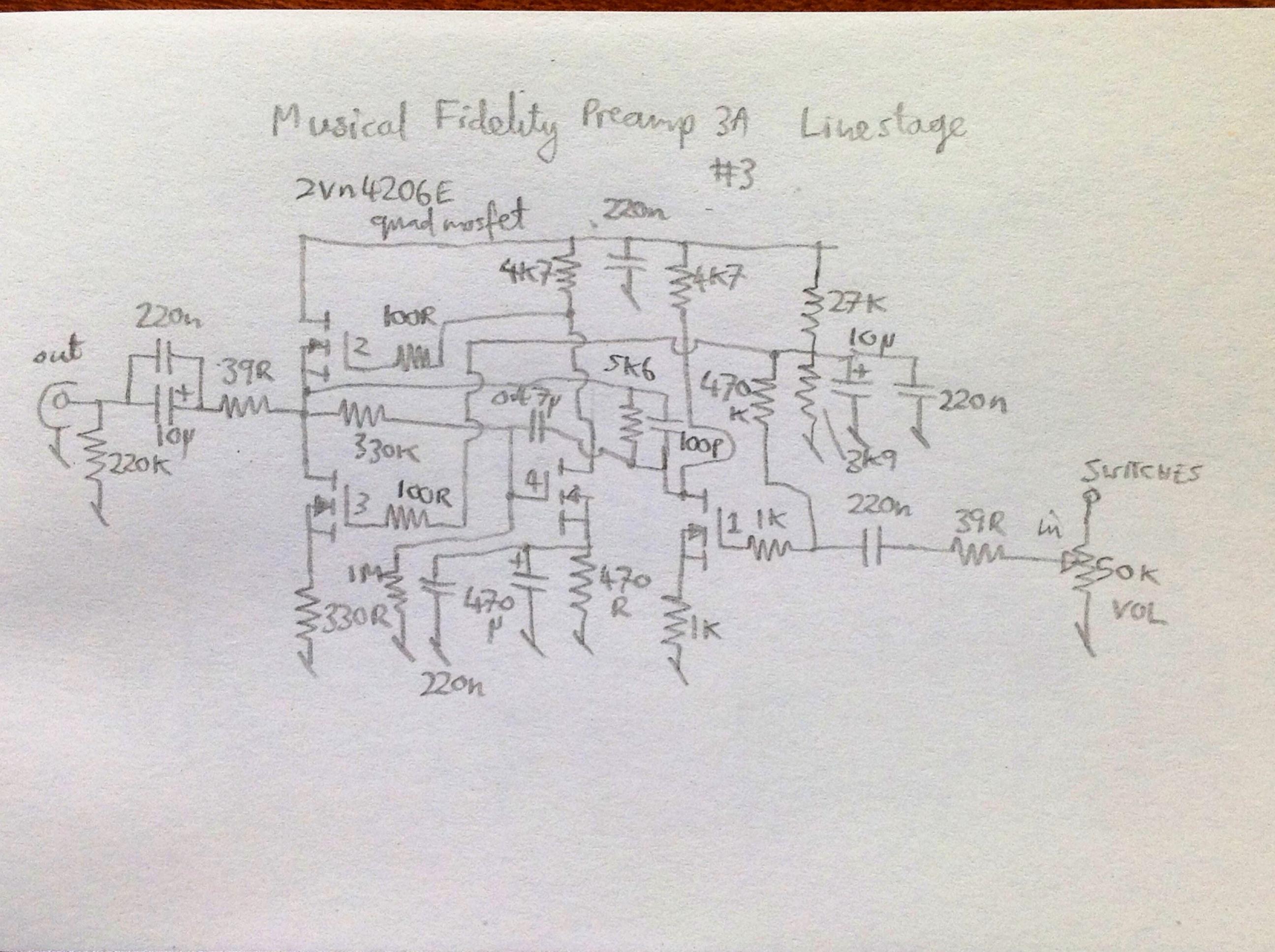

I've had this Pre from new and done quite a number of mods (500VA transformer, Panasonic Pot, Multicap Rtx and Sonicap Gen 1 caps) which have all improved the sound considerably. One problem with this pre-amp is noise from the Quad N-Channel mosfets ( ZVN4206E ( VQ1001J ) ). In an effort to eradicate this I bought some 2sk170's. At first I just did push fit into the left channel's i.c. socket. The good news was that the hiss was gone and volume level was just the same as the right channel. Unfortunately there was a slight hum/burble noise. At first I put this down to local pick-up due to lead length.
Next I cut back the lead lengths and soldered them direct into the pcb, left and right channels.
OK, so no background hiss, but I was left with what I would call a motor-boat type hum/burble equal to about "20 to" on the volume control. Turning up the volume produced a very clear sound except of course for this background hum.
Can anyone suggest what may be causing this?

did you draw that diagram yourself? never been able to find schemis for much MF stuff. a very helpful guy on here has been helping me fix my power amp though 🙂
Mike, I sent you a private message. The post is rather old but I am still interested. I think the diagram has some errors, so I'm curious if you actually tested or simulated the circuit or that you have drawn the diagram by looking at the pcb. Furthermore, I like to hear in what way you've changed the amp, what worked for you and what didn't?
By the way: the preamp hisses somewhat and that is by the nature of the mosfets themselves (in relation to topology used). Changing to BS170 won't change this, I actually tried it myself. Your motorboating issue is probably related to the feedback capacitor of 100p. Try to fiddle with this (make it bigger or smaller, try to leave it out altogether).

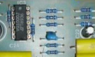

- value pot: 50k or 100k log.
- resistor: see attachment, the 100pf is the small blue cap, I think it is the resistor just below the blue cap, check the value, must be around 10k, try putting another 10k over this resistor to get 5k new value.

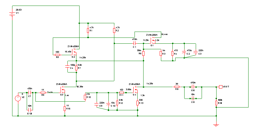

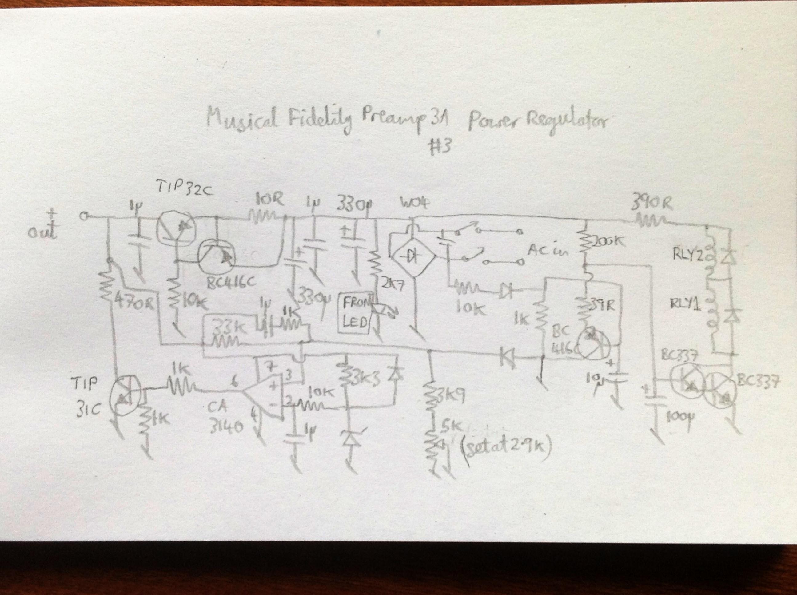

I was curious about the good sound and the hiss. I tried to rebuilt the circuit by myself to try out different power supply arrangements and different mosfets like bs170. In this way you can learn a lot while not destroying the original.
Hi Colin... thanks for posting these drawings. I'm curious to know how you might implement a simple balance control on the pre-amp. I'm suffering imbalance (only slight mind you)
