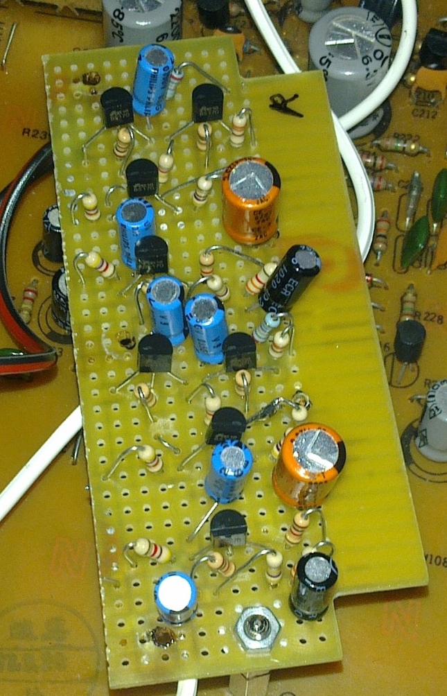

picture of working prototype
This was my first prototype on veroboard using bs170. Still working today.

Is your circuit noisy? Yes it is. No way to solve this issue. It's inherent to the circuit and mosfets as used. So please stop modifying this amp to get rid of the noise. You can modify what you like, do it for fun of or (hoping to get) better sound but don't do it to tame the hiss, it won't work.
I suspect the main source of noise in this circuit would be the input mosfet. Looking at the data sheet of the BS170 mosfet it isn't specified for noise performance, being designed for low power switching applications. You could parallel the input mosfets, each with their own source resistor (1k with 1 mosfet, 2k each with 2 mosfets, 4k each with 4 mosfets etc). That would cut the noise back but better still, you could replace the input mosfet with a low noise bjt such as 2sc2240. You'd need to change a resistor on the input bias circuit to get it to bias up properly.
One of the lowest noise mosfets out there is the BF862 from NXP - originally designed for AM radio applications. It was measured independently against a whole bunch of other low noise devices about a year ago and it really is absolutely outstanding (noise is under 1nV/root Hz). It is SOT23 SMD, but the results in dealing with it are well worth the effort. Best of all, they are dirt cheap from Mouser.
I used bf862s in an mc headamp. It is a depletion mode jfet, not an enhancement mosfet like a bs170. Still it could work in the 3A circuit. But at 3ma drain current the transconductance is going to be low, about 28mS. I'm not sure what the transconductance of a Bs170 mosfet is at that current, the data sheet only shows that at 200ma and ten times as much. The lower the transconductance the higher the distortion in this circuit. Try a bf 862 and see! It should definitely be quieter. And measure the distortion. An alternative could be a 2sk170gr (or its modern equivalent Lsk170a). Bjts would have low distortion in this circuit. In the 3A phono stage there is an LM394 low noise matched bipolar instead of a mosfet as in the line stage.

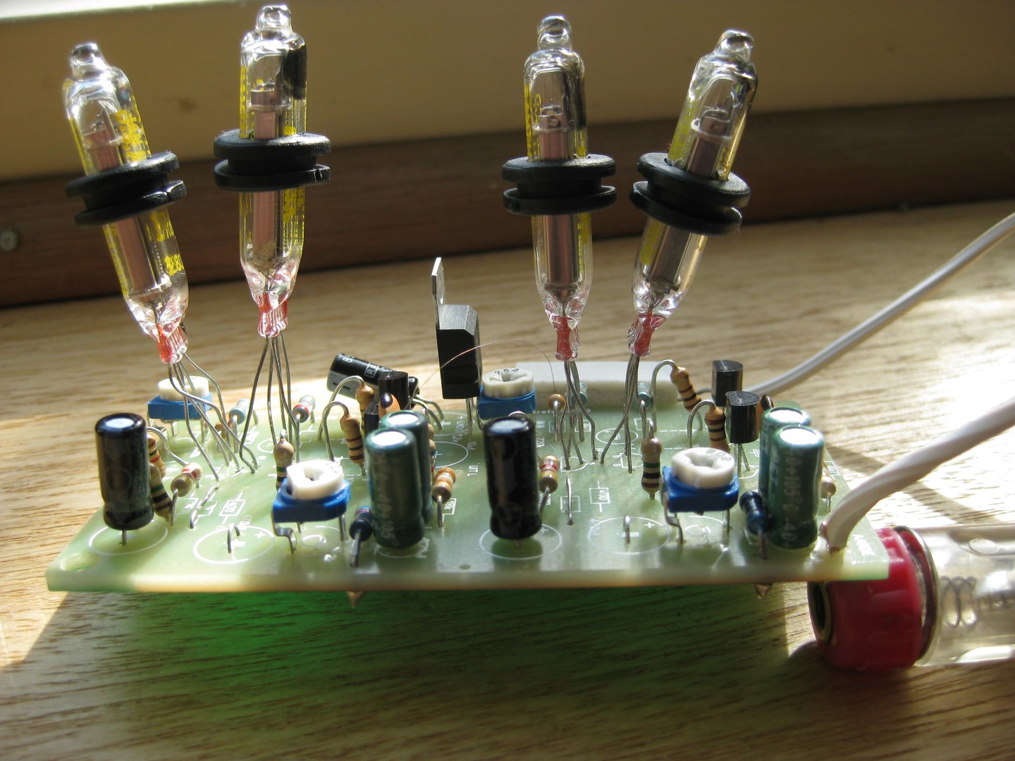

A few years ago (when this thread was running) I even build a version of this preamp with nuvistors for the first two stages (only 2x BS170 at the output).
For the output stage I experimented with 1x BS170 on top with a LM317 as current source. Tried a range of idle currents.
I even designed a special pcb where I could easily switch/choose the different units. I made an arrangement for LM317 stabilized power supply for the unit at the same pcb (worked allright). And a second LM317 for creating the filaments power supply (if I remember correctly 2,5 Volts).
I will check my archive for pictures.
Not a preamp3 anymore!
The hiss problem is solved by this arrangement (or at least greatly diminished). You get a new problem in return: some microphony.

Next step forward was putting out one stage of amplication and tune the feedback (till no feedback at all). Still I'm not convinced of the superior quality of these pencile tubes.
