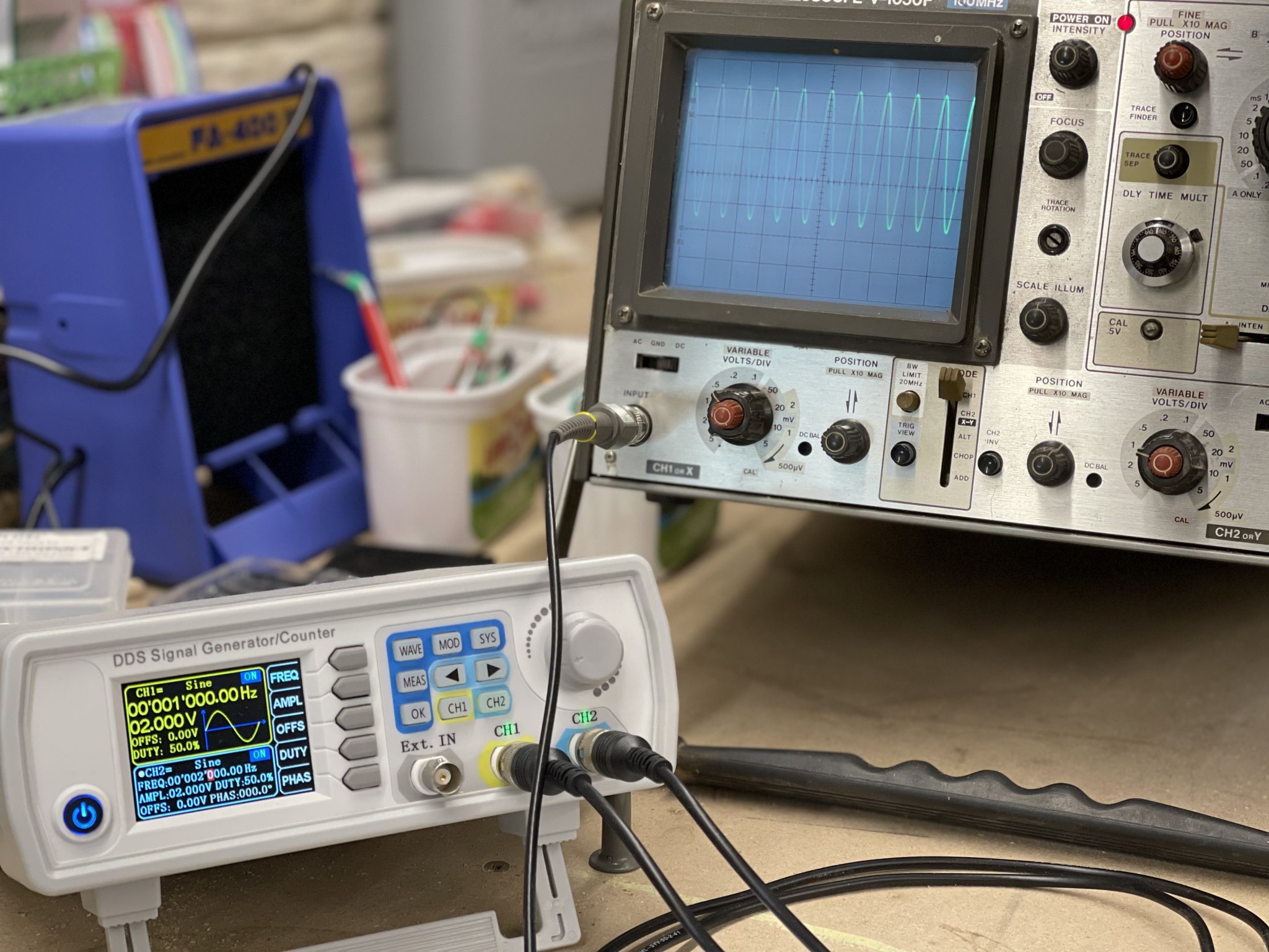

After some fun with the signal generator, I found that both volume boards were working properly. I knew they were both working in my previous post, but did some more exhaustive testing.

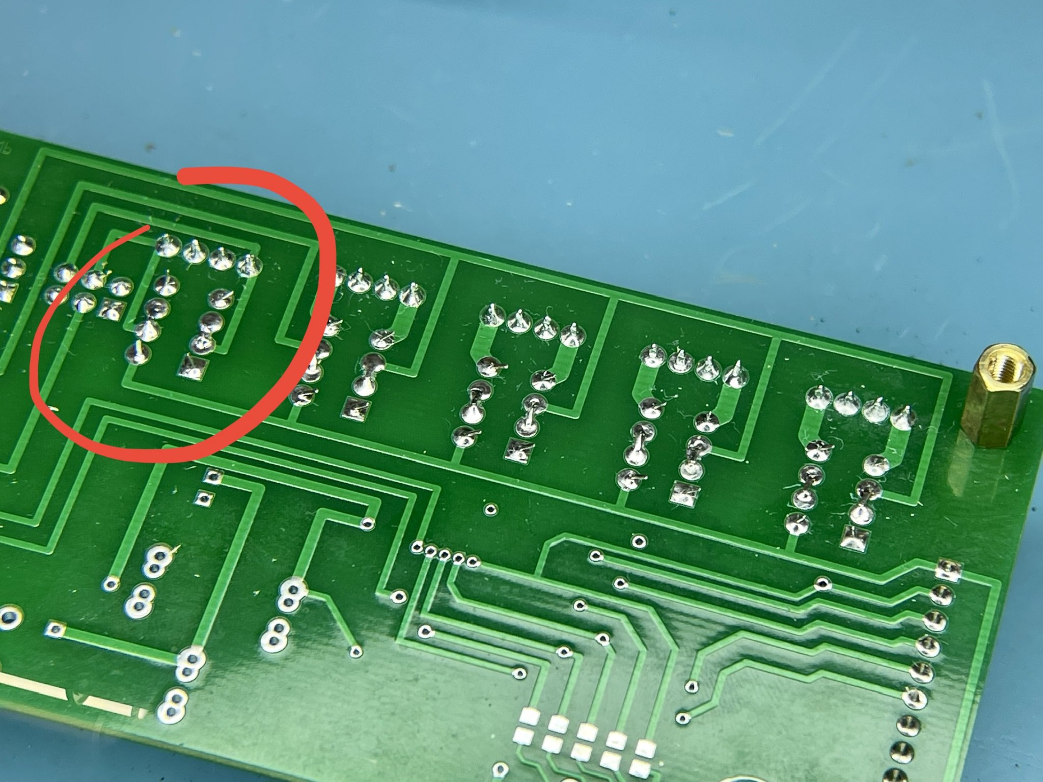

So next thing to do was remove the lower main board (the channel that wasn’t working) and attach some jumpers into which I could inject signal into the volume board. I sent a 2V 1000Hz sine wave into one channel and 2000Hz into the other, just so it was easy for me to identify. I turned it on, turned the volume up, and sound was passing through it. Huzzah! So now I know the problem was on the main board.

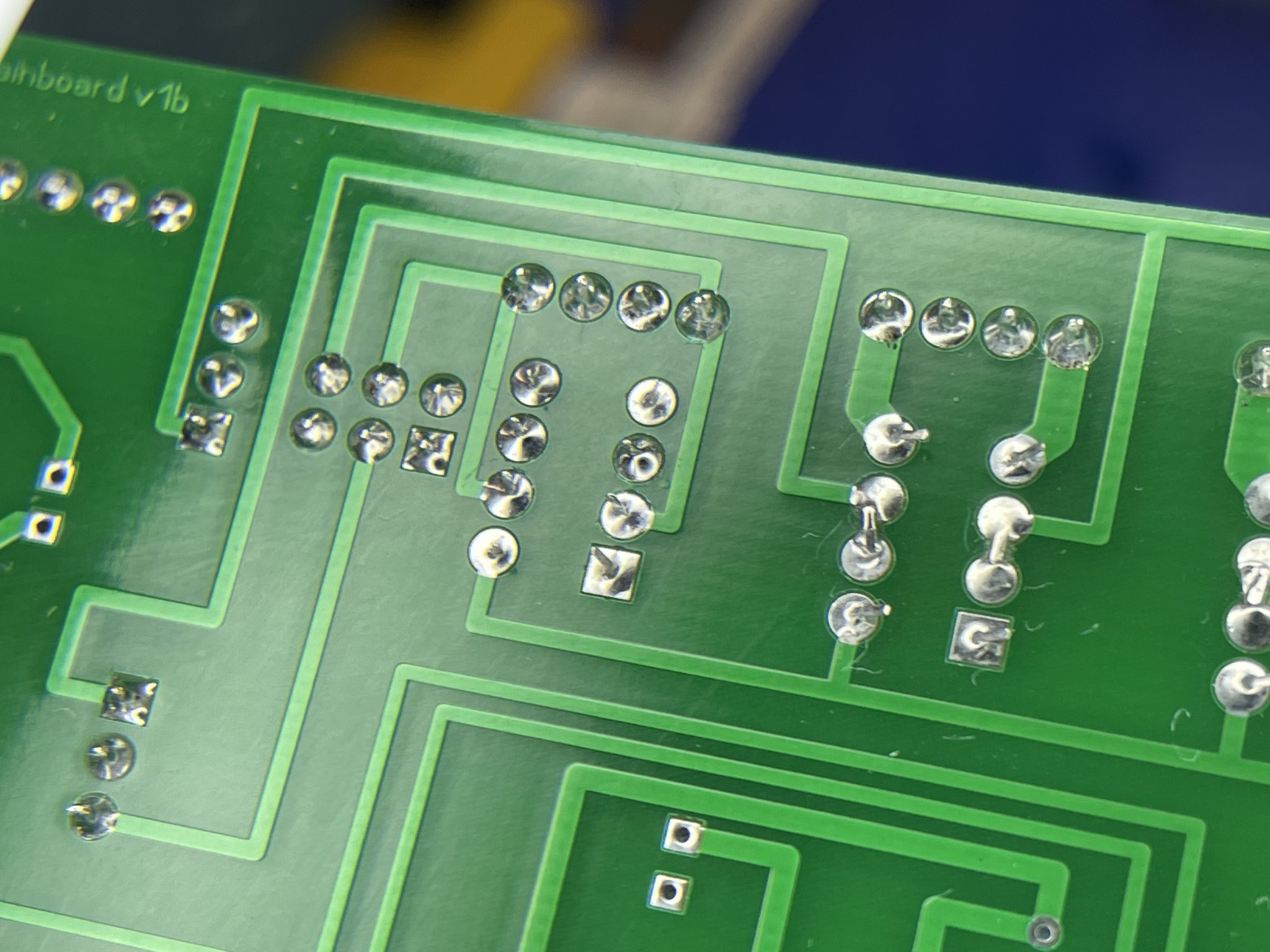

After a visual inspection and some probing with my DMM, I noticed a difference. The output relay from the main board is not supposed to have its center contacts shorted as the input relays do. I fixed that problem and now signal is flowing through the entire device properly. Outstanding!
