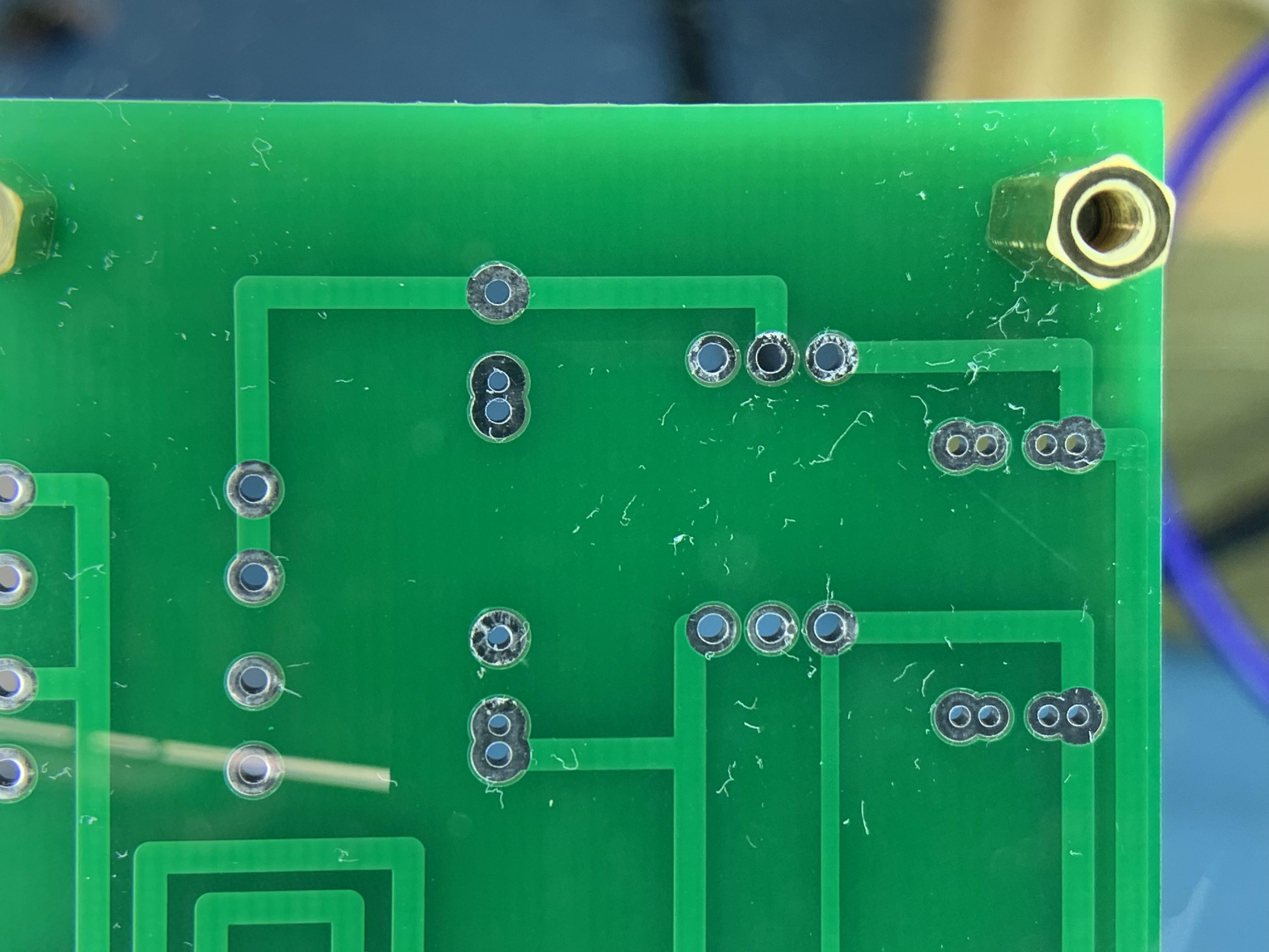

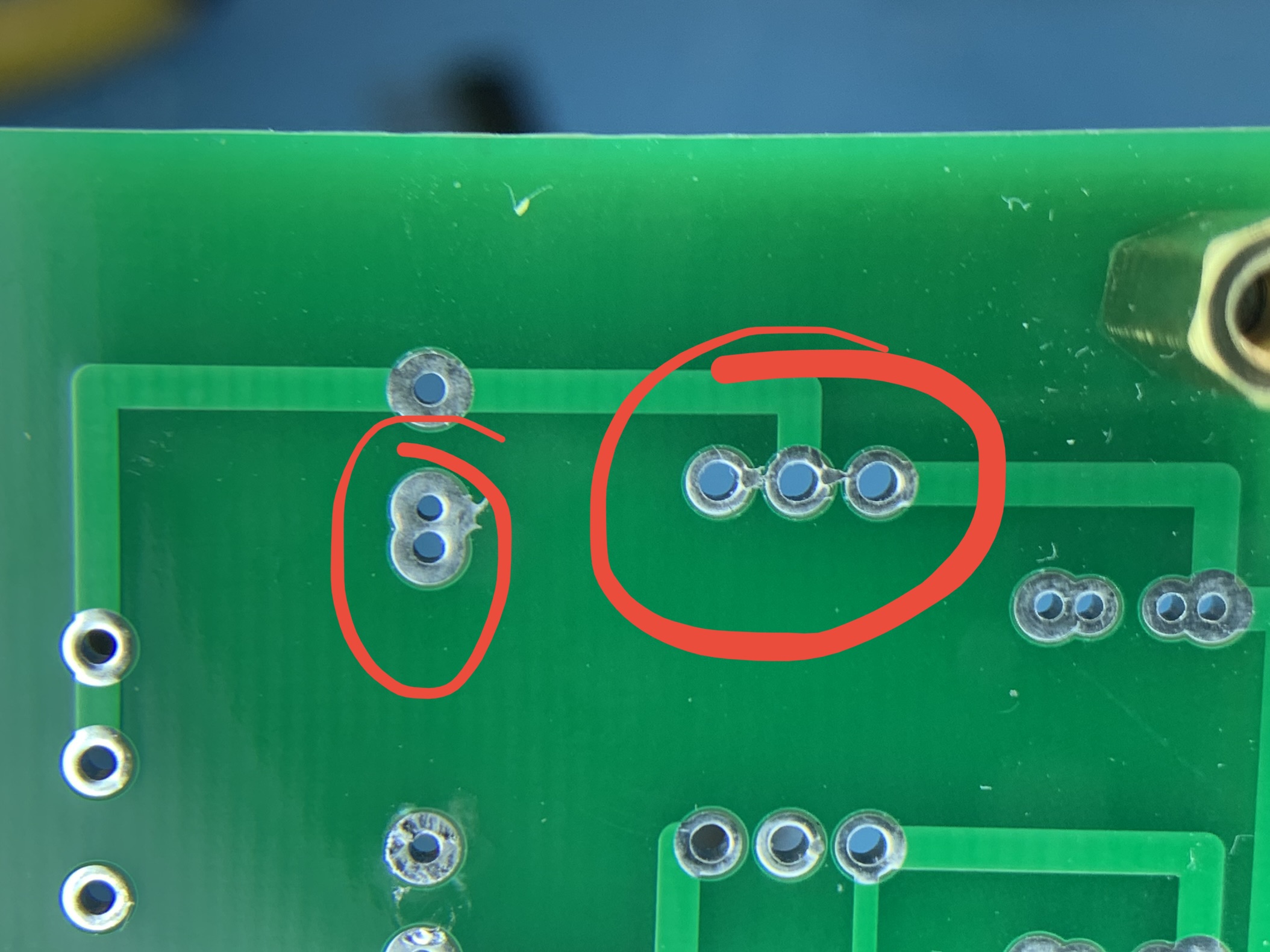

I tracked down one problem this evening: the missing -15VDC on the balanced board set. I started systematically disassembling things until voltages were restored. Once the voltage came back, I found the culprit was the second unpopulated board (except relays). I measured across the -15V capacitor spot and it was dead shorted.
After analyzing everywhere -15VDC was routed on the board, I noticed that a wave soldering glitch from the board manufacturer that bridged all the -15V regulator pads together as well as a little splashing in a couple other spots. Little bit if desoldering wick and problem solved. No more short.

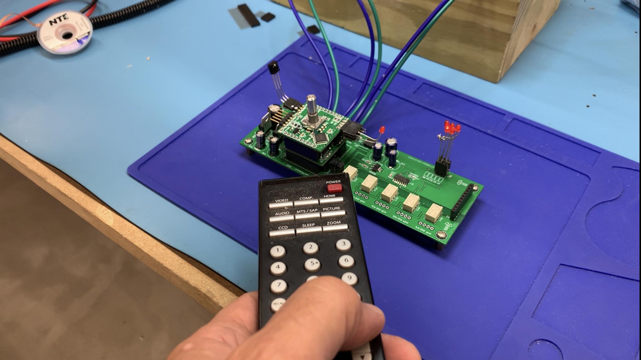

I ordered new microcontrollers from @meldano to correct the one problem child and a "just in case" device. Daniel went out of his way to find replacement devices for me since they're on worldwide backorder right now. For that I am ridiculously thankful!
They arrived late last week and I had the opportunity to replace the one damaged device and the voltages popped back up to where they should be. Problem #1 resolved! I powered up the volume control and it came on without issue. It accepted the remote control codes as expected. Another victory! However, it still failed to switch the relays on the main board.

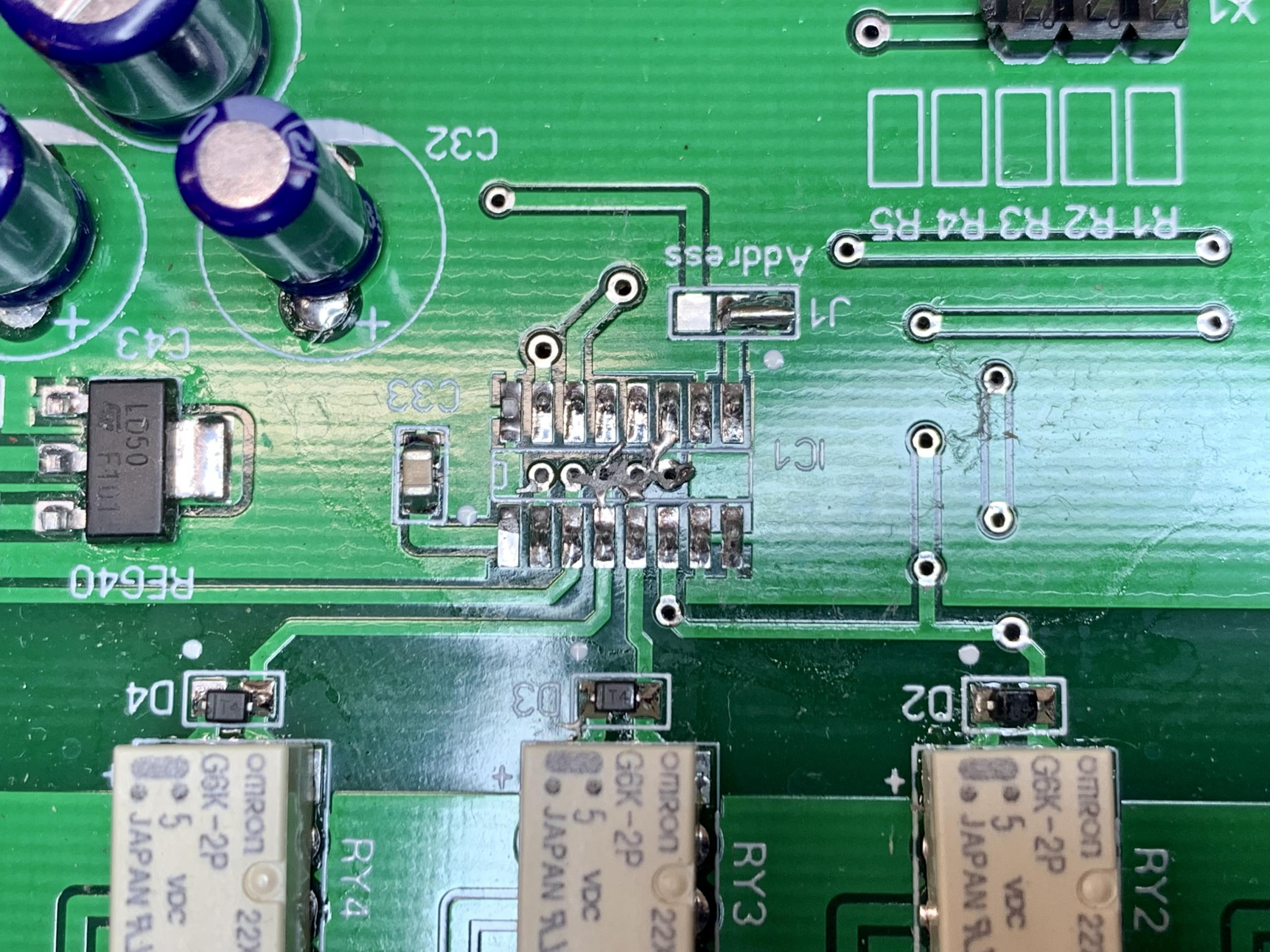

I checked the continuity of traces between the microcontroller board and the main board and all was well there. I checked the voltages again, just as I had many times before, and something just seemed off. They were the same voltages I'd read in the past, but this time something clicked that I needed to check. One pin read +5V where it should have read +3.3V. I didn't see it as a problem before, but today I did. So I asked myself, "What are the chances?" So I desoldered my LED/relay driver chip to investigate beneath it. Oh my word...
Total n00b SMD/airgun/solder paste mistake. Not enough heat, not long enough, too much paste... There were bridges all over the dang place causing the driver chip to be unable to do its job. Man, do I feel dumb! Time to check my other ones!
Now, I'm happy to say that my unbalanced set is switching great, just as it's supposed to. Time to get some sound through it and see how the volume control side works!
Embarrassing solder job photo and success photo below. Moving forward!

I must say, the second one (balanced set) was just a bad as the first! Cleaned it up, resoldered the driver chip, and all works well. This one doesn't want to come out of mute very easily without forcing it in/out of mute when changing inputs. This may be because I've got some jumpers out for Aleph P use. I'll double check that. It may be the system's way of protecting itself from the like of me. 🙂

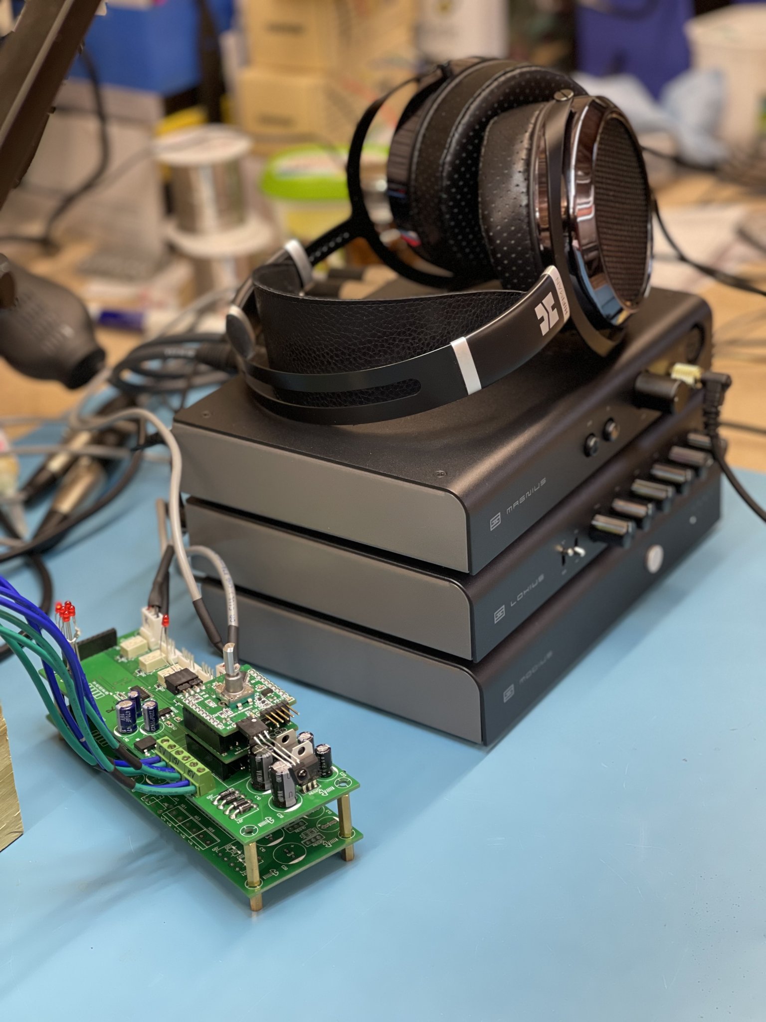

I finally got my setup in a condition I can test it. Exciting day!
After a lot of futzing, I cannot get the left (bottom) side to work (balanced set). I even reset the MCU and reprogrammed everything from zero. Same thing.
Conditions:
* Both VA boards work. I can swap positions and sound goes through, but only when in the top position. Lower position has no output.
* VA boards are jumpered properly, J2-1/2 on one, J2-2/3 on the other.
* Switching relays are working on both main boards.
* Programmed for balanced operation: Parameter 8=001
* Programmed for four inputs: Parameter 4=004
* VA board X4-1, X5-1 show input signal; X4-3, X5-3 show no output signal. But only in the bottom position. Works fine in top position.
I’ve traced everything I can think to trace that is reachable from the outside. Happy to hear anyone’s ideas!
Sorry.
Please check all signal traces on mainboard.
For example with sine wave.
Will do. I did an initial check with music playing and AC on my multimeter until I stopped seeing voltage. But I will set up a more detailed check with an o’scope.
