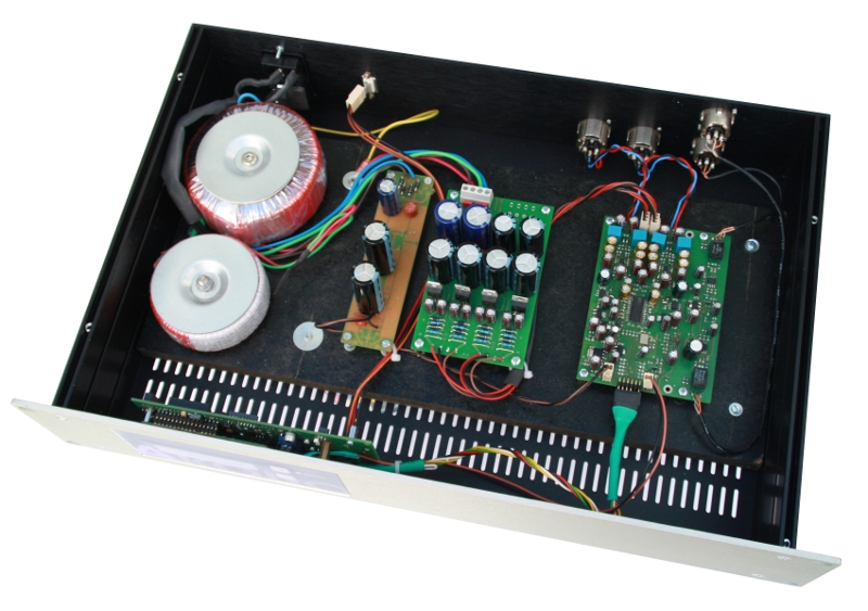

I 've just finished my Muses Protos for the first listning test.
It sounds great !! the best Volume control i've ever used in my Preamp.
I use two Muses boards with low noise LDO (TPS7A49, tps7a3001) for full symmetry
The Muses is buffered with Cascoded FET Buffer with DC-Servoloop and a OPA1632 gainstage.

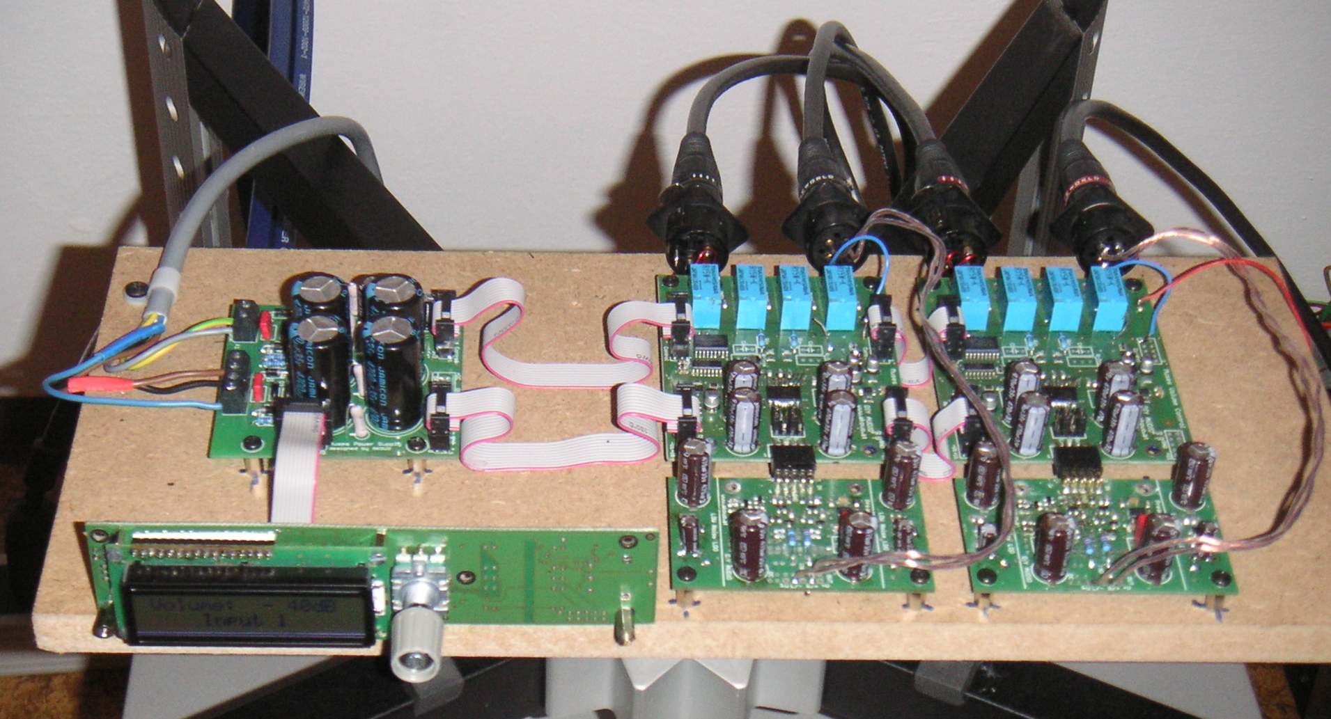

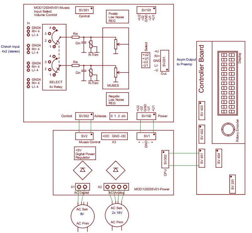

Yes, a kit will be available in about 2 weeks!
The boards are in production now and we are still working on our webshop.
The schematics for the modules will be also available on our website.
Please be patient, i'm still working on the documentation.

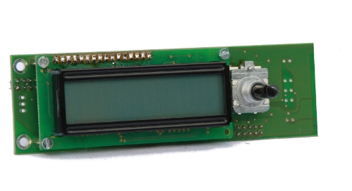

You can use a second rotary encoder connected with an ribbon cable anywhere you like it.
This mcu board is also designed for other kits, wich will be available soon.
(e.g. SABRE ES9112 ADC Kit, ES9018 DAC Kit).

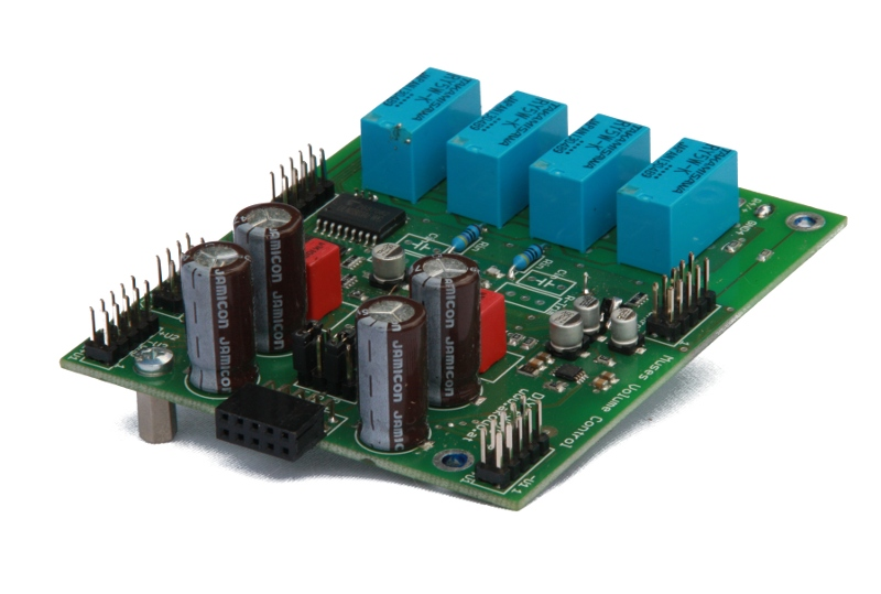

I will offer initially only the muses board with four input selector, a controller board
with display and a unregulated power supply kit, which provides also the 5V for the controller. All modules cold be connected with flatcables
@ maxw
I solder the parts on the prototype by myself, but our modules are machine-manufactured.
It is hard to solder this little pieces and i can do that only with a big magnifying glass, a hot air smd tool, solder paste and much patient.
