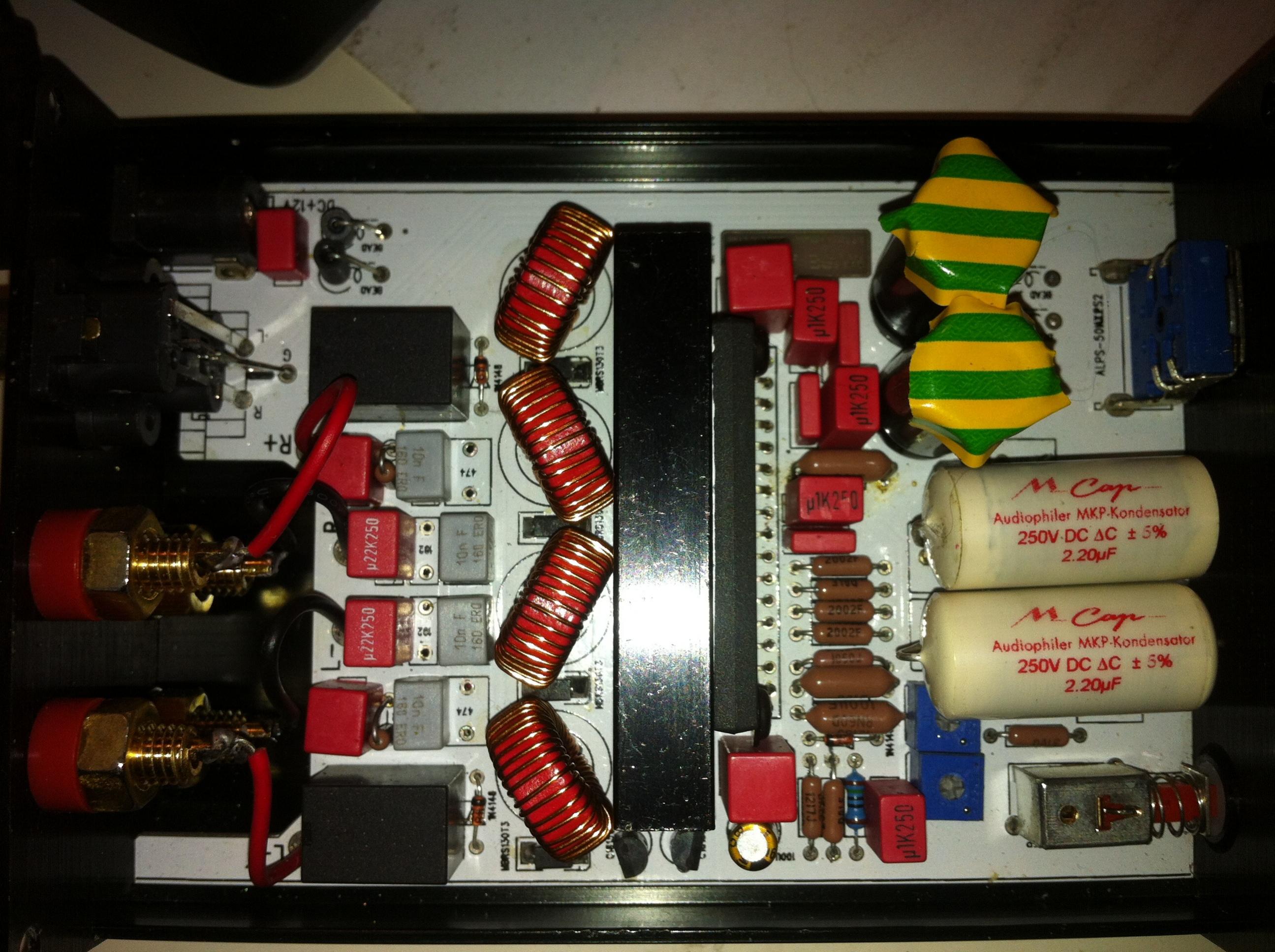

Right now I found all the caps needed so I have every original cap replaced. I don't know yet how well will Co fit but I will post some pics when I get the parts. I have about 7.3mm between holes on diagonal and the replacement i get will have 10mm pin spacing. Will need to bend the pins a bit but should work out well.
Sure fit:
Cdo 0.01uF - Wima FKP2 0.01uF/100V - FKP2D021001I00 (5mm pin spacing)
Cz 0.22uF - Wima MKS2 0.22uF/100V - MKS2D032201C00 (5mm pin spacing)
Cs, Csw, Cd, Ca and the rest of 0.1uF found on board - Wima MKS2 0.1uF/100V - MKS2D031001A00 (5mm pin spacing); these need to be slim enough as sometimes they are mounted next to each other and thicker one won't fit.
To be tested for fitment:
Cz and Co 0.22uF - Wima MKS2 0.22uF/250V - MKS2F032201H00 (5mm pin spacing)
- Wima MKP2 0.22uF/100V - MKP2D032201K00 (5mm pin spacing)
- Wima MKP2 0.22uF/250V - MKP2F032201K00 (5mm pin spacing)
Co (i prefer MKP4 for this slot) - Wima MKP4 0.22uF/100V - MKP4D032203G00 (10mm pin spacing)
- Wima MKP4 0.22uF/250V - MKP4F032203G00 (10mm pin spacing)
Cp and some other 1uF cap found on board - Wima MKS2 1uF/100V - MKS2D041001K00 (5mm pin spacing)
After I source all of them I will take some pictures of the fitment.

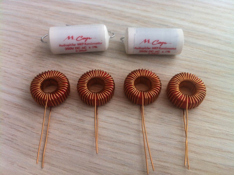

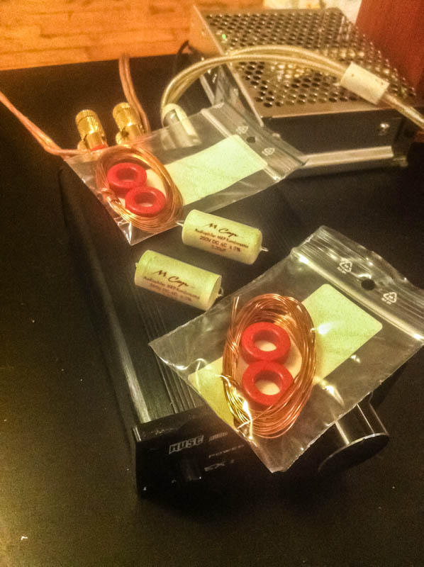

Yesterday I got the Mundorf caps from a local dealer and the inductor kit from 41hz.com arrived. I must say the shipping was real fast, few days. I like the quality of the kit, it's real nice to DIY. I suggest if you get the inductor kit from 41hz.com (and you should, it's up to spec with ta2020 datasheet), do the first core trying as best to get it right. After the first one you will know the right way to wind the other three, and at the end unwind the first one and wind it again just to be sure you did it ok. I received longer wires than people mentioned some time ago. Had no problems with too shorter wire. Also I saw that they put 7-8 wires just in case some of them brake while winding them. I pulled pretty hard (but not too hard) and had no problem. Also be sure to pun some leather strip on your pulling finger so the wire doesn't hurt your skin. At first I thought I could do it but after the first was done so was my finger.

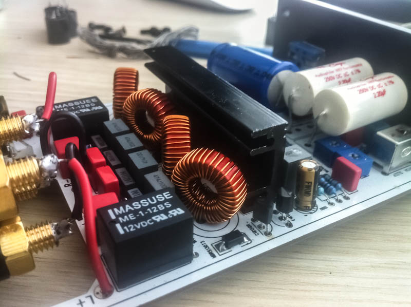

I managed to install the caps and inductors but no time to test it yet. Still to come 0.22uF, 1uF caps replacement. Need to find 2 power caps that add up to about 4400uF for PS. This way I can lower the input caps as well. I think I should put something on the inductors, like heat shrink... The old ones are sealed inside. They feel heavy and look very robust. Still, had to replace them with the recommended ones.
Looks good .. so far. Nice winds on the coils I often rewind My Toy airplane Brushless motors Thumbs can get sore.
The number of turns = inductance.
Thickness of the wire = Amp capabilities.
The wire used is Varnish insulated.. and the varnish is tough.
Pointless to further encase them in Heat shrink.
That tiny case does present fitting issues though.

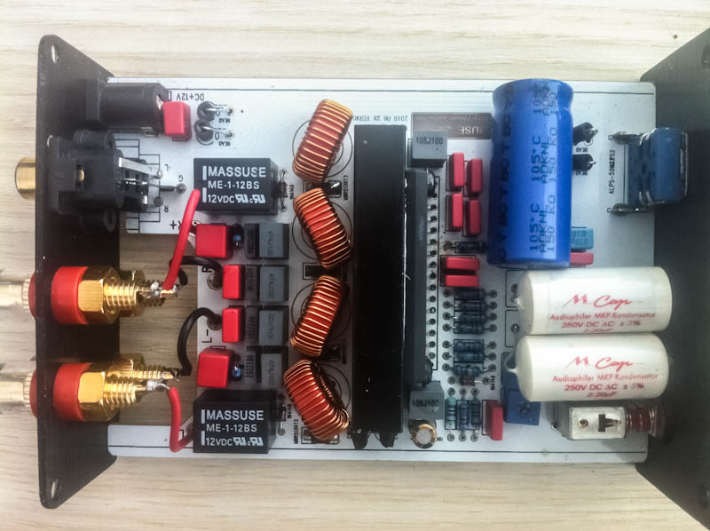

I did finish modding my amp 🙂
I replaced all but one resistors with Dale ones. All capacitors on board got replaced as well. I finally settled for two Panasonic FM 2200uF/16V for power. I bypassed input/output/power caps with Vishay MKP1837 / 0,01uF caps. Just because I had some. The output caps went on the backside of the pcb between it and the case. It was a very tight fit but I found some Wima caps that were long and thin matched for 8 ohm speakers. I also bypassed the volume pot completely. I used Micrometals core inductors sold by 41hz.com. I have checked all parts with the ta2020 manual so everything will be ok. Also I managed to replace the protection relays with 3A ones that I got from the same company that made the 2A ones that were inside. The best part is that they gave them to me free of charge with free shipping 🙂 They work great for this application. Massuse is the relay company. Great customer care! With 8 ohm speakers I won't worry over the 3A relays anymore.
Just found out tonight that the two pots on the board are actually trimming pots for the DC offset. I measured the outputs tonight and I had 90mV on one and 230mV on the other! I adjusted both to about 0.5mV. Now the very thin popping sound that I had at power on has now completely disappeared. And the amp is dead quiet at full volume (from my sound source, the amp is at full volume now with bypass). I'm very excited over the result and it was really worth it. I consider this a very good choice for modding as it has enough space inside for modding and it is also very small anyway. I saw that the amp goes for 36$ with free shipping. Even if you replace every component inside you pay 36$ for aluminium case + aluminium knobs + pcb + ta2020 chip + heat sink + connectors and some diodes that will never replace anyway 🙂 The other amps out there are either too small to fit larger power caps + proper inductors or are more expensive. In the end you should look for nice aluminium case + proper PCB + space for future mods if you decide to buy a ta2020 amp.
I did a listening test with my Fostex fe206e speakers and I got the goose bumps on vocal tracks. This amp blew my mind and I think I made the best deal on audio amp for my needs. The most problematic has been finding/sourcing the capacitors. I had to make sure they fit and also they are good quality. I might experiment some more with a few more input caps. But the rest is perfect and most importantly...it fits! 🙂
I use the whole setup with a Meanwell S-40-12 variable smps power supply. I adjusted it to 13.5V. It works perfect and is as cheap as the amp itself.
