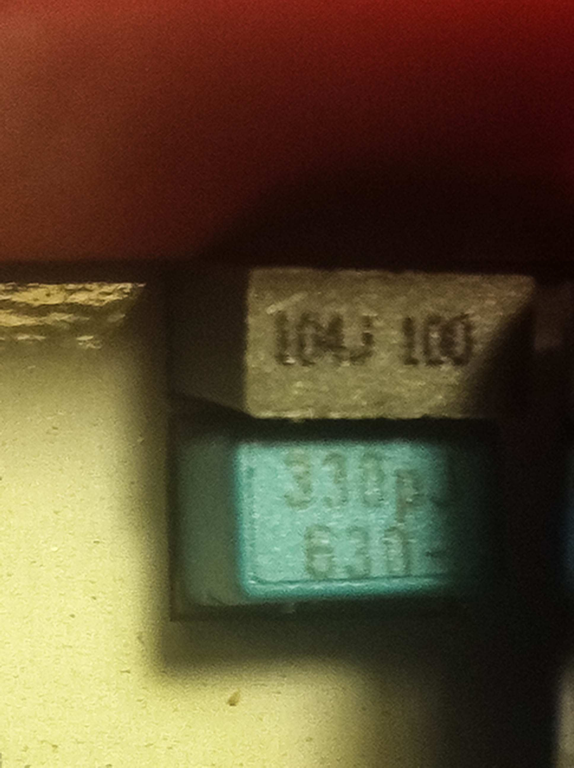

I managed to replace some caps. Cdo got swapped for wima 0.01uF/100V FKP and Cz for wima MKS 0.22uF/100V.
I have some questions for whoever wishes to help me out.
First, I saw that Co is made up from 2 different caps. One 0.47uF/100V paralleled with another 0.001uF/100V. I looked on the backside and they share both connections. Is it supposed to be this way? On the ta2020 spreadsheet there's only one Co (actually 2 for each channel), but I have 4 caps in total for one channel. 2x0.47uF and 2x0.01uF. If the 0.01uF one is not needed then that's actually a very good thing as I will get both out and put a larger one instead :D I might fit a 10mm lead one in diagonal.
Then another thing that I don't get is that I saw 2x330pF/630V (?) connected between the pot and ground. Pot is Alps A503 50K. If I set the sound to minimum (mute) then the cap is shorted out to ground. If I increase the volume on the knob it isn't shorted anymore. Is this creating a low pass filter? And is it ok? Could I do without it and short it out?
All that's needed now is to find some caps that fit for Co and maybe some 0.1uF/100V ones to replace the many rest on the board. They are really small and packed together so I need to find a package small enough. I found wima mks4 0.1uF/100V would be a perfect fit for all 0.1uF/100V on board. And Wima mks4 0.47/100V would almost fit perfect for Co. Would it worth it to go for MKP (polypropylene) wimas for Co and try to make it work with wires? Or would the difference be inexistent between MKS and MKP in my setup?
In the pictures the rectangle represents all 4 Co and circle is all 4 grounding pins (one channel only). In the other picture those are all the 8 Co caps.

The value of Co affects the cutoff frequency of the class-D's output filter, better to not change the value. Same value larger physical size is fine as long as the legs fit in the hole. Don't use wires.
The 0.01uF is probably there due to the "I need to parallel big caps with faster small ones" disease. Or maybe it is really needed there because the 0.47uF is really ineffective at the higher frequencies. Can't trust those China components. I'd follow the datasheet and put one decent capacitor.
330pF capacitors are most likely to filter out RF noise. Cutoff frequency is usually high enough to not affect audio a bit.
