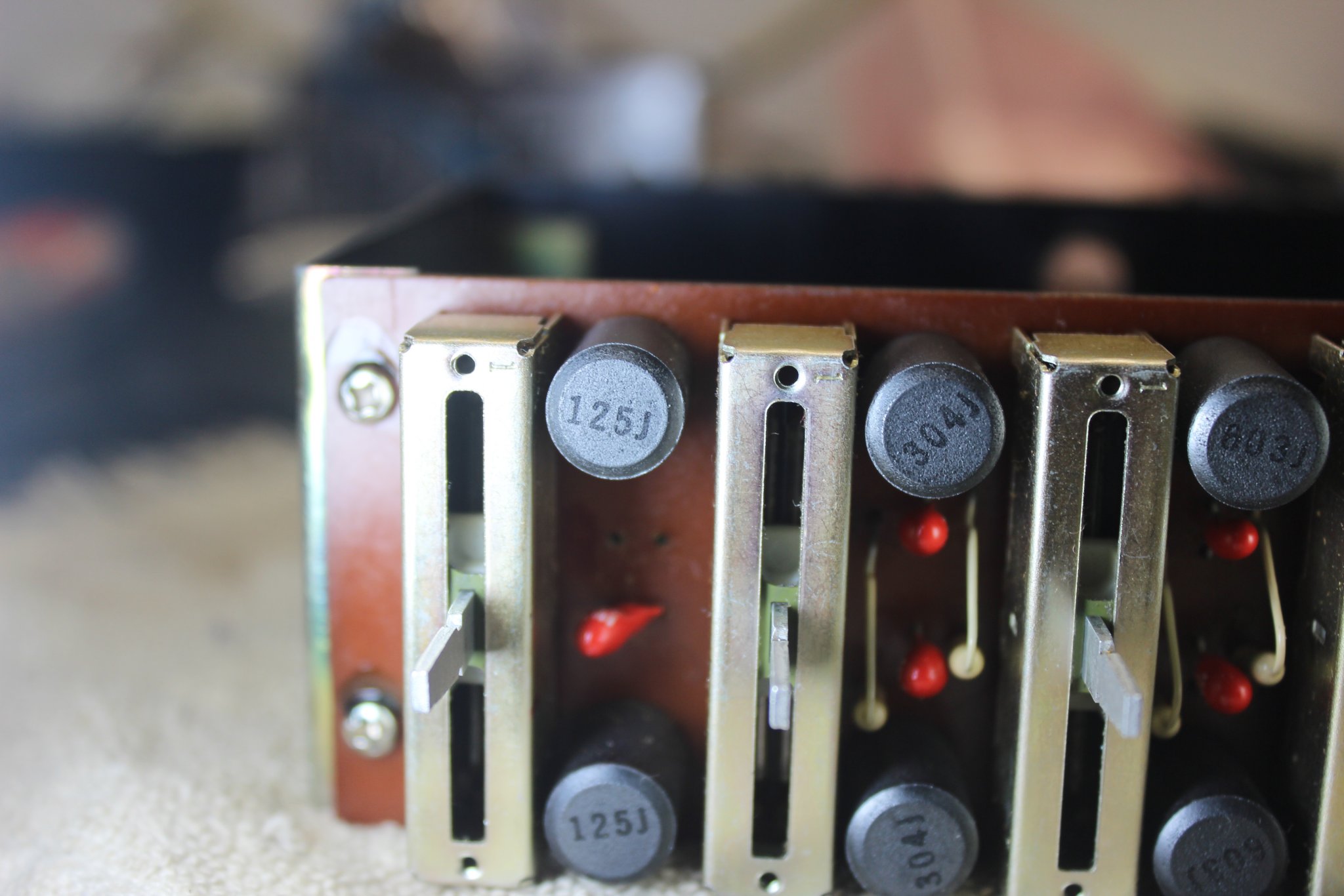

IT LIVES in 2022..... My MUNTZ EQ has come back to LIFE!!!!!...... ONLY ISSUE NOW, is the BASS slider only affects ONE channel. I THINK I found the problem BUT I dont have a clue what these are... FILTERS?... heres a pic.. 125J.... the BOTTOM one there is OPEN.... broken?.... I am unsure what these are and where to get one to replace it.... Oh BOY.... Thought I was done with my MUNTZ. Any input is greatly appreciated. THANK YOU DIY AUDIO!!! BDBD/2022
one of them TANTALUM caps had a broken leg so I pulled them both to swap and see but one has a broken leg, might have been what caused this issue from the start. POLORIZED.... I BELIEVE I can replace them with polorized ELECTROLYTICS, I hope thats correct. Anybody know what that 125J can is and where to get one similar. HELP!!!!!! I am THIS CLOSE to buttoning up this RELIC. Its WORKING GREAT now, no real uneven heating issues anywhere, no static now... Just the BASS on one side is weak cause that 125J can there. LMK, THANKS!!! BDBD/2022
It may be an inductor in a ferrite housing. I don't know if the value is in pico henries or not but if it is, it's likely 1200000 picohenries. Maybe someone else will have more experience with them. The J is a 5% tolerance.
Of you pull it and the broken terminal is on the outside of the winding, you may be able to pull enough to make a new terminal.
If you have an inductance meter, you can pull a good one to see what the value units are.

Inductor.... OK... I will pull it and see if I can find the issue without too much destruction. Only issue left for the old MUNTZ.... away I go. BDBD/2022
yes it is an INDUCTOR. I pulled it and broke it apart, still have the "can"... most of it. WELL theres an obvious WIRE there. Problem is its smaller than a human hair and insulated too I am sure. I am unable to get any continuity reading. Its hopeless, I need to purchase yet another bad part for this MUNTZ. 1.2 MILLION picohenries.... My goodness. time to go shopping I suppose. Any help is greatly appreciated in this matter. THANKS!!! BDBD/2022

It's rare to have inductors as part of an EQ circuit. You should be able to by something with the same value from Digikey or Mouser.
Back before the days of cheap op-amp gyrators for the lower bands you used large inductors. Likely in the multi-henry range for the lower bands. Not so bad for the higher ranges.

Did you confirm that the units are in picofarads by measuring the value of another good inductor?
I THINK this what I seek. 1.2mh..... Mouser https://www.mouser.com/ProductDetail/Coilcraft/RFS1317-125KL?qs=W38ilblRkRkhUv1hCENzTw==

It may be worth looking at the datasheet from the bottom of the Mouser Link. 1.2 Mh could be right. Worth a try and cheap. You know it is wrong if the slider does not boost/cut that channel right.

Found some... TOKO brand, 122J and 123J but no 125J..... Uggggggggggggggg........ at this point i am wondering if theres much of a difference between the 123J and the 125J.... Availability at this point is an issue, I think I found the part. Its 10mm size to fit in there like the other one. I cant find a 125J.... Uggggggggggg....LOL........ Fun Fun Fun. BDBD/2022

The last number is the multiplier. It matters the most. 125 is 12 and five zeros.
Just not sure if the 125 in your case means 1.2H or 1.2mH. Hoping 1.2 mH.
If you can neasure the DC resistance of the good one we may be able to better guess the inductance.

I am afraid them MOUSER ones may be TOO FAT at 13.5mm.... THESE 125J ones I have are approx 10mm size. Its a hard call Hmmmmm.... I would LIKE to get the correct inductor that FITS. Would suck to find they wont fit OR I will somehow mount them from behind etc.... Ugggg. BDBD/2022It may be worth looking at the datasheet from the bottom of the Mouser Link. 1.2 Mh could be right. Worth a try and cheap. You know it is wrong if the slider does not boost/cut that channel right.
