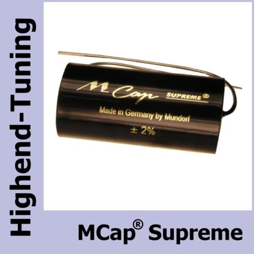

Mundorf MCap SUPREME as a auricap ac tweak ?
Spectacularly bad idea unless the Mundorf carries an X1 rating allowing direct connection across AC mains.
Actually I'm not sure the Auricaps carry this rating either... and no, a given high voltage rating alone is not enough.
That they do not X1
I also know
the AURICAP ar not also 😉
I asked a specific, if anybody here used them for this purpose
Denon these capacitors after the fuse so I'm not worried
And many people have used this technique
I ordered now
4 capacitors of
2 PART 0.1UF 1400V
2 PART 0.33UF 1400V
2 for my denon dvd 2900
2 for my denon dvd 3910
I will get them in a few days from Germany😉😉😉😉

Also ordered
auric hook-up wire 18 awg
My plan is
Forming the capacitor outside of the printed circuit
on a Surface Insulation of
T GLOBAL - H486-150-0.5A - GAP FILLER, 0.5MM SHEET
and conect the mundorf supreme With the cable auric 18 awg
Back to the printed circuit 🙂
