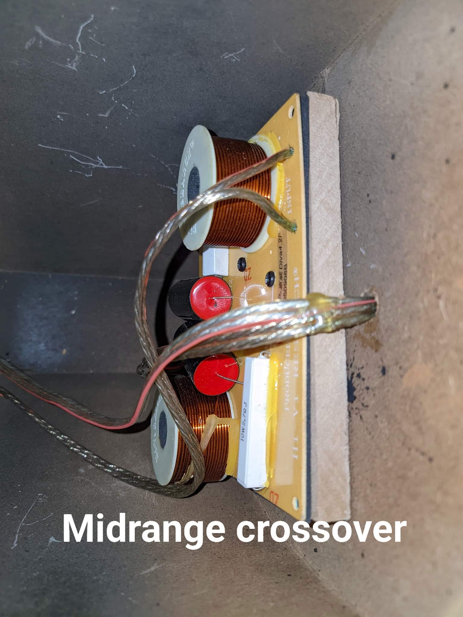

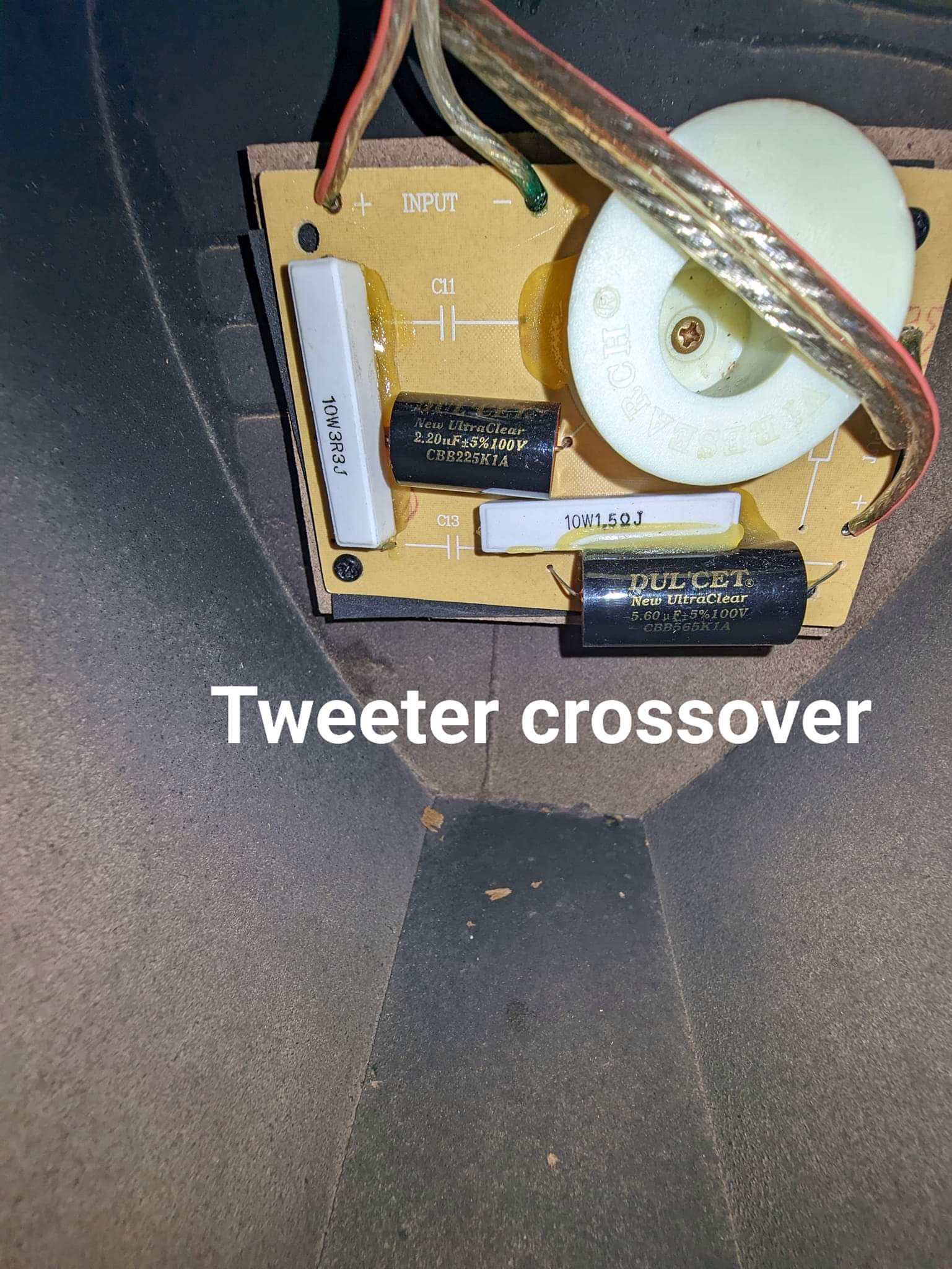

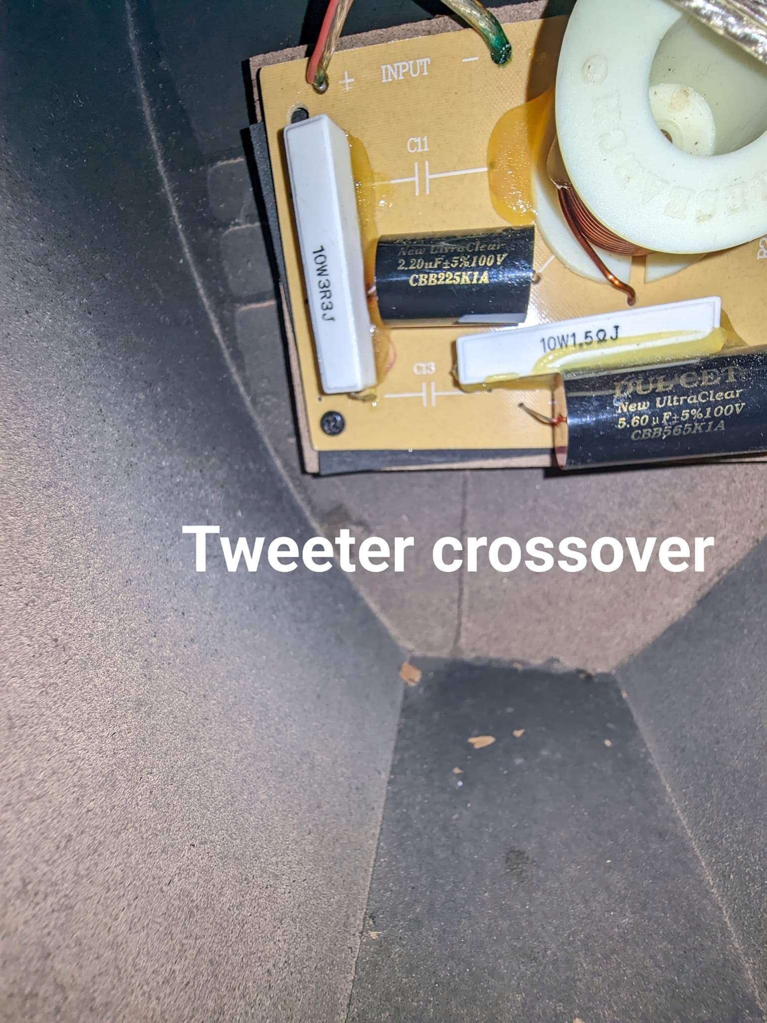

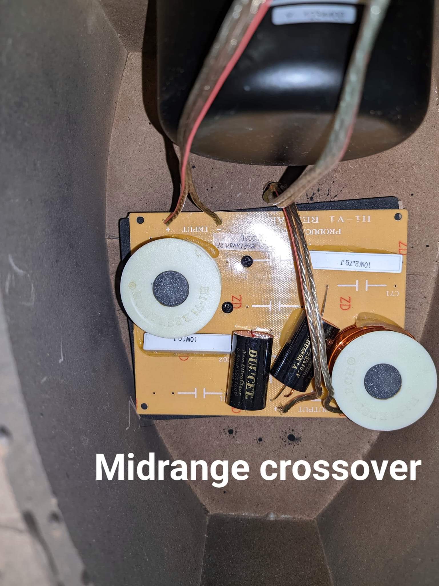

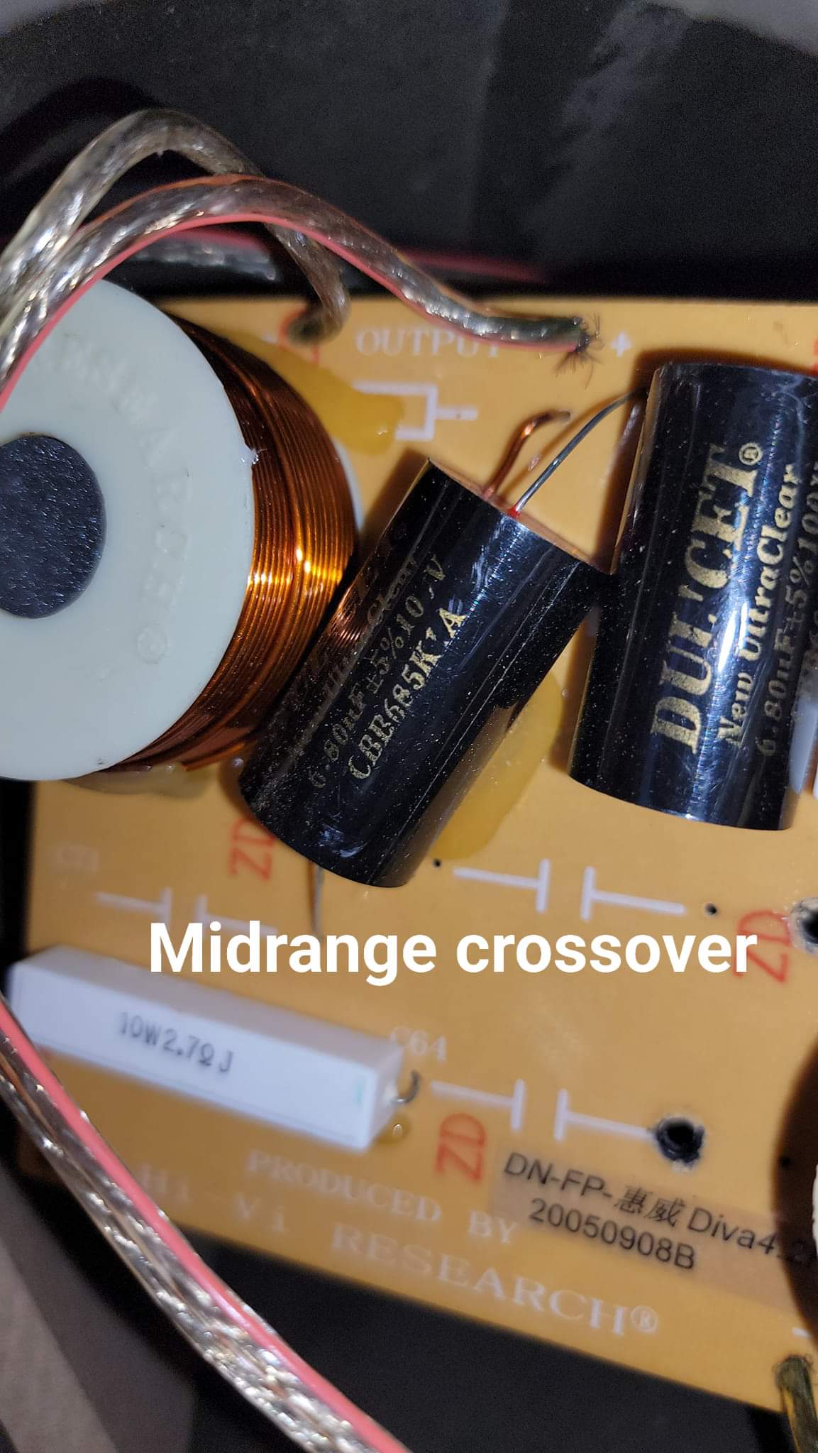

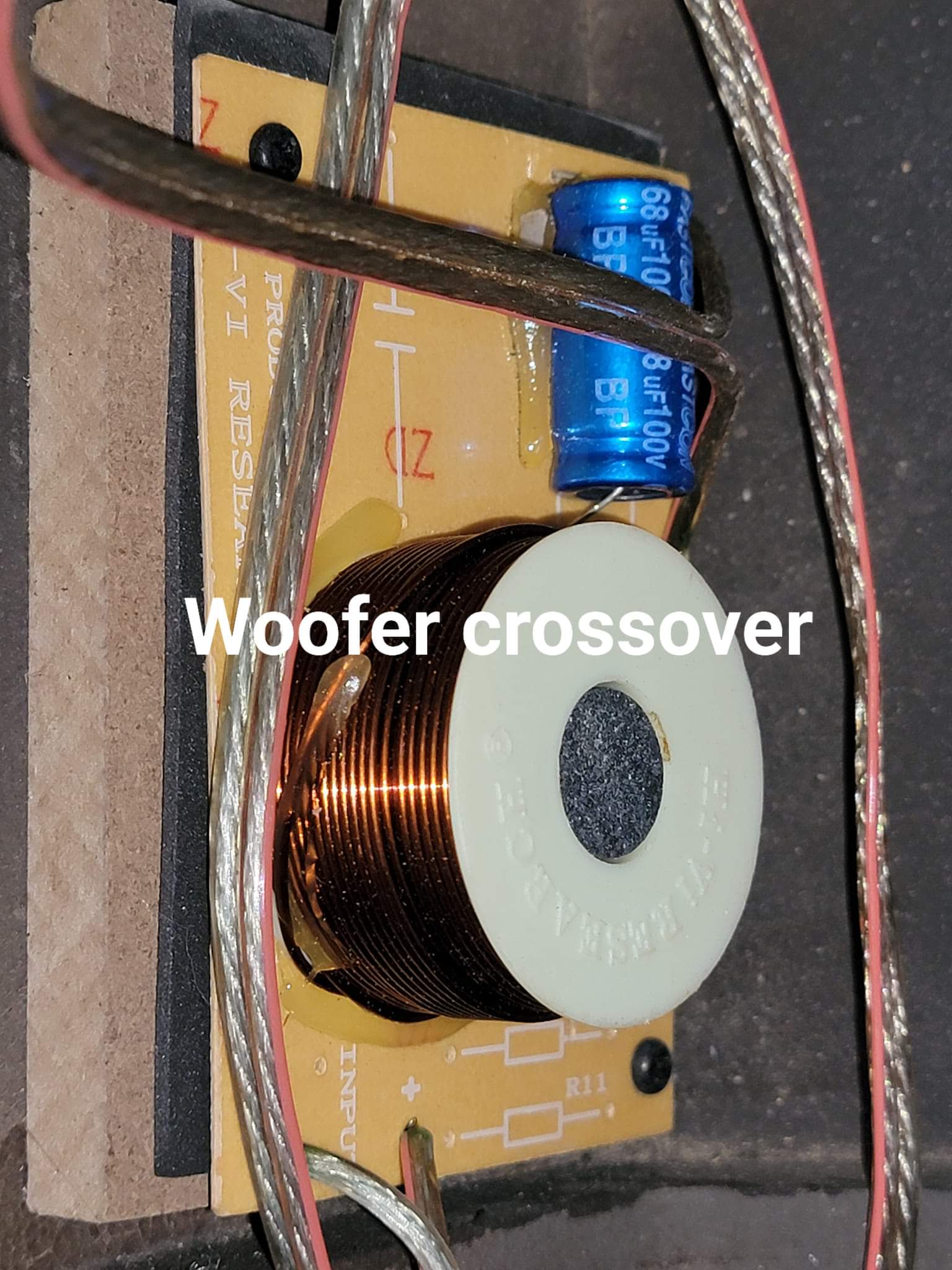

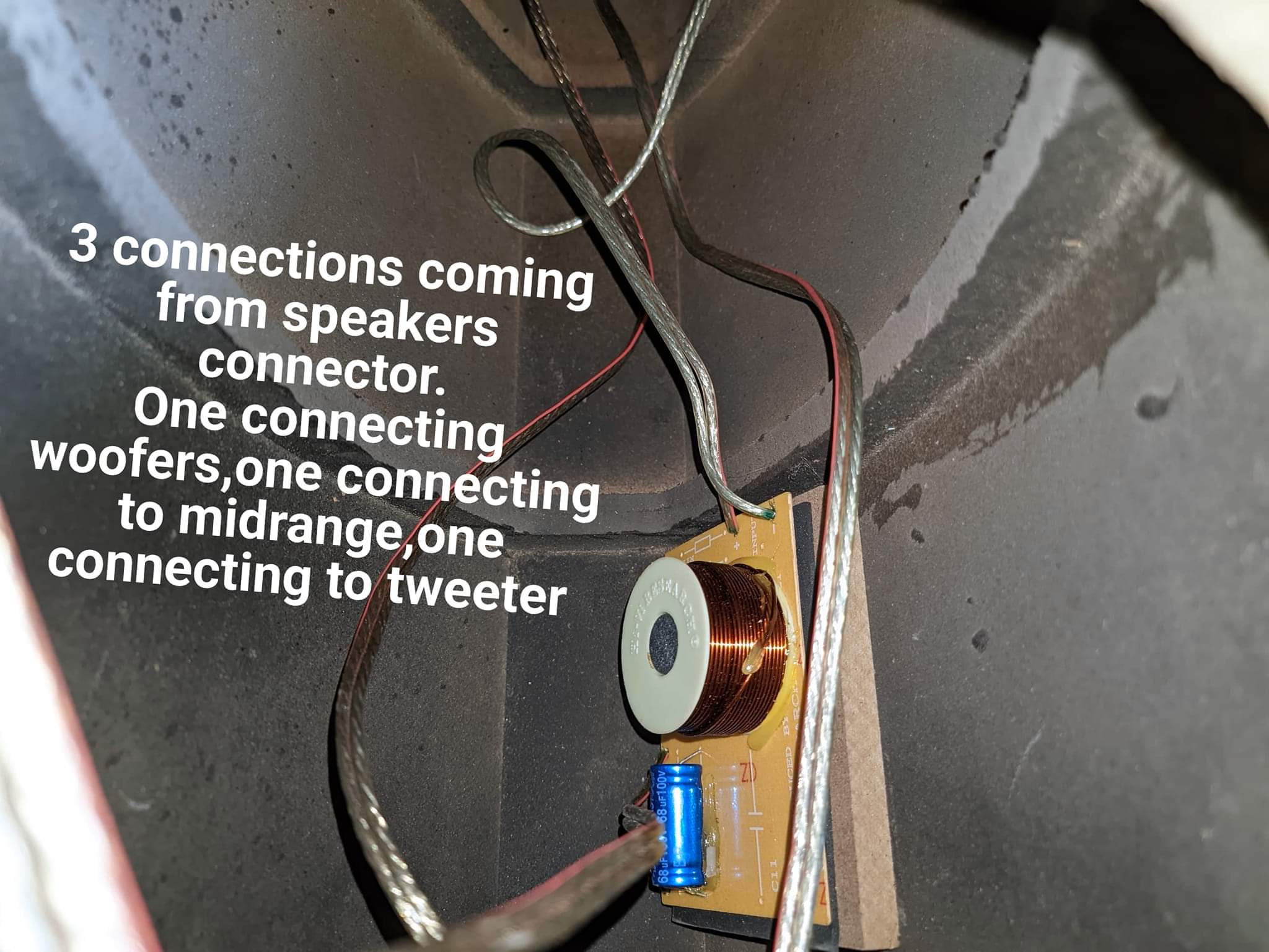

Hi,i have this beautiful set of Hivi Swan 4.2f and i have these for almost 8 years now.i recently decided to upgrade the crossover for these speakers.
What surprised me is it has 3 crossovers inside.
1 crossover in woofer compartment which is driving 2 woofers.
1 crossover in woofer department which is driving 1 midrange unit.
1 crossover in Midrange Compartment which is driving 1 Tweeter Unit.
I would like to know upgrade options,i am also looking to move all crossovers outside the speakers & make sperate box for high-end crossovers.
Attaching images.
Attaching images.

Impressive how those guys use the cheapest components possible...brrrr.
So what is your question ? You see the components, their values. as a starting point go from tweeter, next midrnge and last bass x-over.
For the tweeter i suggest as a cap Miflex KPCU1, similar sound than Duelund Cast for a fraction of the price. Same for the mid.
For the coils, Mundorf foil coils. dont have to be the biggest versions. I tried other producers as well, but cant match the life and holography of Mundorf.
For the resisors...ideally Magnanin or Wirewound...Mundorf has both, but other producers as well.
Yes,these speakers have no quality internals.i imagine how they would sound with decent caps.
How do you compare to Miflex KPCU1 with Mundorf Supreme Evo...
I may or may not replace coils,maybe later.
Coils have no value or marking on them...

I second the Miflex suggestion. I learned about them when I got my Eufonika tube amp which offered them as option. They sound excellent, and many other Eufonika amp owners think so too.
[B]@HiperJZ[/B] Hey Hipper.
Please consider this strategy: Leave the woofer crossover alone. In the mid crossover & the tweeter crossovers, replace the all resistors (white squarish things) use Mills 12w wire-wound of the same value And, replace the of the black capacitors using "Solen Polypropylene Film & Foils" of the same value (voltage rating doesnt matter) the solens can be 100/200/600v, etc) then line the inside of the cabinet with 1/8-1/4 thick felt attached with spray glue or other. Leave the coils alone.
Here are sources for the resistors and capacitors:
https://solen.ca/en/categories/solen-film-foil-polypropylene-caps/productshttps://www.soniccraft.com/index.php/mills-12-watt-c-29_53_63?osCsid=ncqij05mrka5p9n8ftl1ah4ac3
https://www.soniccraft.com/index.ph...-29_419_421?osCsid=ncqij05mrka5p9n8ftl1ah4ac3
https://www.partsconnexion.com/mills-mra-12-resistors.html
https://www.hificollective.co.uk/ might be a good source for you for the resistors.
Forget about the Milflex & Duland copper foil stuff yes they are excellent but you are never going to fit soup-can sized ginormous capacitors inside your cabinet/OEM crossover boards. Go ahead look up of the size/s before you order them. Yes, the the arm chair warriors will tell you to build outboard crossovers but don't, just keep it simple. There are very few Metalized Polypropylene (MKP) or foil type capacitors that will sound marginally better than the solens and they tremendously larger in both size an cost. The solens are a film and foil and they are compact.
Double check your part values when ordering and assembly and enjoy and report back your results. I think you will be very very happy.
PS Your OEM caps aren't that bad you could try just replacing the resistors first if you wanted to be more budget conscious. If solens are too much $$ consider Mundorf EVO Oils, nice but a touch less rich/warm then the solens
