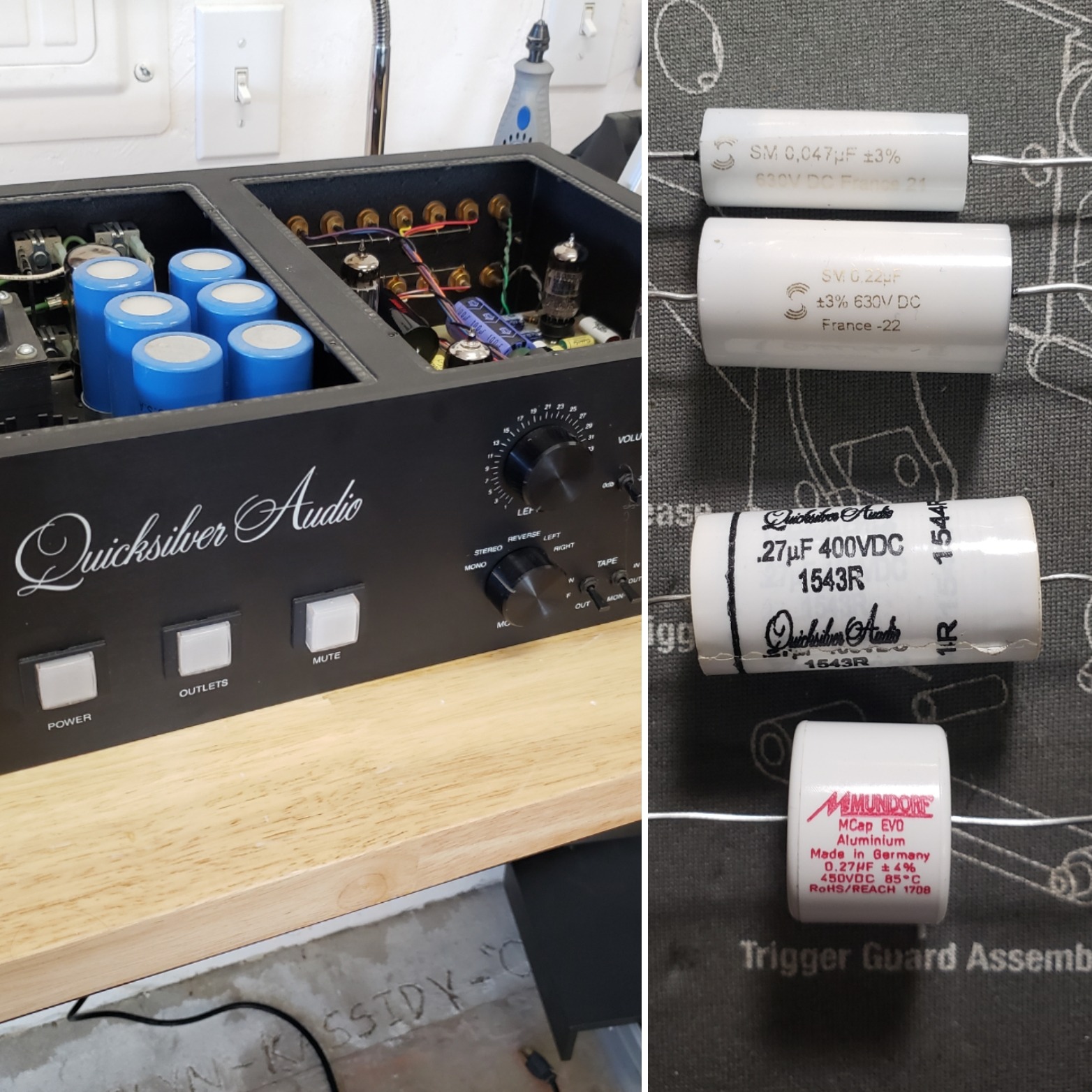

For example here is a pic tube preamp I'm currently upgrading the coupling caps in (along the the Aragon 47k - I often have parallel projects in motion). As you can see: We have a selection of .27uf capacitors. The Solen Tin film & foil (a .047 & .22 combined in parallel to give us the needed .27uf), A Quicksilver audio Aluminum film & Foil, and finally a Mundorf Mcap Aluminum EVO Metalized PP.

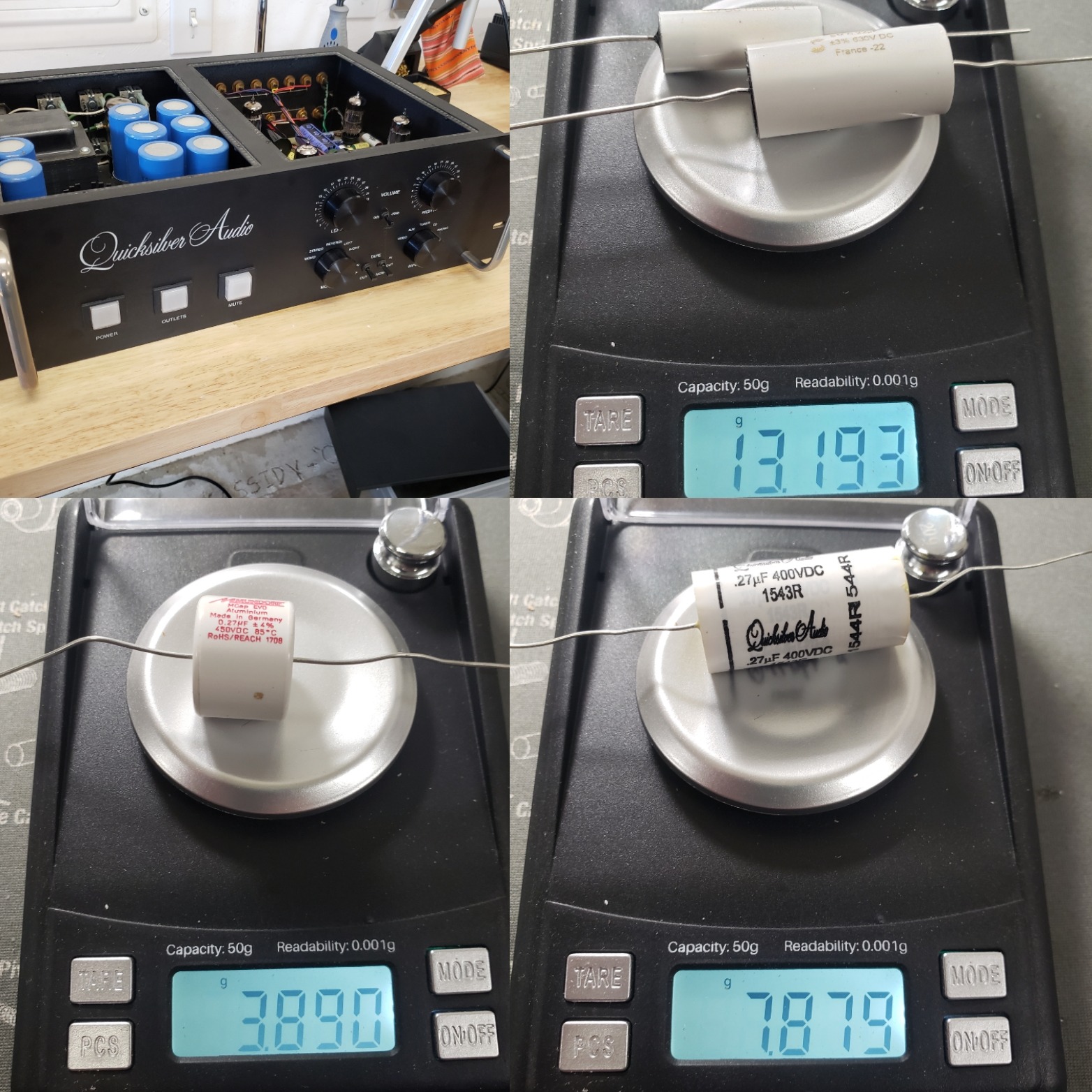

In the following pic you'll observe the differences in weight The Solen SM film and foils at 13.1g, the Quicksilver at 7.8g and finally the Mudorf are the lightest at 3.8g.
Clearly, the heavier caps are better because they are heavier. 😈
Surely that is relative to the mass of the foil element involved? (Assumption here that the foil is the majority of mass).

Gosh. I was totally baiting/trolling the EEs out there with my "pick your capacitors by weight" and other comments. You all awake out there? Forget your vitamins this morning? 😛
