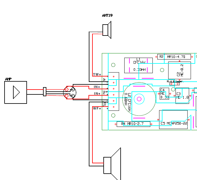

Hi Moovnutz!
I went from a diagram of the board layout which included part values and copper lands. I then reverse engineered the board using that board picture (also from Mundorf) and FRD/ZMA falues from SPLCopy into XSim. I had to guess at the ground locations but pretty much everything else was laid out for me.
If I had made that big a blunder I would have ended up terrible FR and impedance plots. Also, as others (Bill Poster I think) have pointed out, a crossover point of 3450 makes no sense at all with these drivers. I'm curious about who brags about a serial crossover? Most people brag about having a parallel crossover with no serial components, so at the very least there's some language issues in the description.
The Korean site Fullrange has an FR plot which very closely aligns with the simulation, I've updated my blog accordingly.
So, for all those reasons, I think the crossover description was a leftover from either a previous iteration, or cut and pasted from something else, but I could stand to be corrected.

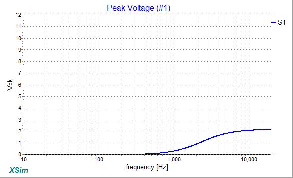

SD, I see what you mean about the tweeter, but your point about the differences between the SS and Accuton in the top of their range is the limiting factor I think. Still, according to my simulation, the lower XO point is quite a good compromise. The FR plot I posted has the tweeter output, let me post the voltage transfer for you. Mundorf recommends this tweeter for 2,800 at 12 dB/octave, so I think pushing it a little down with a third order is still OK, especially with these tweeters. Unlike ribbons, these are pretty robust.

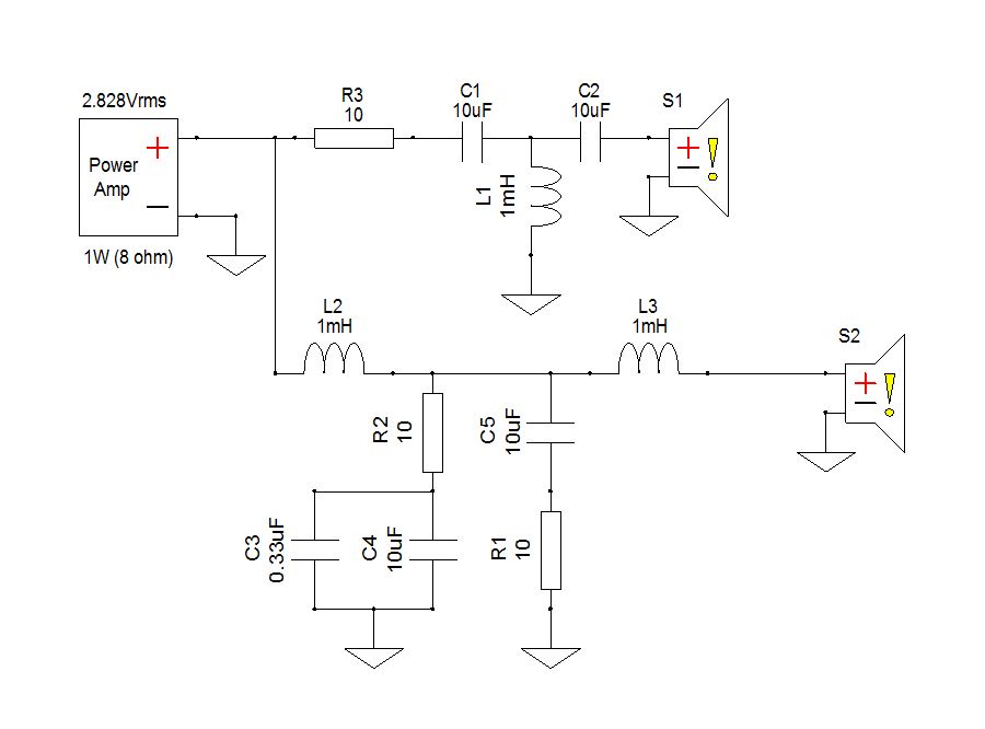

TBH, I thought the Mundorf 2 way crossover was a fairly straightforward low bafflestep second order parallel design. It don't mean a thing without a schematic IMO. Below. 😀
Gadzooks, I have had parallel and serial reversed. 🙂 I got thrown off by Mundorf bragging about having no parallel parts.
Again, I think it's a jerkish thing to post the schematics in full so the values used are the XSim defaults, except 1 cap, just to illustrate it's a small one used to add up capacitance. Like Steve said though, pretty standard stuff. C3/C4/R2 seem to just do a little phase compensation.
