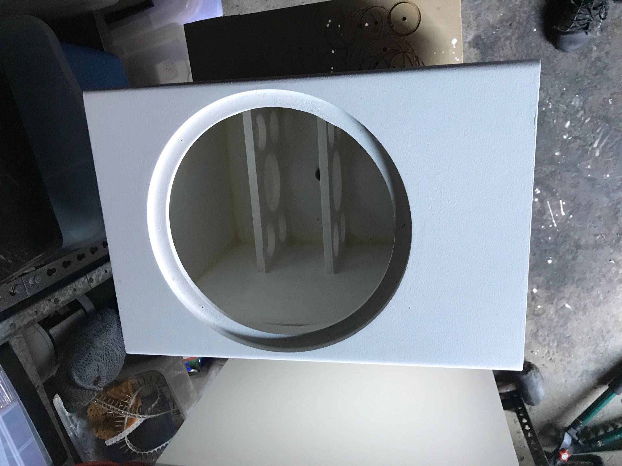

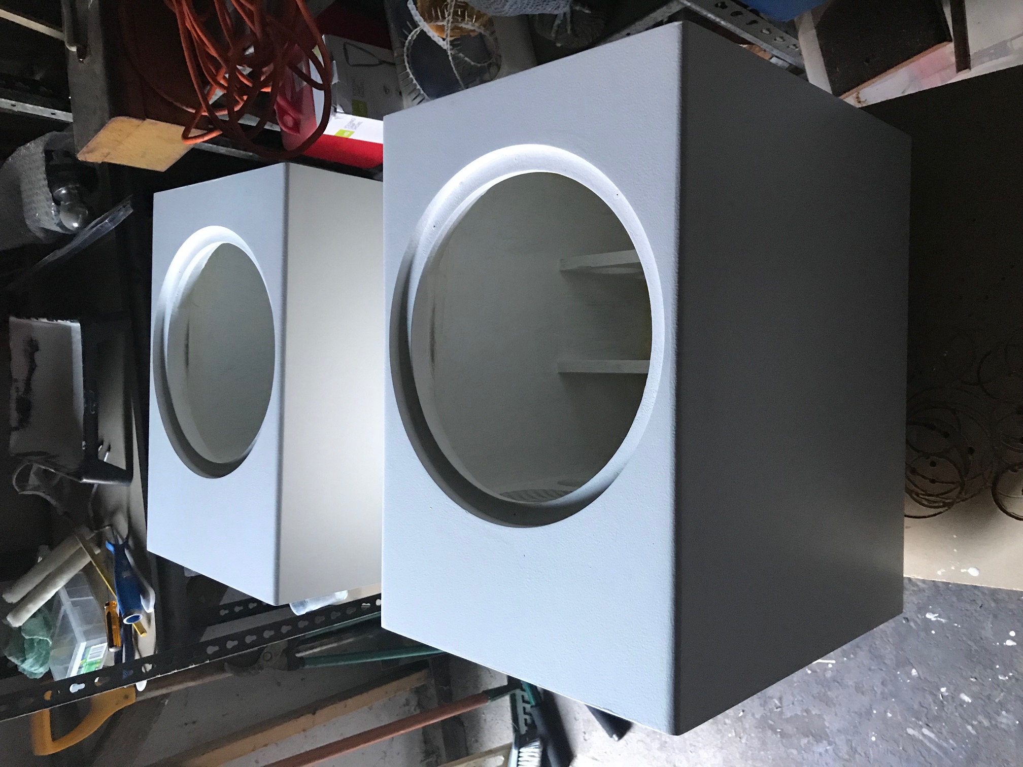

Photos of painting stages. Final coat rolled semi gloss

Haven't heard them yet...Need to modify my amp for the additional channels before I have something to drive them.
i.e. 2 * Hypex UcD400's
On another note, this week I showed the painted subs to my wife? Her only question was "why are there 2"?
I said "Remember how i said I was working on the sub-woofers? That's plural"
That was followed by weird looks...
Shouldn't be too far away in reporting performance results.

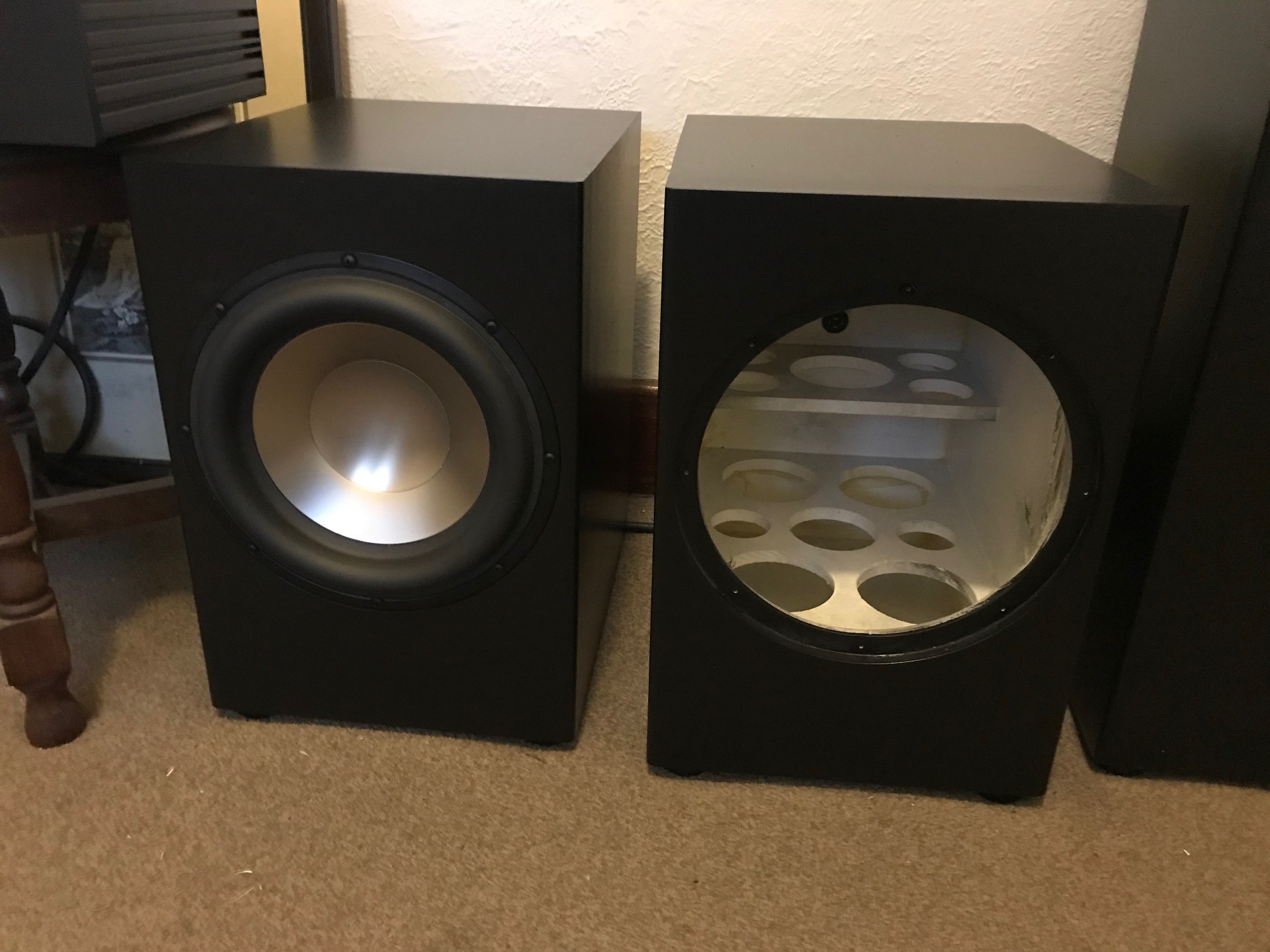

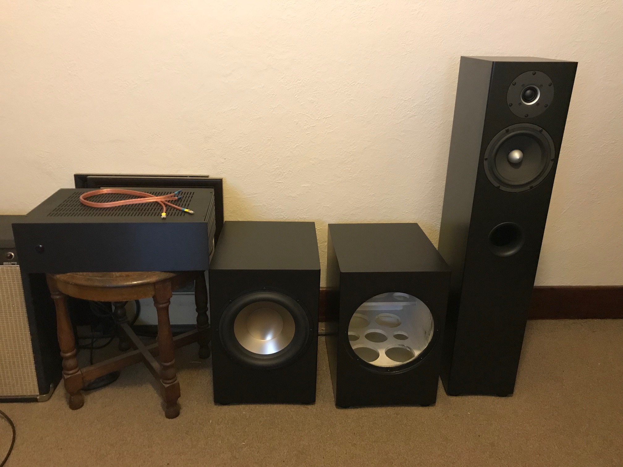

Update for Wright!!!
Have now finished both subs and wired in 1 * UcD400HG module. I'm out of room to lay the 2nd UcD400HG module without re-configuring the layout.
So at this stage running as a 2.1 setup which will have to persist for the minute.
With some qualitative testing, I'm crossing at 200Hz and sound is definitely better. I wont elaborate until i spend time tuning and measuring quantitatively.
Nice that you've got this up and running and glad to hear that it's improving further. I'll be interested to see if you tweak it much after measuring and whether you feel that a second sub adds much further improvement, if and when you end up adding it in. Enjoy the fruits of your labor.
